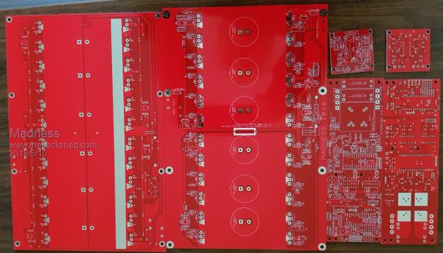

Anyone else wanting to get some PCB's before I end the order?

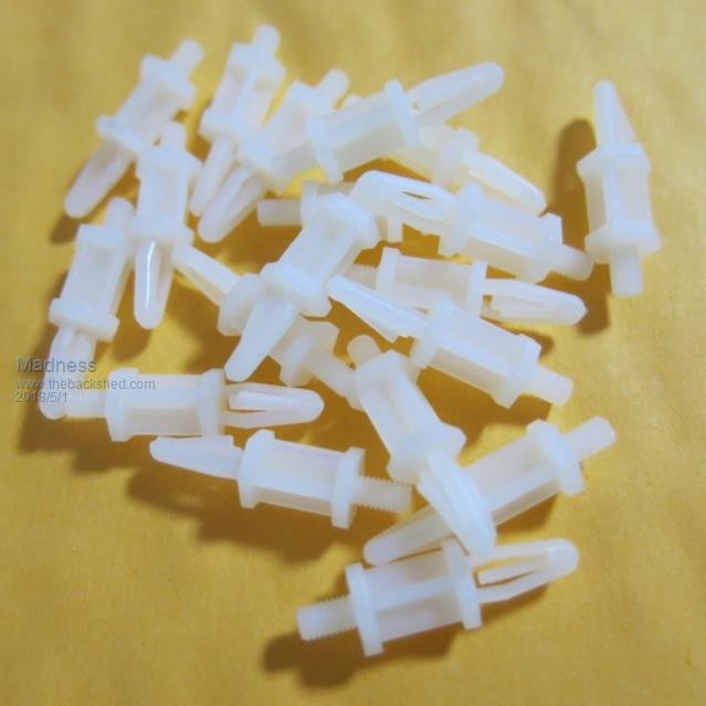

For mounting the control or fan boards I have 4MM holes with the 6.3mm long version of these in mind for mounting.

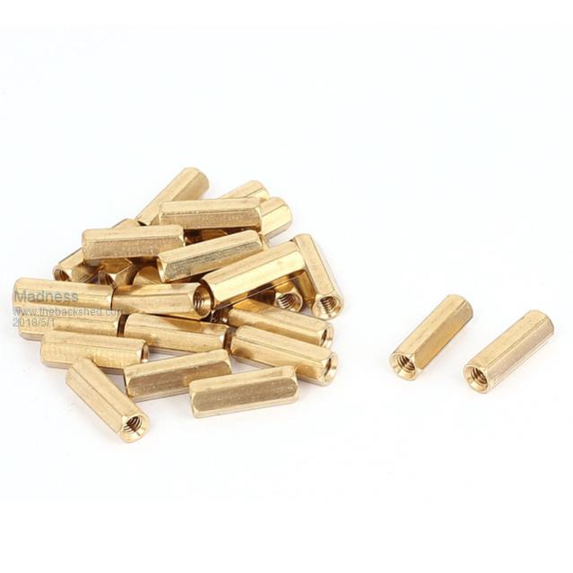

For the Power Board I use 18 MM M4 Brass stand offs.
They allow space for the negative power cable soldered to the back of the PCB. Easy way to do it is use the PCB as a template and drill the 8 4mm holes in the case then screw in the standoffs, then when fitting the power board just screw 10MM M4 screws through the board into the standoffs..

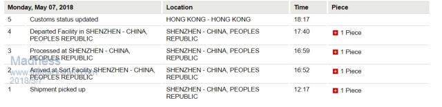

Pcb order has been sent, I have ordered extras if anyone wants some.
Posted: 06:15am 05 May 2018
PCBs have been manufactured and now waiting to be collected by DHL, should be here mid next week.
Posted: 10:43am 07 May 2018
PCBs are on the way.

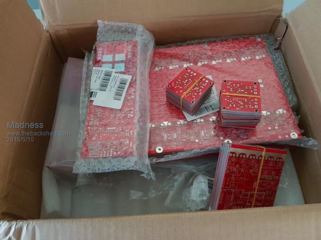

They have arrived, I will get them in the post today for those who have paid.

Posted: 11:31pm 09 May 2018
Just been to the post office to get the Express Satchels, all going well you will have them tomorrow.

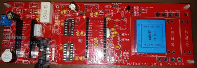

PCBs have been sent via Express Post to everyone except one person who I am waiting to give me their address.
One thing I need to mention is the 7k5 Resistor on the control board needs to be changed to a 3K9 if you are using a 12V transformer. 7K5 is from Oztules original version where he was using a 14V transformer.

Posted: 10:03pm 10 May 2018

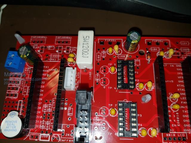

One little issue has come up but no big deal, I had allowed for a larger drop down resistor but the 10 pin connector gets in the way. A 5W 120R fits easily as per below.
