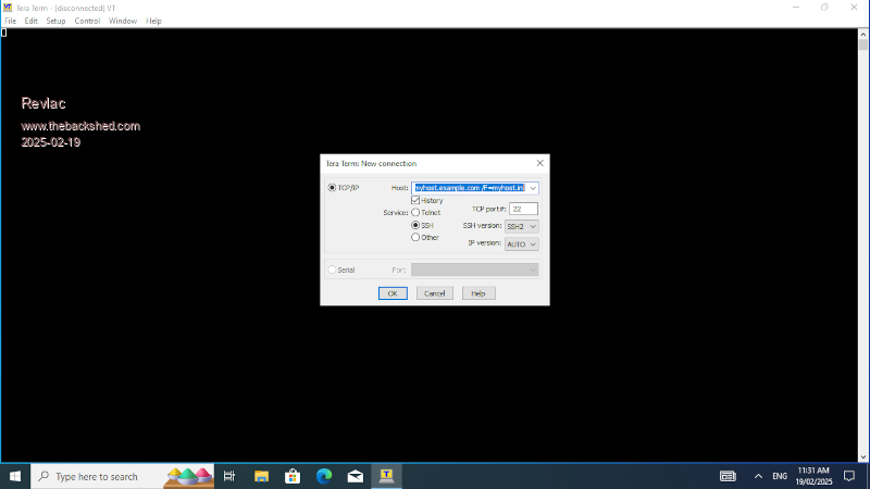

  Quote  now I see the com port is greyed out and not able to be selected
As Arron can't see the USB port (greyed out), it does sounds more like a cable or driver issue.
TeraTerm doesn't care about any Nano bootloader or port speed in order to highlight a valid USB port, that's a port on a separate USB micro controller which is on the Nano board.
The Arduino IDE also shows that port available for selection, regardless of bootloader status and only complains if it can't identify a Nano for whatever reason.
I just confirmed both applications with a Nano and no bootloader.
Revlac
Joined: 31/12/2016
Posts: 1310
Posted: 12:58am 19 Feb 2025

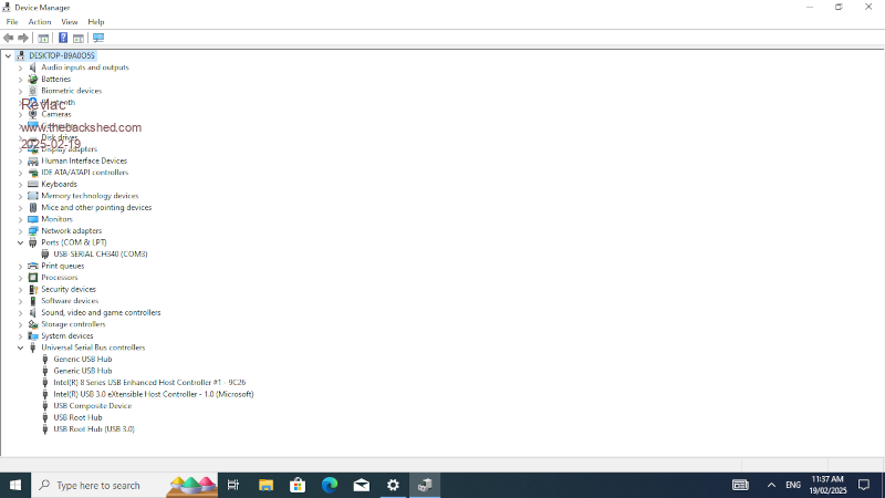

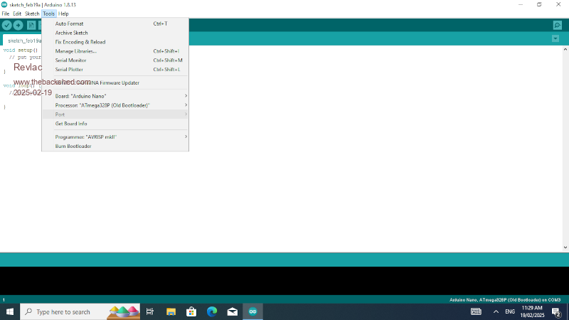

A few screenshots of the ports greyed out.
had a look at settings in Device manager and don't see the ports (com and LPT) listed, failed to notice this earlier, the board is listed down the bottom as USB FT232R usb UART.
So perhaps I still have a Driver problem, serves me right for being half asleep while trying this out last night.
And now a different board and cable, works as it should.
Cheers Aaron

KeepIS
Joined: 13/10/2014
Posts: 2287
Posted: 01:27am 19 Feb 2025
Why have you got TCP/IP ticked?
EDIT: Answered my own question.
Just trying to duplicate what is happening, that option is ticked by default when there are NO system serial ports detected.
If you go to Setup -> Serial port, and you see the Port entry blanked, it again means there are no ports detected by windows, it's the same for the IDE.
However Device Manager Shows USB-SERIAL CH340(COM 3)
EDIT again: Leaving my English comprehension errors in.
I Should read your post correctly, it works when the Port is found in device manager.
It looks like a driver issue if you are using the same USB lead and Hub both times.
I've seen this with some fake CH340 controllers, but I haven't seen it on the 5 different types of low cost Nano boards I use, most are CH340.

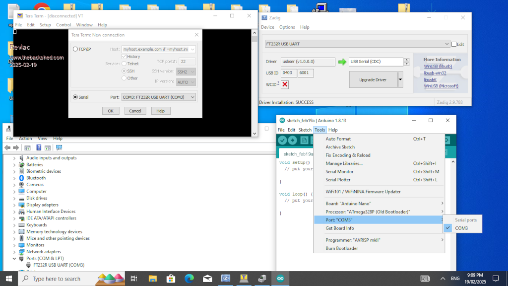

Revlac
Joined: 31/12/2016
Posts: 1310
Posted: 10:42am 19 Feb 2025
A while back the USBasp  AVR Programmer and AveDudess worked a treat on this windows computer, it uses a different USB cable and now it wont show up either, so it seems to be a driver issue, nothing should have changed since last time I set it up.
Anyway not too concerned about it, will figure it out later.
Had another play around with drivers and now it picks up the nano on com3, still not convinced yet, its still getting garbage in the serial monitor even after getting the settings done, some progress perhaps.

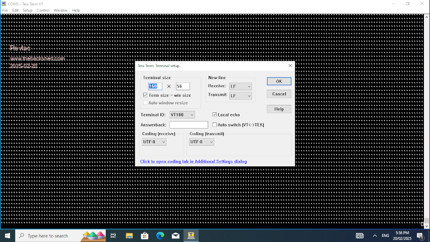

Now the difference between Tera Term and Arduino IDE terminal serial monitor, (for the purpose of changing items on the menu)  Arduino IDE terminal serial monitor will send a command after pressing send or Enter, And Tera Term will send it as you type? so it works better for the menu on the inverter, Am I on the right track thinking this?
I have seen PUTTY but not sure if its useful for this or I could try it as well.

KeepIS
Joined: 13/10/2014
Posts: 2287
Posted: 10:14pm 19 Feb 2025
TeraTerm is a real terminal emulation program, the IDE, from my brief usage, is not a fully functional Terminal emulation and was not designed to be.
Putty should be able to be configured to NOT send a CR as part of a standard line termination sequence, like TeraTerm.
Terminal applications are designed to be configurable for different application interfaces using various line terminating formats along with a multitude of other application interface settings to correctly display and communicate data.
I will say that I've found TeraTerm to be very robust when it comes to handling serial ports.

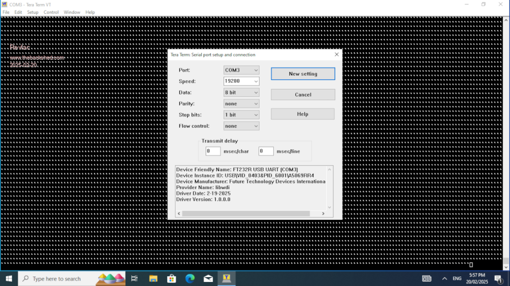

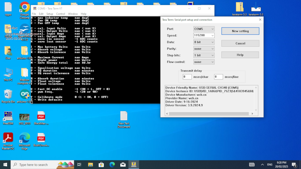

Thought I would try a few different settings and Baud speeds and nothing seems to work with this lot of new nano's, yet somehow 2 of them programmed (inverter and LCD nano's) earlier and worked fine on this windows computer.
A few screenshots, also found the same stuff displayed using the IDE, while it works ok on the other computer running Linux mint and the IDE......
Now I tried an older Nano (has red and green LED"s) and programmed it with the MPPT Code and then checked to see if it would run in the Terminal, and YES it works as it should, so to me that rules out a Terminal problem.
So I'm going to put this down to a driver issue and and some user error etc, Not to be concerned about it I will just use the other Nano's.

Posts: 3421
Posted: 09:23pm 20 Feb 2025
A USB FT232R usb UART is unusual on a Nano so as you said it may be a driver issue.
Can you read the type number on the chip?
To test different drivers use the loopback method mentioned earlier so that you will get a response no matter what port speed is used. When what you type is echoed back you have the right driver.
It is also possible they are non-genuine chips that the driver recognizes as fake and refuses to work with.
In that case you can use an external USB UART connected to Rx and Tx.
If you don't have one use another Nano with the reset pin held low. Its CH340 can then be used via its Rx and Tx cross-connected to Tx and Rx on the dud one. Plus Gnd to Gnd and 5V to 5V.
Revlac
Joined: 31/12/2016
Posts: 1310
Posted: 10:11pm 20 Feb 2025
Pretty much guarantee its a fake, there is no markings on the 16pin chip, and I did just notice the text on the micro is also different to the others.
Still it works on the other computer with Linux mint, Will probably have a go at it some other time, there are many more important things to do, may make a separate post for this one, probably should have before.
