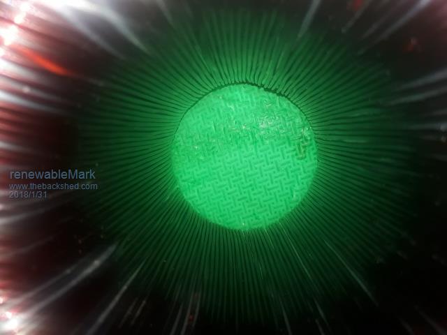

Well the 4th winding went on well, only just fit. It could possibly have slotted one or two more wires in the centre.
IF from the start you anticipated this, you could really really pull super hard and make it really taught and compressed in the centre to gain maybe one or two more mm in ID which would make a big difference when getting to the 4th winding.
Sorry to see you guys getting distressed about the primary winding, anyway when in doubt ask the designer (not to say that's always right, but a good starting point)
Cheers Mark

renewableMark
Joined: 09/12/2017
Posts: 1679
Posted: 09:15am 31 Jan 2018
Here is some inverter porn for the toroid pervert.
Some sections are just on 80mm others 77mm.
I'll do the volt phase test tomorrow and put on a test primary winding.Edited by renewableMark 2018-02-01
