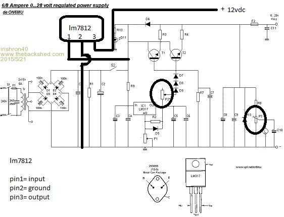

hi . can someone please explane to me which way I connect the trimpot p3
am i correct in thinking at( leg 1 goes to negative)
( leg 2 goes to c10)
(leg 3 goes to r8)
also what is p2? that isnt a trimpot is it?
and do i only use the middle and 1 outer pin on p1?
thanks for being patient with a beginner

Hi Ron,
Interesting circuit. I don't think I've ever seen the bridge rectifier done quite that way.
Anyway, for the trimpot on the far right of the circuit you connect either leg 1 or leg 3 to ground, and then the other pin to R8. The middle pin (leg 2) connects to C10. That allows you to connect the trimpot either way round for ease of access.
P2 looks like its probably a potentiometer (aka pot, or variable resistor). In that circuit I think its controlling the output voltage.
Is the 7812 portion added by you? If your just planning on using it as an extra line for running some small stuff then it might work okay, but you should probably add some output filtering. You won't get 6-8 amps out of it though if that is what you are expecting.

im just a beginner ,but getting hooked lol.
the 7812 i put in to run my 12volt cooling fan and supply to my usb charger which requires a 12v input. thats all i use the 7812 for
it says the following on the page of power supply diagram
P2 47 Ohm or 220 Ohm 1 watt * (be sure you can reach 0 ohms as any resistance limits the current)
I like to know what it is and how to connect it.

Ron
Unless you wish to have adjustable current limiting in your supply you can use a piece of wire instead of P2. If you do use it then it has to take a substantial current which will produce heating. Hence the 1 W (as in Watt or power) rating. If I was building the supply I would connect directly from the OUT leg of the LM317 to the bottom of diode D9. Save money.
I would put a 100nF 16 volt (or 25 volt) capacitor on the output of the 7812 else it may become unstable. It wouldn't hurt to do the same for the input. Put them close to the 7812!

thank you. I indeed like to have current limiting .

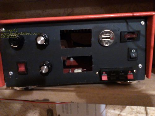

I am after building this casing.
it has main power switch and fuse on the left
2 openings ( 1 for amp meter for current limiting , and 1 opening volt my combined volt ampmeter , as I also like to see what current my load will be drawing)
on right it has a 5vdc output which will accept 12v in.
also a fuse and switch to switch of output temporarily
it has speaker connectors and just have to fit my original bench suppky output fittings.
this is my first project and i do have a lot to learn, but Ill get there.
it says p2 is a varistat. ( what is a varistat?)
and how do i connect that?
you said (Note that I did a correction from P3 to P2 at the top.
) what did you mean?

In the email I got confused between P2 and P3.
The email said piece of wire instead of P3
A varistat is a variable resistor. Like a trimpot only larger.
Variable resistors can be called varistat, rheostat, potentiometer, trimpot, trimmer, and I have probably missed one or more out.
The differences are usage and physical construction. Read the link on resistors and then in the Potentiometers section follow the link to Potentiometers.

so looking at that diagram
Is my understanding right that that is the potentiometer on front panel for current limiting? and is it only connected by the middle and one side pin?
I read also somewhere that you should shorten the 3 pin with the middle pin. is this correct?
thank you.
[/quote]
It could be on the front panel if you want adjustable current limiting. yes, that is the connection.
[quote]I read also somewhere that you should shorten the 3 pin with the middle pin. is this correct?[/quote]
No, the term is SHORT not shorten. Short in electrical terms is short for short circuit. Get your brain around that. A short circuit is a direct connection between two points but more usually it is used to refer to an incorrect (unwanted or bad) connection between the positive and negative of a supply or between the active and neutral.
It means here that the 3 pin can be joined to the middle pin and is OK.

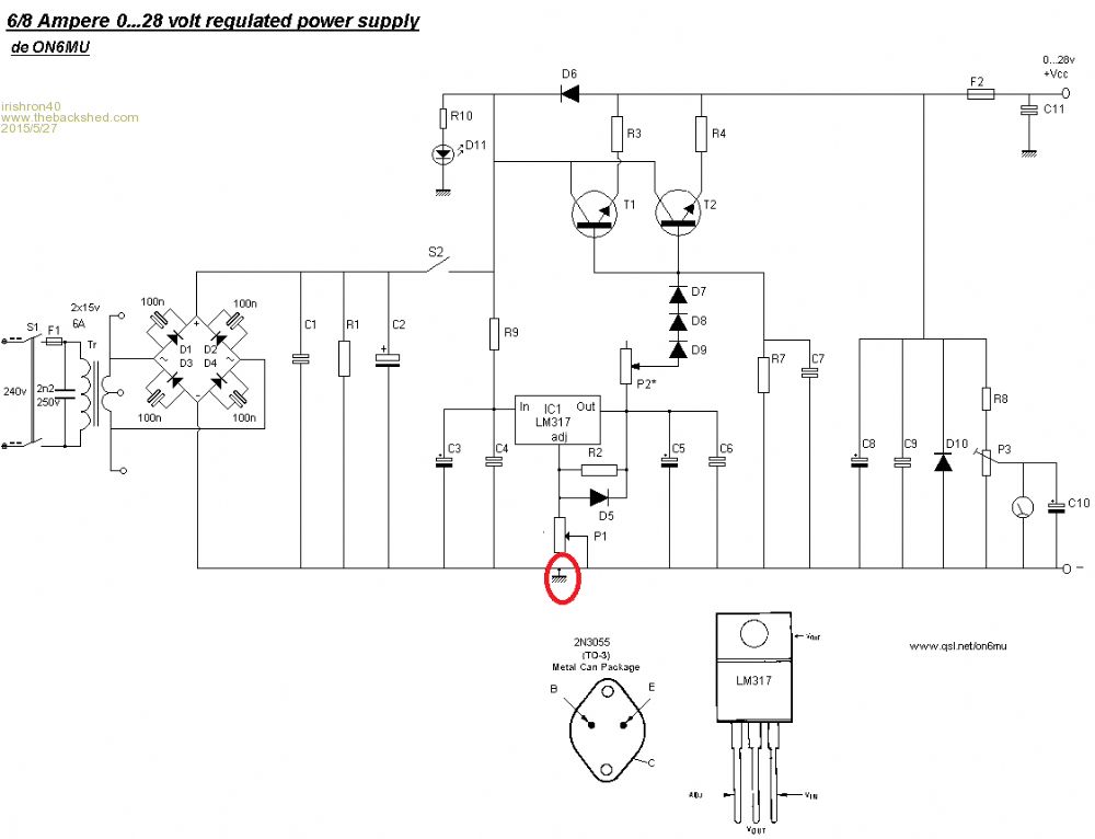

just have 3 questions to finish my project.
1
in attached file I have a red circle around a neg connection. why is this illustrated? isnt it a negative connection anyway ?
2
P1 shows middle and outer leg connected. what do I do with other outer leg of potentiometer
3
C8 is a 330uF/50v
I dont have 330. how important is this vallue in this location?
thanks.
ron
Posted: 01:32pm 25 May 2015
1. Its connected to the chassis. Not necessary, but note C11 and D11 are also connected to chassis, so these will need to be connected to the -ve rail.
2. Nothing.
3. Its the output filter cap, so you can use anything between say 220 and 470 without any affect.

Posted: 05:20pm 26 May 2015
I connected it up and had a slight buzzing sound as if there is a short circuit.
but no voltage on output
I did disconnect the tip3055and buzzing was gone.
checked voltage with multimeter . I have voltage coming in and out of lm317 and can regulate voltage also. I also have voltage at D7
so I hav no positve on output and also no postive on the connection for voltmeter
I tried different tip3055 but still no output.
left pin 3055 I connected to base ( comming from D7)
Middle pin to power in from switch S2
and right pin to 10watt resistor with then is connected to positive output line.
what am I doing wrong??
thx
ron
thx
Posted: 05:35pm 26 May 2015
Dont know. Time to fault find. With the power transistors removed, connect the output of D7 to the output fuse, and see if the volt meter then reads anything? I suspect there is a short somewhere in the output circuitry.

Posted: 06:53pm 26 May 2015
Sounds like a short on the output somewhere. Check D10 is facing the correct way. Start removing parts of the circuit until it works, suspect anything after the transistors, look for shorted PCB tracks.

Posted: 12:44am 27 May 2015
voltage into lm317 is 17.49v
output of lm317 is 16.18v
because of voltage drop from D7,D8,D9 i have at fuse F2
14.2 volt
at D10 i read 14.2
but at between R8 and P3 ,I only read 6 volts.
I double checked and i did use a 10 K at R8
Im lost. could the resistor R8 be faulty?
cheers
ron
BobD
Joined: 07/12/2011
Posts: 935
Posted: 03:27am 27 May 2015
Ron
The voltage at R8 P3 is OK. R8 and P3 are both 10K ohms each so the voltage between should be approximately half of D10 reading. Since part P3 resistance is modified lower by the parallel resistance of the meter then that should cause the voltage at R8-P3 to be a little lower than half of 14.2. 6 volts is probably exactly correct.
Just a check on the fuse, what is the voltage at C11?
It should read about 14.2 volts also.
If that is OK then the circuit as it stands is working OK.
All you have to do is then put those big transistors back in circuit.
