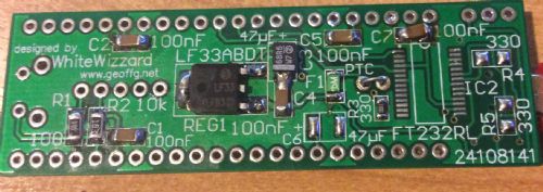

here's a photo.
Yes, C7 is pretty crappy but I swear it looks ok under magnification.
The regulator has the markings LF33 GKLFB323. It looks damaged on the left side but that is just flux. looks ok now i've wiped it.
and yes, I've put a bridge wire in, instead of the normal jumper at this point.

Posts: 2998
Posted: 11:23pm 07 May 2015
First observation is that the47uF cap across the vReg is the wrong way round (or at least I believe it is).
On SMD caps, it is normally the +ve side that is marked (in this case with the white line). This is the opposite method of 'assumed' marking to through-hole caps where the -ve lead is marked.
Anyway, that said it shouldn't make a difference but is worth trying briefly . . .
Let me look more at the photo and get back to you with anything else
(Yep I'm WW)
Posts: 2998
Posted: 11:25pm 07 May 2015
If you are mid way through turning the cap around then please LEAVE THE CAP OFF first and quickly measure the voltage on the 3v3 output again (this eliminates any soldering issue around this cap (providing you clean the SMD solder pads first))
TWO MORE OBSERVATIONS/POINTS:
1> Have you got a good solder connection on the vReg on the 'big' GND pin on the left hand side (and not just on the two pins on the right hand side). Your photo shows it is soldered but it needs to be a good join (as this is GND for the whole circuit).
2> Is there anything in the PTC space? It looks like there is solder there but no component - I know you have made reference to the PTCs on both modules - I just need to be clear on what you have on the module in the photo.
If you have a high-res (i.e. larger) photo then please feel free to email me - it will give me a better view than possibly the posted photo (phil.boyce@micromite.org)

  Quote  On SMD caps, it is normally the +ve side that is marked (in this case with the white line). This is the opposite method of 'assumed' marking to through-hole caps where the -ve lead is marked.
OMG, who came up with that scheme....
and BINGO, that was the problem exactly.

I think that there is a 3v3 Regulator on the underside of the PCB, What part Number is it? I think by looking at the track layout it should be MCP1825S or MCP1826S... If you put an LM1117 instead the pinout is different..

Posted: 11:34pm 07 May 2015
yes, the ptc is installed on that photo (its green on green).
Yes, pretty sure there is a great join on the regulator, I tinned the big pad first so it should be a big thermal join

Posts: 2984
Posted: 11:48pm 07 May 2015
Yes,
That Cap IS backwards.. I was writing when the picture of your board came in.. If you zip the photo and upload it it we can then get a better quality picture of your board.
It looks like you have the correct VReg installed but I cant quite read the number on it.
I cannot see anything else of concern..
