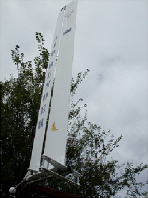

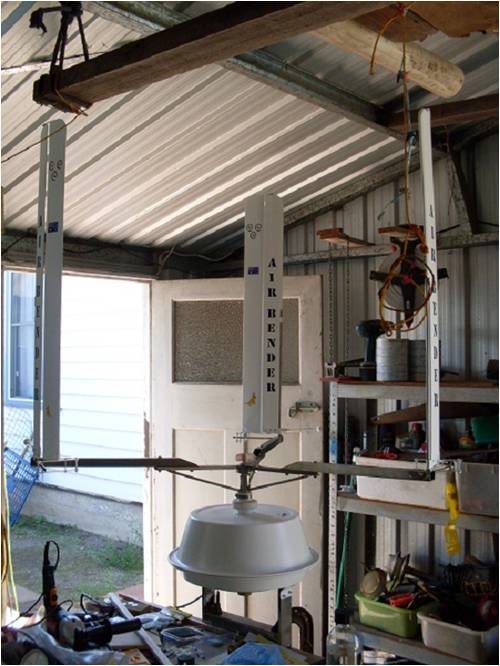

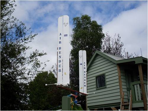

I have been experementing with vawt blades on a free spinning rotor in the back yard for the last 6 months, haveing followed the development of sailing boat wings over the years I went down this path. The last set of blades i built are called 2 element blades which clearly out performed the single element blades both on revs and low wind start up speed.if any one is unclear on multi element wings they can look up the latest on the americas cup,sorry i havnt added links as this is the first post i have ever entered into a forum. Multi element wings are used on F1 spoilers as they give the most down force for the least drag. So now its time to add a a load to the blades, thats how i discovered this site while looking for generators. I droped into my local washing machine repairer who i discovered is a reader of this site, so i scored a freeby F/P. A new rotor has been built and it is attached to the F/P which i have decogged, I have retifiers and am building an electrical box and a 5 meter piviting tower, when that is finnished I plan to put it up in the air with the sandard stator, keep a daily log on the DC volts it is puting out over a period of time for the wind conditions i have. Hopefully from this I will be able to work out which way to rewire the stator. I will take some pictures and try to post them if any one is interested but that might be be more complicated to me than rewiring the stator.

How big is the VAWT, height and width. Just want to see if you have enough area to drive a F&P. VAWT's need to be a bit bigger than a HAWT to drive a F&P.

Blades are one meter high and diamiter of the rotor is 1.5 meters this is ajustable. The new mill will be running with 3 blades as the old test rig i have only runs two which gives a very pulsating rotation but it has been Quicker and cheaper building only two. Increasing blade size is not a problem as this is were my main interest lies. i am trying set it up so i can change blades easly and quickly. i have made headway in geting some pictures up i have managed to downsize the picsels but i ran out of time, had to go to work 12 hour night shift.

It's a bit small to drive a F&P effectively, you would need something closer to 2 meters high by 2 meters wide to get any real power from a F&P. But it will give you a chance to experiment. I did play around with a Lenz 2 vertical and F&P, was good for about 40 watts max, it was 1.2 high and 1.3 wide, so I would expect around the same from yours driving a F&P.
You would have better output if you built a axial flux alternator to suit from scratch, maybe something to consider further down the track. The F&P will get you started and experimenting anyway. Like Karl says, watch out for those voltages, it can kill if you dont pay attention.

OK Dean, here's what would worry me about your interesting project. The wings appear only supported at the bottom, what would the centrifugal force do to the tips should they rotate at high speed? If they flex evenly fine but should one flex more than the others then you get unbalance which can be very destructive.
Its hard to see from the pictures how rigid your build is. There was an interesting thread here a while ago with calculations just how large centrifugal forces are on rotating wings.

Thanks Tinker and AMACK the point you have brought is the one that i have thought about most from the start. To me it is highly desirable to keep the inside clear so the lee blade gets clear wind. Also hy approach to keeping centrifical force down is to keep every thing above the rotor light my blades only weigh arond 380 g with most of this weight at the bottom. During testing in a couple of strong winds i had a failure at the centre pivit point of the cross arm. I have beefed this up a bit in my three blade set up and also hope that the smoother rotarion of the three blades will help. I have not tryed to calculacte the centrifical force on the blade as to do this i would have to break down the break down the weight distribution from the top of the blade to the bottom, i am very much working with guestamation here.

As commented by others certainly a weak point is whats going to happen when you get over 100 rpm on that design.
I have seen a similar design before where the counter weight ensures that you blades are always facing in the optimal direction wrt the on coming wind (Angle of Attack). Its an interesting design, although possibly a tricky one to master.

I have tossed around the idear of adding bracing into the rig, especialy as i look at other vawt designs. But then i think that every time i add a brace i add two extra stress pionts to worry about. But this may be inevitable down the track.
The counter weight was added when the centrifical force started messing up my blade angles. i have built quite a bit of ajustment into this area and i hope to simplify it as i start to get it worked out.

Thank you for your concerns on the weakness on the point where the blades attach to the rotor. I think the greed for performance took over my better judgment in building here. So I will definatly be adding some 45 deg bracing in before i put it up.
I have also been tossing up a couple of other ideas. They are to add a hinge something along the lines you guys use on the tails of your HAWTs. And to have the hinge where the blade attaches to the rotor, so in strong winds the blade hinges outwards, but i am unsure about the efect this will have on the balance when one blade pivots out first. This would definetly have an efect on the horizontol balance but should not effect the vertical balance, i may be wrong here. My second idea is to have a hinge some where along the rotor arm and have half or more of the arm hinging down. this would have the heavyer weight of the arm moving inwards with the lighter weight of the blade tip moving out, hopfully keeping the balance
My main concerns with both these ideas is that i am adding three more moving parts and they will move on every rotation of the mill in strong winds. The leeward blade has centrificl force pushing it out with the wind helping. While the windward blade has the wind pushing against the centrifical force, So it will hinge down as it rotates to leeward and come back up as it rotates to windward. And this movement may have in a slamming effect as the blade comes back up.
