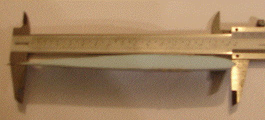

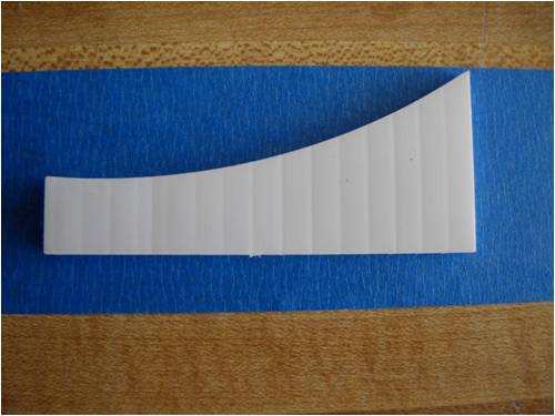

As many of you already know, I make my blades out of a plastic sigh material called Coroflute. In the USA, it's called Cloroplast; same stuff. It's basically the same as corrugated cardboard only it's made from very tough plastic.

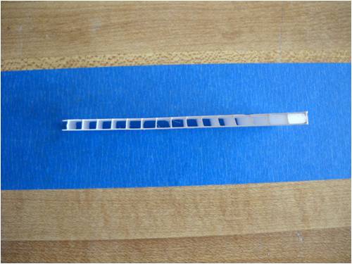

This is a small piece of the stuff. I'm using the blue tape as a background
so you can better see how it's made.
Here it is stand on its end. See the little ribs? This is 4mm Coroflute.
I use 2mm as do many who build and fly R/C gliders and sail planes. In fact, I'll be building a new plane for myself out of it soon. The plane will feature an 8-foot wing span with one dihedral. The wings will bolt to the welded aluminum fuselage, which will also house the electric motor (for days without thermals), speed control, radio receiver, flight as well as power-assist batteries, servos and anything else I've forgotten. It will use "wingerons" which are merely ailerons (a little flap along the trailing edge of each wing) and a "mixing" radio. With only two servos, it'll go up, down, left, right, roll, etc.
Anyway, back to the Coroflute. What I'll do here is post pictures and a running tutorial telling anyone who wants to build their blades the same way I do exactly how I do it. I took pictures all the way through an entire build.

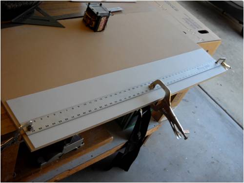

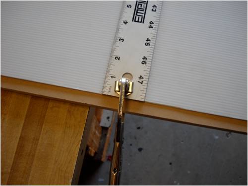

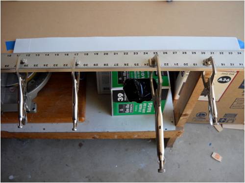

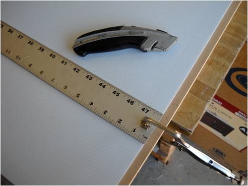

I use a 2' by 4' piece of "MDF" as a cutting and laying-out surface. The
Coroflute is held in place using a metal ruler and a vice-grip clamp.
This stuff is really slippery, so you have to make sure it's down tight
before you draw on, cut or glue it; really important, even crucial step.

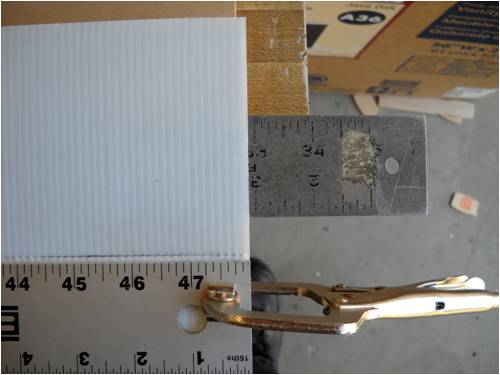

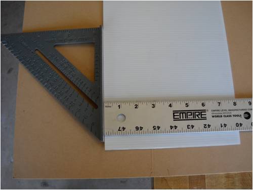

Accurate measurement means starting in the same place each time. I use a
flat surface (carpenter's square here) on one side and I butt both the work and
the ruler against the same vertical surface to make sure each is equally places.
This shows a sheet of Coroflute cut into a square, which is 8" wide parallel to
the plastic ribs
and 48" long. It will make two 4" x 24" blades when it's done.

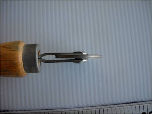

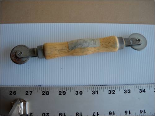

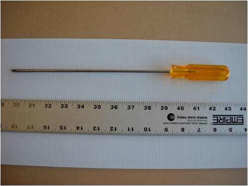

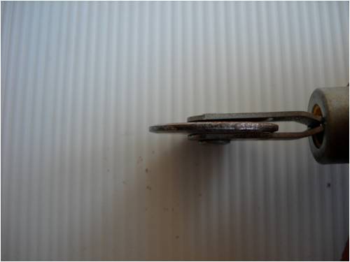

The yellow-handled screwdriver is what everyone else uses to crush the coroflute.
I do it another (easier!) way:
This is what I use. It's the little tool you use to shove the rubber welt into the slot
when you re-screen an aluminum window screen. Note it has two ends. We use the
rounded end
and not the grooved end.
This is the end we use and all it's used for is to "crush" one side of the coroflute so
it will fold easily along the line. More on that later.
Look closely and you'll see a little valley between the two sides of the wheel.
This makes two little "knife" surfaces, which will cut the coroflute.
We don't want to cut it, just mash it. Use the other end!

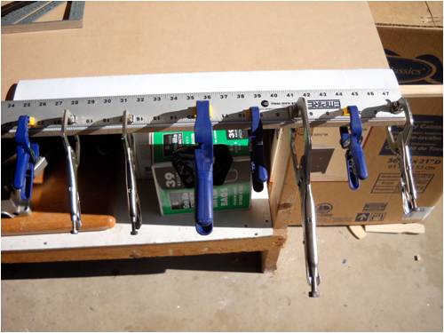

Note here that there is a metal ruler on EACH side of the coroflute.
I did this to show that there needs to be a large flat surface on the back
side of the fold or you'll "crinkle" the fold and that's not part of the plan!

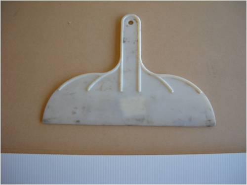

Here's what I use instead. It's a plastic drywall applicator (less than $1 @
Home Depot). It spreads the bending force over more surface area than
if you were to use merely your hands.
The next few pictures show how to lay things out prior to making the folds. Pay strict attention that your work is always clamped to the work table. If it slips, you start over; it's that simple. No room for errors with this stuff!

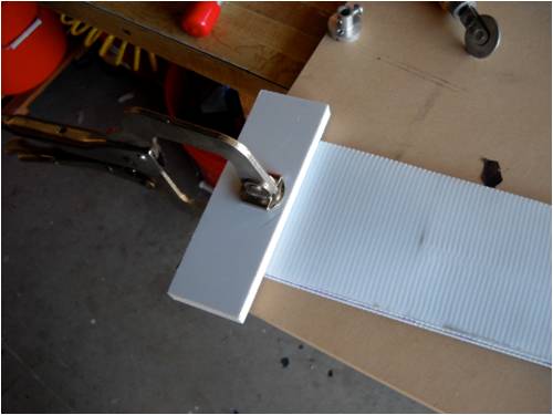

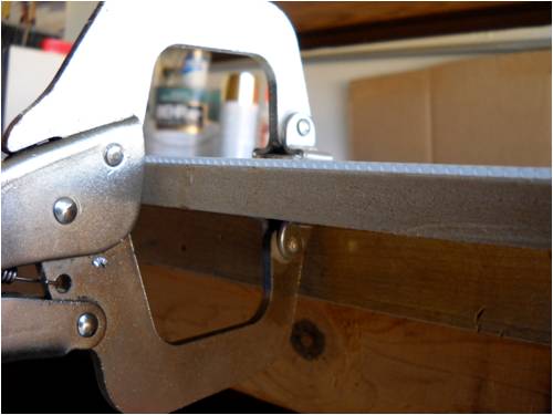

This is an end-view of a locking clamp securing the work to the table.
There is a metal ruler on top of the coroflute, then the plastic sheet,
then the work table and the clamp sandwiches it all and holds everyone's
place.

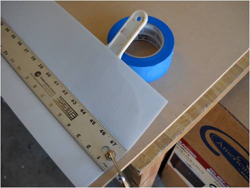

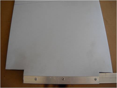

This shows a sheet of creased coroflute plastic just prior to its being folded.
I've begun the fold and am using a roll of blue tape to hold up the handle
on the plastic drywall knife so I can take a picture of the whole shebang.

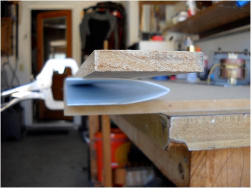

This shows a flat piece of wall-trim board clamping a 4-foot blade section.

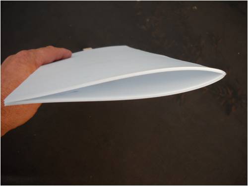

Here's where we're headed; a nearly-perfect symmetrical-section blade!

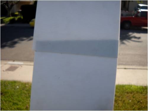

Even though you may think you were born with calibrated eye balls, always
use the proper tool to mark your cuts. This shows how to mark where a
blade spar will be cut. The blades are 24" long and the spar is the same
length, but 4" of the spar sticks out at the "root" end of the blade. This
gives us something to attach it to the windmill hub as well as makes it
easier to glue-shut and trim the blade tips (more later on).

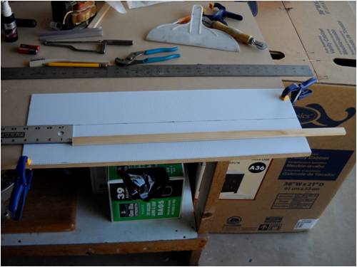

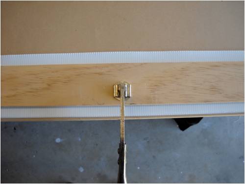

This shows laying-out and positioning of the blade spar. It is centered
and is 24" long, but sticks out the root 4" and is 4" shy of the outboard
end (tip) of the blade. Glue it in place using clamps before you fold the
other side over and glue it in place.
This is a close-up of the spar layout. Go slowly and make everything nice.

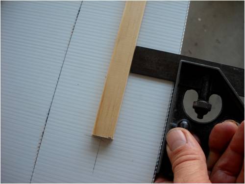

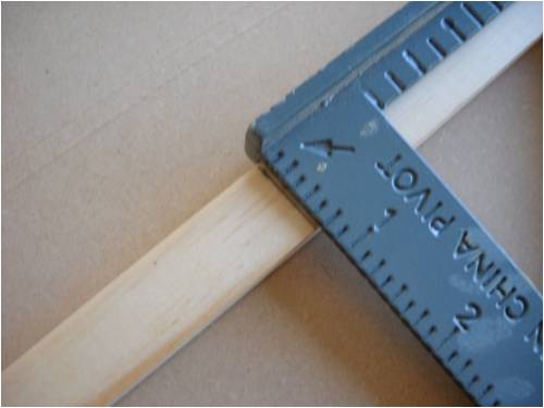

Here's a little trick I use to make sure the spar is parallel to the edge. I
set my square to the exact measurement, then use it to check the other
end. Don't glue things until you've placed them and marked them with
a pencil while they are clamped in position. Doing this, all you then have
to do is dribble the glue down the marked out area and use the same

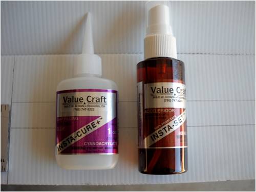

This shows the glue. The one on the left is "Gap-Filling" (thick-ish) CA
while the tall bottle is "Kicker". The CA achieves full strength in 2 hours,
but if you spray it with the kicker, it hardens immediately. It's not
always possible to spray the glued area with kicker; it's used mostly on
edge and exposed seem glue joints.

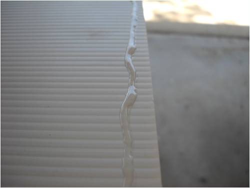

This shows a little trickle of glue before the opposing half of the blade
is mashed together. Nothing fancy!

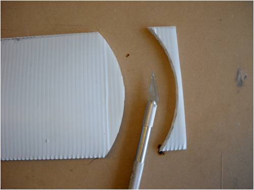

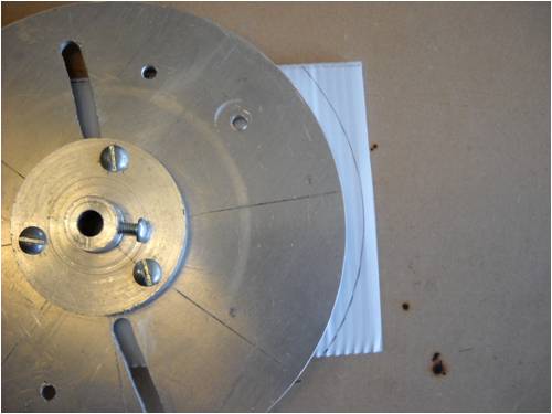

Once the glue cures at the wing tip, find a suitable radius to use as a
cutting template (I used my faceplate) and first trace the cut with a
pencil, then clamp the form in place and use an exacto knife or razor
blade to trim off the end.
Here's that tip cut off and that's the exacto knife in the middle.

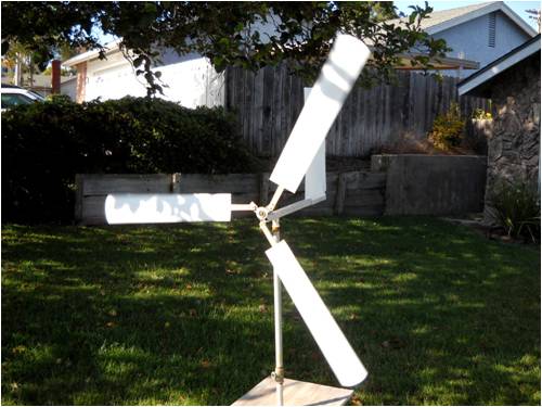

Finished project: Here is is on the test stand spinning around in my
front yard further convincing my neighbors the guy next door is a
nut case!

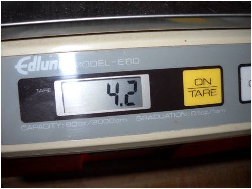

Oops! Almost forgot to show you how much one blade weighs:
That's 4.2 ounces for a 4" x 24" blade with spar. Due to different
wood densities, the 3 blades weiged 4.1, 4.2 and 4.3 ounces.

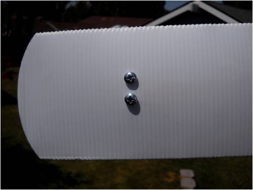

Just so you know, Saturday was my 61st birthday and I told everyone what I wanted most of all was to be left alone so I could re-build my little backyard windmill. I got my wish.
Remember I said the blades varied in weight? One was 4.1 oz, one was 4.2 oz. and one was 4.3 oz. I dug through my damfino drawer (damfino what's in there!) and found that a half-inch 8-32 screw weighs exactly 0.1 ounce. How handy is that?
At the top of the spar on the two heavy blades, where the spar holds the sides of the blade surfaces apart by about 1/2 inch, I drilled a hole and threaded the screws in place to balance things out. It worked perfectly; the thing is balanced to a tee now.
I shot a couple of movies of it running a bit and will try to upload them here to the forum. If that doesn't work, I'll have to see if I can figure out the You Tub gig and if it goes that way, I'll come back here with a link for everyone.
How's that for a "senior moment"? Forgot to download the damn pictures:

  MacGyver said  The spar in the glider wings I make out of this same stuff are cut a bit differently, but glue up the same. To make an asymmetric section "Clark-Y" wing (or blade), I cut the fold-over part 1/2" wider than the bottom section. When the trailing edges are matched up, with the spar about 1/3 of the distance back from the leading edge, it makes a near-perfect air foil.
I am surprised at your comment about the quality of the section being a near perfect airfoil.
I decided to cut one of my glider wings to a X-section. Here is a slightly blurry pic.
This is what I would call a reasonably good airfoil. It is hard to imagine the folded plastic you are using being near perfect at the trailing edge.
Folded plastic I would call quick though.
Gordon.

I don't know, man; it doesn't get much sweeter than this:
Side-view of a 6" x 16" symmetrical-section blade on a black background.
That trailing edge looks pretty okay to me; it's the leading edge I'm
concerned with though, so the view from the back porch doesn't
matter much as far as I'm concerned.
Same section from a different view on a black background.
Similar view using a white background just for kicks.
Bottom line here is just this: These blade sections pictured take me about 4 minutes to lay up and glue together. I'm sure that's a far cry from what it takes to make your wings and as far as I can see, it's pretty symmetrical. These are "driven" blades and what I'm after is a smooth pathway through the wind. The faster I can spill the wind, the better this thing will fly.
These three I just made today will be going on a (very) small axial-flux generator. The magnet wheels are only 4 1/2 inches in diameter, using 6 pairs of 1" N52 neo magnets and a new stator design I cooked up (details when it works!). I expect this little windmill to turn around 500 rpm no load!
. . . . . Mac
