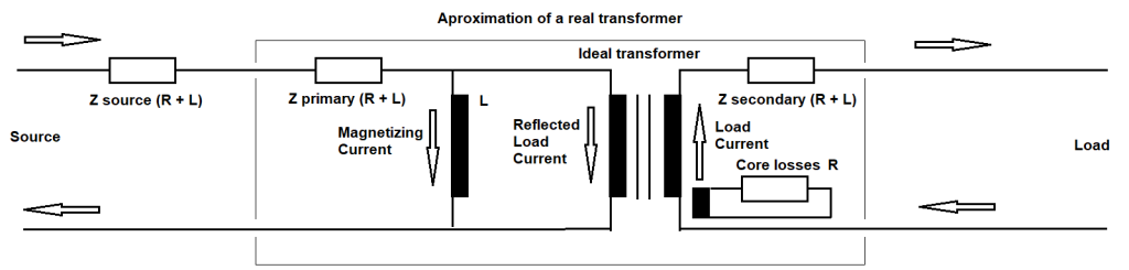

The two components of the transformer primary current can be seen better if you view a real transformer as an ideal lossless transformer with an inductor across the primary (assuming its series resistance and inductance are small).
Then the inductor current is the transformer magnetizing current and the primary current is simply the load current multiplied by the turns ratio.
The load determines what that current is, you can't change it without changing the output voltage. If you reduce the drive to one half cycle you will get a distorted voltage waveform.
Easier to see if the ideal transformer is 1:1. Vs = Vp and Ip = Is, You could replace it with a pair of wires. The only thing left is the parallel inductor.
All you need to do is ensure there is no DC through the inductor by adjusting the PWM a small amount.
The low impedance of the H-bridge will give the load whatever current it demands. The PWM adjustments above mean a non-linear load will produce a little voltage distortion but you just have to put up with that.
The only catch is in the real transformer you can't directly measure the inductor (magnetizing) current, making correcting it tricky.

Wouldn't the magnetizing current be approximately the primary current minus the (secondary current x turns ratio)?
Another thought I had is to use a fast comparator and just limit the peak current cycle-to-cycle. The IRF21844 gate drivers I use has a shutdown pin that could be toggled in an extreme over current event before saturation. It might be better to latch it off and let the controller turn it back on after some amount of time.
Posts: 3413
Posted: 02:58am 04 Oct 2026
  Quote  Wouldn't the magnetizing current be approximately the primary current minus the (secondary current x turns ratio)?
Yes, provided the current measurements are accurate enough and read on each cycle of the PWM frequency (to cater for distorted waveforms).
The magnetizing current is very small compared to the maximum primary current, 1% as a ballpark figure. So the accuracy of the transducers (not just the resolution) would need to be 0.1% to get a barely usable figure that is within +-10%, and 0.01% to get a reliable figure of within +-1% of the magnetizing current.

This feels a bit like poking a hornets nest but I feel the need to look deeper into what is going on in our inverters
The inverter power stage has impedance - it is not an ideal drive, the transformer has impedance it is not an ideal transformer, a half wave load is not an ideal load, sensing from the output voltage load winding is not the ideal way to sense. I find that trying to relate all this to an ideal transformer etc is not really very helpful in finding a solution.
In laymans terms when a half wave load is connected to our inverter, yes the current drawn is reflected back to the primary. But due to the secondary impedance and to a much lesser effect the primary impedance and the impedance of the supply battery through the power stage & choke/s we have an issue.
The PWM% that was being used up to the point of driving that half wave load is now not enough to drive the output winding to the same peak value that occurred just prior to the connection of the half wave load. The reason for the droop is due to the addition of all the series impedances.
The net result is the toroids primary magnetising current is less for the loaded half cycle due to the losses involved.  However the unloaded next 180 degree waveform is a totally different story as its magnetising current will be the same as before the half wave load was connected - the series impedances have essentially no effect on the unloaded 180° as only magnetising current is being drawn for that unloaded half cycle.
If we now consider if feedback is being used and applied to the PWM generator it will cause a higher PWM% drive due to the reduced average output voltage, caused mainly due to the loaded & reduced peak half wave.  The unloaded second 180 degrees will then have an even higher level of magnetising current for its next half cycle.
So it is my contention that the asymmetrical magnetising drive will drive the transformer towards saturation (on the unloaded 180 degrees) after a few cycles.
I believe the posted waveforms here (second picture) here show the droop in the primary drive yellow PWM during the loaded 180° followed by the saturation event on the unloaded 180° - this all makes sense to me.
  phil99 said  Then the inductor current is the transformer magnetizing current and the primary current is simply the load current multiplied by the turns ratio
Er no, over simplified, the primary magnetising current 180° sections are not equal for a large half wave load due to the impedance issues outlined above.
  phil99 said  If you reduce the drive to one half cycle you will get a distorted voltage waveform
Consider we already have an asymmetrical (distorted) magnetising current drive, I see it that if you don't reduce the drive to the unloaded 180 degrees or conversely increase the drive to the loaded 180 degrees you will continue to get a distorted waveform that gets worse as we have started towards a saturation issue. Note the important part here is to make equal the two 180° magnetising current portions.
I am not trying to be argumentative but try as I might I could not get a picture in my mind that made sense using ideal transformer and ideal load analysis.
Yes but it is exactly what I am suggesting should be done for the unloaded half-cycle.  The unloaded half-cycle is being over-driven and the high voltage is only driving the transformer further into saturation leading to the overly high peak and long duration magnetizing current pulse at the end of the half-cycle.  There is a need to keep producing sinusoidal output voltage for the unloaded half-cycle but the magnitude can probably be reduced 10-20% to help reduce the magnetizing current peak and duration.
For half-wave loads, I think it's more distorted as is.  In typical slow control loop inverters, the same PWM scaling factor is used for the positive and negative half-cycle drives.  For half-wave loads, this means the unloaded half-cycle output voltage is typically significantly higher than the loaded half-cycle.
You can see this in the scope captures from earlier posts:
So, my conjecture is that reducing the unloaded half-cycle PWM drive will result in more balanced voltage magnitude for both half cycles and less of a kink (lower THD?) in the unloaded half-cycle voltage waveform.
This may work for the flux walking problem with linear loads but I doubt it would be adequate for half-wave loads.
