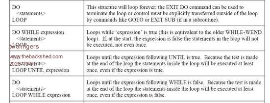

DO [WHILE / UNTIL ...], LOOP [WHILE / UNTIL ...]
    runs as text: a user FUNCTION call in the condition

@Peter
A question for clarification:
Is "DO UNTIL" allowed now?
( I never understood why it was sometimes forbidden but sometimes worked anyway.)
Posts: 11925
Posted: 02:33pm 30 Sep 2026
  Quote  Is "DO UNTIL" allowed now?
Check the manual
twofingers
Joined: 02/06/2014
Posts: 1779
Posted: 03:04pm 30 Sep 2026
Hmm, that (PicoMite, User Manual, MMBasic BASIC interpreter, version 7.0.00)
looks unchanged.
That means "do UNTIL" is still not allowed...
Very regrettable!
A follow-up question (since you're in a talkative mood)
I recently tried out "Gosub" (I think for the first time in 40 years).
Is it correct that Gosubs and their associated subroutines are only allowed within the main program and not within regular subroutines (Subs)? I couldn't find any information on this in the manual.
I actually wanted to say that I found the behavior unexpected.
Edited 2026-10-01 01:51 by twofingers

- The manual's command list was missing `DO UNTIL condition ... LOOP` and
 `LOOP WHILE`; both have always worked.

  matherp said  [...]
I must have overlooked this:
Although - I can't prove it - I seem to recall (for >v6) getting error messages with "Do Until" in some cases that made it necessary to replace it with "Do While Not" [...].
  Quote  Summary of changes from V6.02.01
All versions
Performance improvements for FOR/NEXT loops and IF/THEN/ELSE/ENDIF constructs
OPTION PROFILING ON/OFF 'see option-profiling-cache.pdf for details
The editor now supports editing long lines without splitting them or using continuation lines
DO UNTIL/LOOP now implemented
I'm pleased, but still skeptical ... Thanks for this useful addition!

  twofingers said  @Peter
some people tell me, that they use it
"do loop until xyz"
do an loop are separate commands.
"do
loop xyz"
or
"do:loop xyz..."
perhaps that is not your problem...
Posts: 9163
Posted: 11:50am 01 Oct 2026
Eh? You don't get DO and LOOP on the same line, do you? it would be pointless to include the terminator in the same instruction.
Test at the beginning:
DO UNTIL x=100
inc x
LOOP
DO WHILE x<101
inc x
LOOP
Test at the end:
DO
inc x
LOOP UNTIL x>99
DO
inc x
LOOP WHILE x<100
That's how I've always understood it anyway. :)
