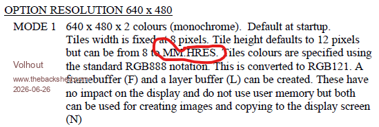

Posts: 6118
Posted: 09:06am 26 Jun 2026
Should be MM.VRES (multiple locations)
