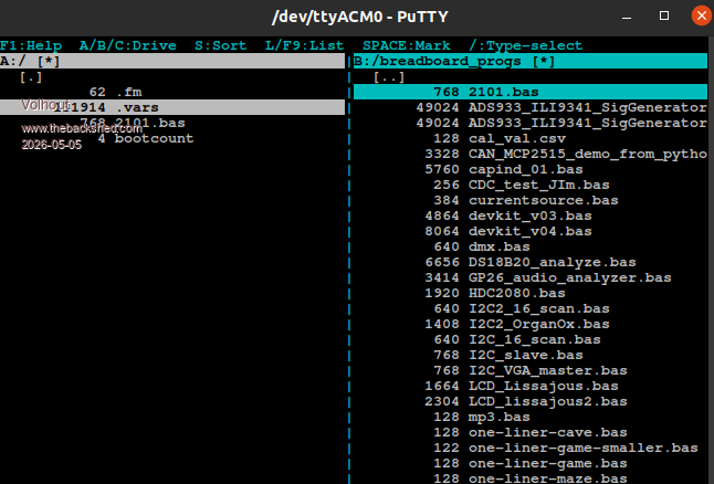

Observations on 60300rc0 (also second version):
1/ When there is a large program (i.e. 50k) in program memory, and you do not explicitly remove it with NEW, then open FM, select a file, then press F2 to edit, you get the "not enough heap" problem.
2/ When you get the "not enough heap" problem, a file called ".vars", size 131k,  is left behind on the A:/ drive.
P.S. I assume you need 132kb free on A drive to use the editor when in FM ? Maybe note that in user manual. Some may not have this luxury (Game*Mite).

  Quote  When there is a large program (i.e. 50k) in program memory, and you do not explicitly remove it with NEW, then open FM, select a file, then press F2 to edit, you get the "not enough heap" problem.
Ah Ha - that was the clue
Try this
PicoMite.zip
