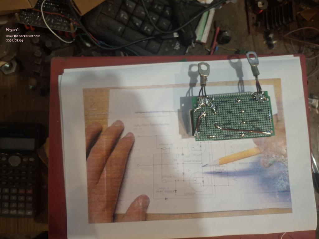

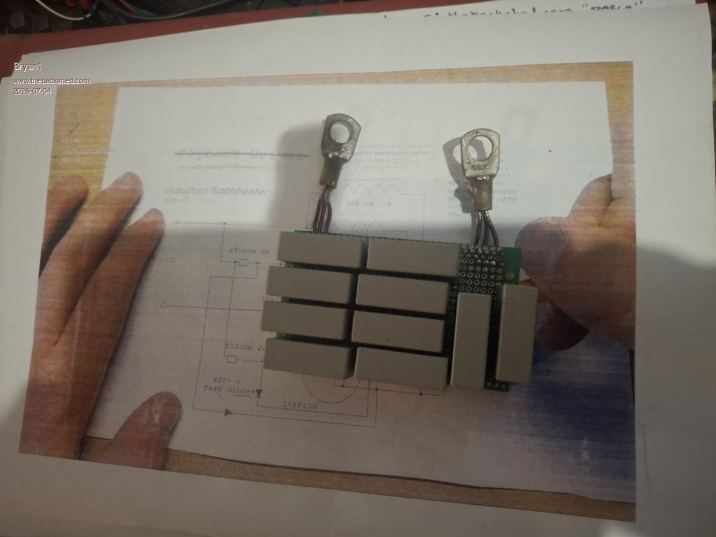

Well had a bit of fun this morning and got the cap board made
Now as I bought 0.47uf caps put 10 in series to get 0.047uf so thats one job done and as my daughters are coming over soon thats end of the fun.
Regards Bryan

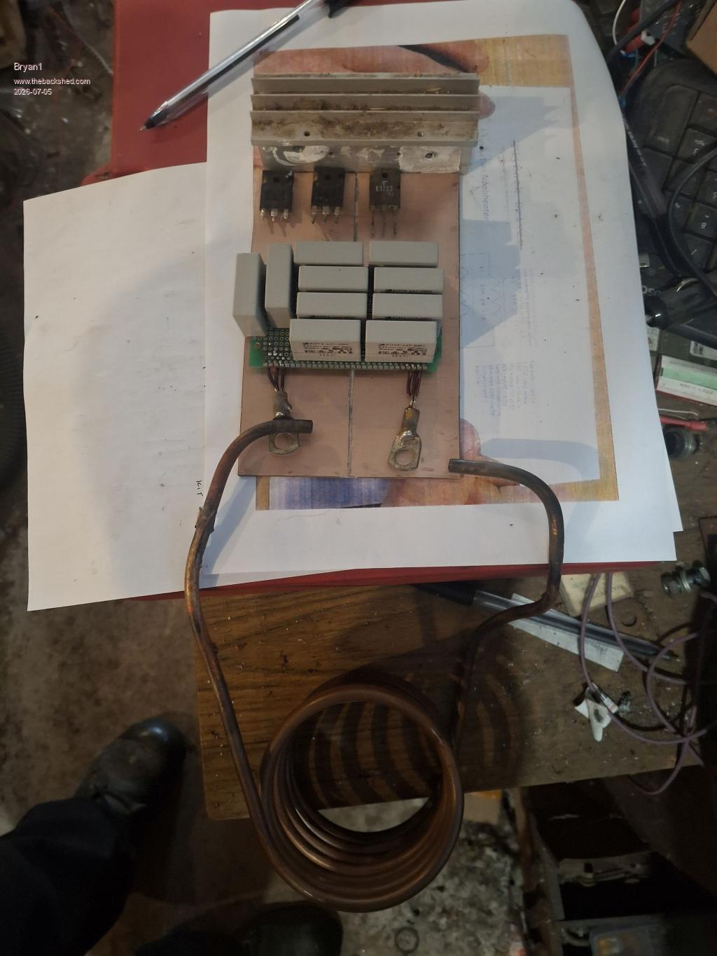

Well got a bit more done this morning and later I'll do an Altronics order to get the 5 watt 12 volt zeners and 5 watt 470ohm resistors. Also I'll get the headers and limit switches for the Surface Grinder project and other gear.
Here is the mock up
As I do have some of those STTH6002C dual diodes I'll use them along with some HY5608 mosfets.
The pcb is dual sided so the negative rail will be on C1 along with positive rail on C2 so plenty of copper to handle the power. The main connection will be a 8mm bolt to hold everything together.
So getting there.....

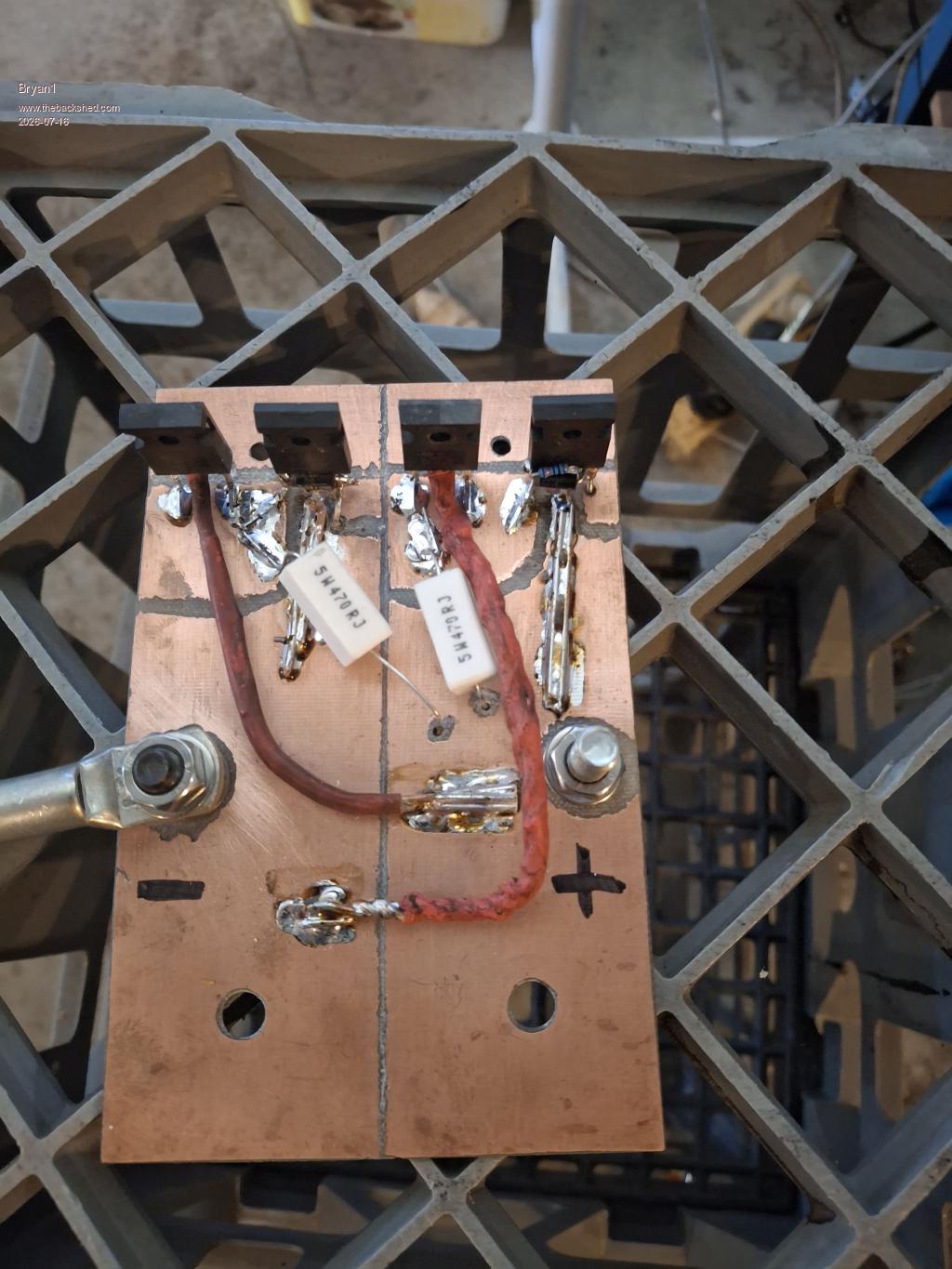

Well finally got the board all finished so was eager to test it and didn't do a continuity test
Just used my programmable power supply and it was a dead short
Now the 5 watt 12 volt zener and the 10K resistor are soldered directly to the mosfet pins to cut down in interference.
Now that extra copper I put on the drain pin on the left mosfet was in contact with the source pin so yet another fet going to my Blown Fet list
