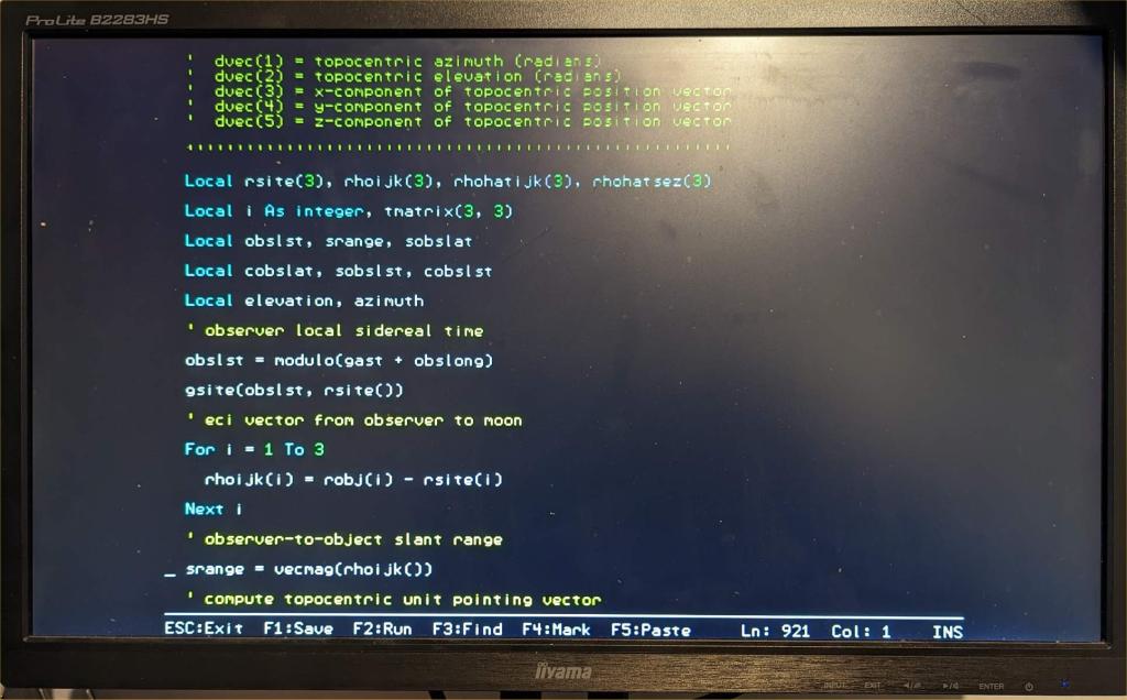

The key to this release is in the DRAWBITMAP routine. Previously in mono mode this just output an "on" pixel or an "off" pixel. However, it was already being fed with the foreground and background colours - it just ignored them.
Now, it analyses the bitmap subject to the following conditions:
Does the bitmap start on a pixel exactly divisible by the current tile size both vertically and horizontally?
Is the bitmaps' width and height an exact multiple of the current tile size?
In the case of the editor both these conditions will always be met.
If the conditions are met then the DRAWBITMAP routine now sets the tile(s) where the bitmap (typically a text character) will appear to the foreground and background colours requested.
The change to SCROLLLCD was similar. If the vertical scroll is equal to an exact multiple of the current tile's height then scroll the tile colours as well as the screen pixels
These two simple changes effectively enabled full colour editing in 640x480 resolution (mode 1). There was a bit of tidying up in the editor around the cut-and-paste functionality and making sure to set tiles to the correct colour when deleting characters. Otherwise it just worked.

Colour editing works nicely at 126MHz and
It also enables the PRINT and TEXT commands to use colour as long as the character locations meet the conditions above.
So, in mode 1, you can now go
TEXT 0,0,"Hello World",,,,rgb(red),rgb(green)
or
colour rgb(red),rgb(green)
print @(0,0)"Hello world again"
and it will do what you expect (in mono mode   )
If the output is not aligned to a tile boundary then the tile colours will be
ignored. So print @(100,0)"Hello world" will appear in whatever the tiles on which it is written are set to (typically black and white)
On installing the new firmware the default tile size will be 8x12 to match the default font 1
You can change the default with
OPTION TILE SIZE SMALL/LARGE
This is a permanent change which causes the processor to reset
Alternatively, in a program, you can use:
TILE SMALL/LARGE
To use the editor in colour then, of course, you need to set OPTION COLOURCODE ON

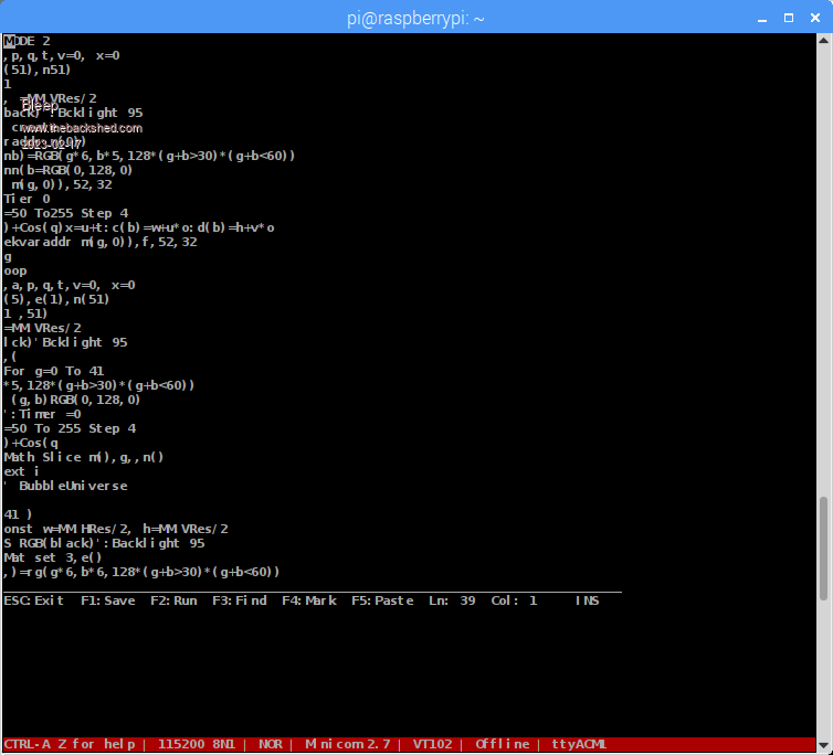

I have a problem when using the editor in mode 1.
If I change to Mode 1 and then Edit, the editor only shows some of the lines of the program and locks up solid, requiring a power off reset.
PicoMiteVGA MMBasic Version 5.07.07b19
OPTION SYSTEM I2C GP22,GP15
OPTION KEYBOARD UK
OPTION DEFAULT MODE 2
OPTION DISPLAY 30, 53
OPTION SDCARD GP5, GP2, GP3, GP4
OPTION AUDIO GP6,GP7, ON PWM CHANNEL 3
OPTION RTC AUTO ENABLE
OPTION DEFAULT FONT 7, 1
I have now found that it's the OPTION DEFAULT MODE 2 that is causing this, if I change it to OPTION DEFAULT MODE 1 all seems to be ok.

Also, I accidentally copied and pasted all of this piece of code, using autosave.
vgabubble.bas.zip
I realise it's several slightly different versions of the same code, however once loaded the editor mangles it, the first 35 lines of code are fine and consist of a loop so the rest is never executed. However I didn't think the remainder should get corrupted like this, even though it shouldn't be there? the image is after scrolling down one page. I had done a flash erase and fresh install of b19 with no options set this is a terminal, but the VGA looks the same. This isn't particularly important as I shouldn't have done it! :-(
Any Ideas?
Regards, Kevin.

V5.07.07b20
PicoMiteVGAV5.07.07b20.zip
Fixes a bug if OPTION DEFAULT MODE 2 is set and you execute EDIT 1
