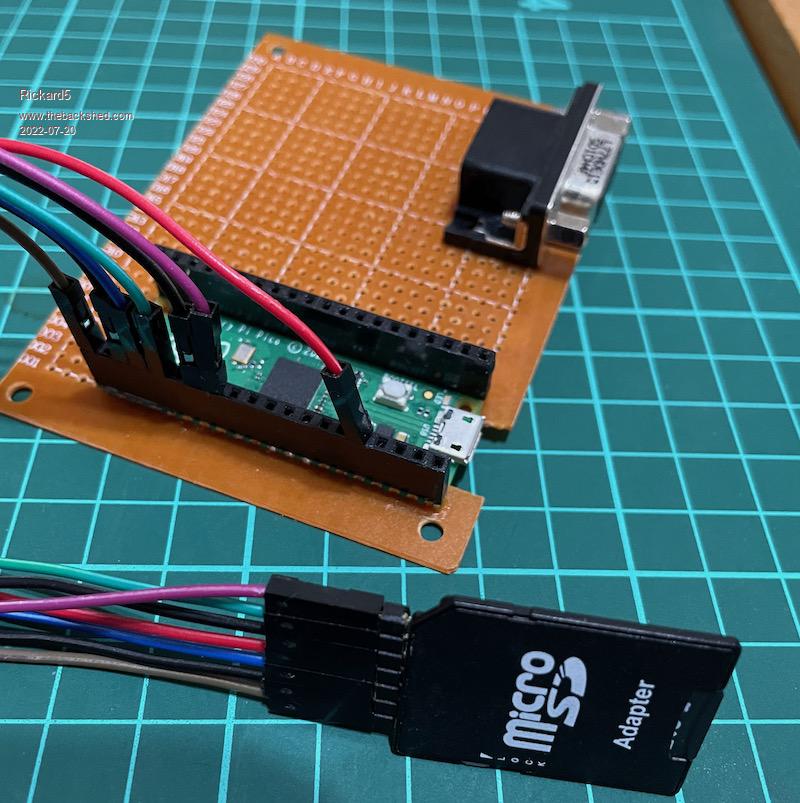

Somewhere I found enough information on hacking an SD Card directly to a Pico and did it successfully with :
OPTION SDCARD GP22
Unfortunately I had a situation and the card came disconnected from the pico and I cannot find that info again, does anyone know where I can find a hookup diagram

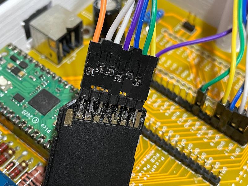

Posted: 09:07pm 19 Jul 2022
Hi thar perdner,
I've got no idea of the connections but, given the clarity of your photo, can you track the connections down by following the coloured jumpers?

Posts: 9329
Posted: 09:25pm 19 Jul 2022
You can put an SD card on any pins. It doesn't matter. You just set up OPTION SDCARD with the pin numbers that you used.
For a standars SD card:
Looking at the copper on the SD card holder, working from the bevel, the pads are
9 1 2 3 4 5 6 7 8
9 - no connection
1 - CS
2 - SDI (MOSI)
3 - GND
4 - 3V3
5 - Clock
6 - GND
7 - SDO (MOSI)
8 - no connection
By the way, if you are going to use a PicoMite VGA the SYSTEM SPI option isn't supported. You have to set up a SD card using OPTION SDCARD CSpin, CLKpin, MOSIpin, MISOpin

Rickard5
Joined: 31/03/2022
Posts: 463
Posted: 12:31am 20 Jul 2022
Unfortunately I used 2 Black wires And I can't track them down though the mess

Rickard5
Joined: 31/03/2022
Posts: 463
Posted: 03:42am 20 Jul 2022
OK SO I'VE WIRED WORKING FROM THE BEVEL
         - no connection
gp16 - CS
Gp17 - SDI (MOSI)
Gnd - GND
3v3 - 3V3
Gp18 - Clock
GND - GND
GP19- SDO (MOSI)
         - no connection
But the real question is which is the mosi and which is the MISO ?
and I reflashed my Pico with picomitevga5.07.04rc3.uf2 and when I do "option SDCARD GP16, GP18, GP19, Gp17
I get "Error : Pin 21 is in use" returned
Posts: 3430
Posted: 04:44am 20 Jul 2022
Type OPTION LIST to check for pin assignment conflicts. If you need to change any pin assignments you may need to use OPTION xxxx DISABLE before re-doing that option with different pins.
Page 37 of the manual shows how to connect the Pico pins to the SD pins and describes the two ways of setting the SD up.

Posts: 12185
Posted: 06:57am 20 Jul 2022
  Quote  I reflashed my Pico with picomitevga5.07.04rc3.uf2 and when I do "option SDCARD GP16, GP18, GP19, Gp17
Which pins do the VGA output use? Manual page 6
Posts: 9329
Posted: 07:44am 20 Jul 2022
Oops....
Pin 7 - SDO - (MISO)
Must have been the heat. (That's my excuse and I'm sticking to it!)
Plasmamac
Joined: 31/01/2019
Posts: 620
Posted: 08:30am 20 Jul 2022
Pin 3 and pin 6 are intern connected in the big adapter.

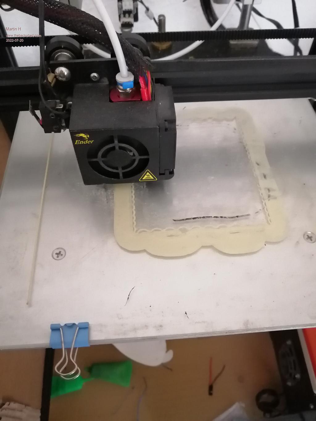

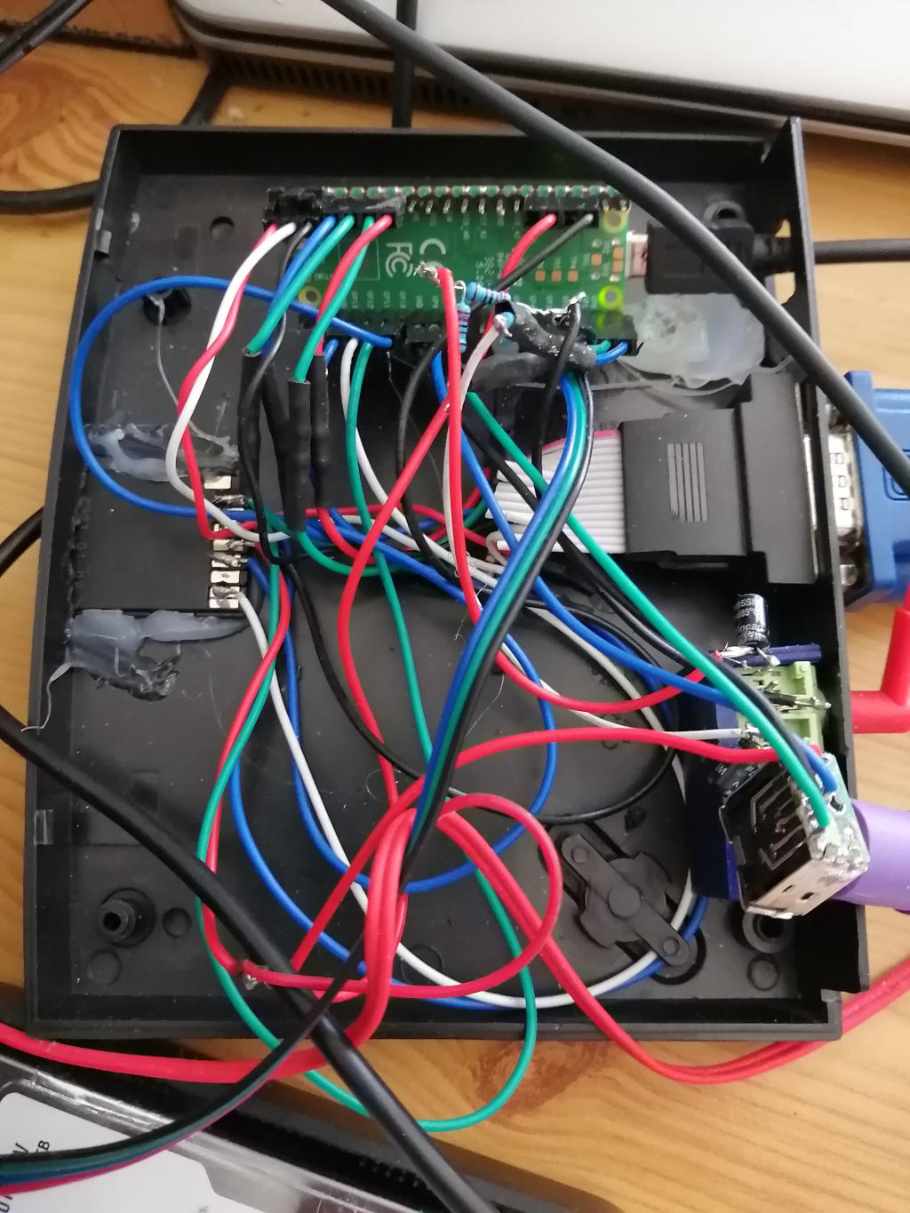

Posted: 09:31am 20 Jul 2022
Works fine in my "Prototype"
ugly but a New Case (for the counterfeit PicoGame Board)is in Progress
'no comment

Martin H.
Joined: 04/06/2022
Posts: 1580
Posted: 11:19am 20 Jul 2022
not Ali Express ...
I build the circuit, according to the plans, on perforated grid board
and this should fit in the printed Case
so the feather in your cap has to wait ;-)
Edited 2022-07-20 21:21 by Martin H.
'no comment

pwillard
Joined: 07/06/2022
Posts: 347
Posted: 01:40pm 20 Jul 2022
There is a case?  Where?
Posts: 9329
Posted: 01:50pm 20 Jul 2022
It looks like Martin is 3D printing his own case for a perfboard build.
The official PCB fits the Hammond case listed on the BOM.

pwillard
Joined: 07/06/2022
Posts: 347
Posted: 01:58pm 20 Jul 2022
  Quote  Works fine in my "Prototype"
aka "big ol'e  mess'o wires"  :)
Martin H.
Joined: 04/06/2022
Posts: 1580
Posted: 02:02pm 20 Jul 2022
  pwillard said  There is a case?  Where?
it will be a modded Version of this one:
https://www.thingiverse.com/thing:1496674/files
(still printing)
