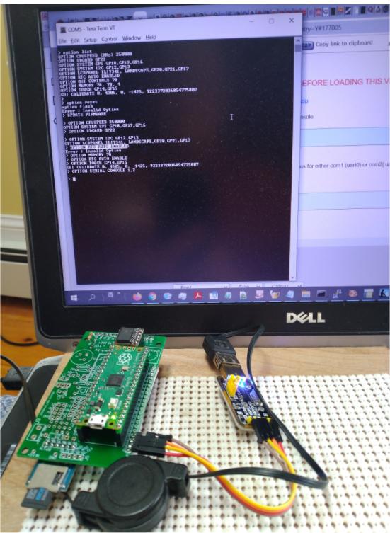

Posted: 04:34pm 02 Nov 2021
  matherp said  Implements the option of using a standard uart as the console
Well ok.
Though I'm not exactly sure where I would go next with this.
(Better put a note on this to remind me that it's on UART console; otherwise I'll be befuddled if I try to access it through USB.)

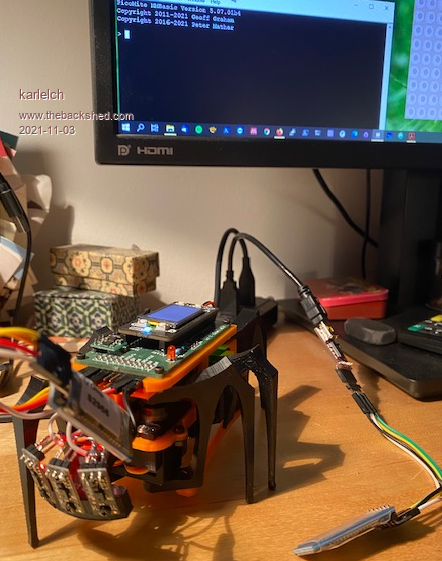

Posted: 05:42pm 02 Nov 2021
Very cool!
Now I can program via a simple bluetooth link using two HC-05 modules :-)

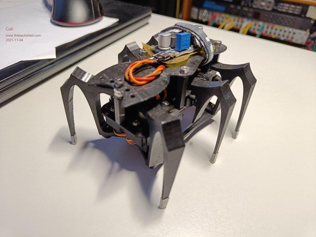

Posted: 02:55pm 03 Nov 2021
  karlelch said  Very cool!
That sensor array is impressive!
Greets from the evil twin:
I have few time at my hands these days, but... SOME DAY...
atm there is a Tiny RP2040 in there, time to test PicoMite on it.
Carsten
