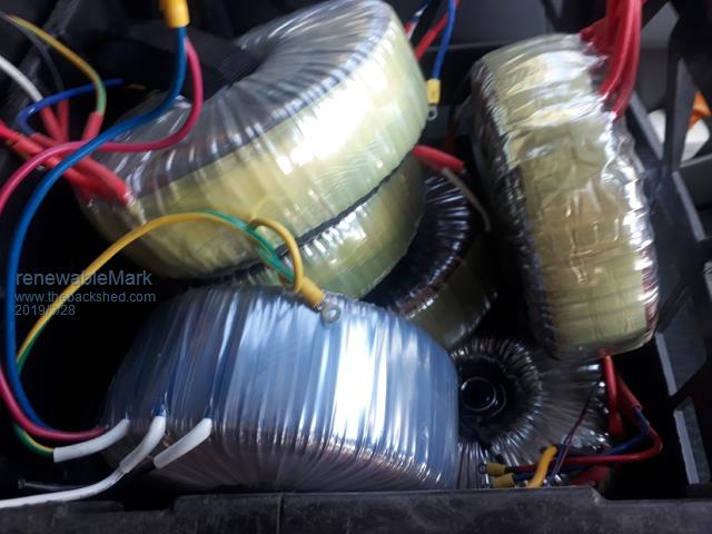

OK so.... torroids.
I have a double stacked pair of 3kw's. That has 128 turns on 4 secondaries, primary so far is 14 turns of 70mm2.
I do have plenty of that 70mm so can wind on as much that will fit, it wont be pretty though, reckon only 6 more will fit.
I can get some 25mm2, that should still carry 100 amps, or use 50mm2
No 2 torroid I have an unmolested 2kw aerosharp.
No 3 torroid I have an unmolested 2kw aerosharp.
No 4 Will pick up a 1kw aerosharp.

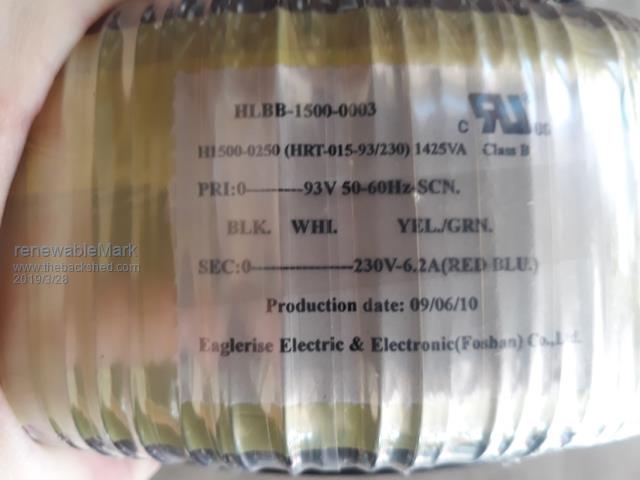

OK I'm not too great on calculating, so I'll need a bit of help with the torroids.
Batt volts is a 48v bank, my normal LV cut off for bank is 46.5, but it's never actually cut off in 6 months use, I think the lowest it's been under a heavy load was the low 47's.
No 1 toroid is already made with 2x3kw cores stuck together 128 turns of 4 layers secondary.
14 turns currently on primary.
So how many extra will I need on the primary?
No 2 torroid will be a 2kw core, I'll most likely rewind this from scratch, so what would be the optimal turns and number of layers for secondary and primary?
No3 & 4 I picked up a few smaller ones today.
Cheers Caveman Mark
