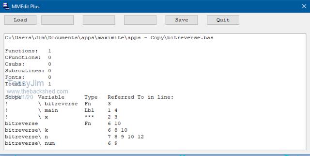

MMEditPLus is a stand-alone variable report producer.
It will eventually replace the one built-in to MMEdit but for now it can be used with Notepad++
It does differentiate between variables local to functions and should flag any undeclared variables.

  Quote  main:
INPUT x
PRINT bitreverse(x, 16)
GOTO main
FUNCTION bitreverse(num, k)
LOCAL n
FOR n = 1 TO k
IF (num AND 2^(n-1)) > 0 THEN
bitreverse =bitreverse+
2^(k-n)
ENDIF
NEXT n
END FUNCTION

Noticed that the subroutines come up as "Fn" in the "Type" column in the program I'm testing at the moment
I didn't differentiate between subs and functions.
I also didn't differentiate between const and dim.
For the exercise of tracking variables, the differences don't matter.
