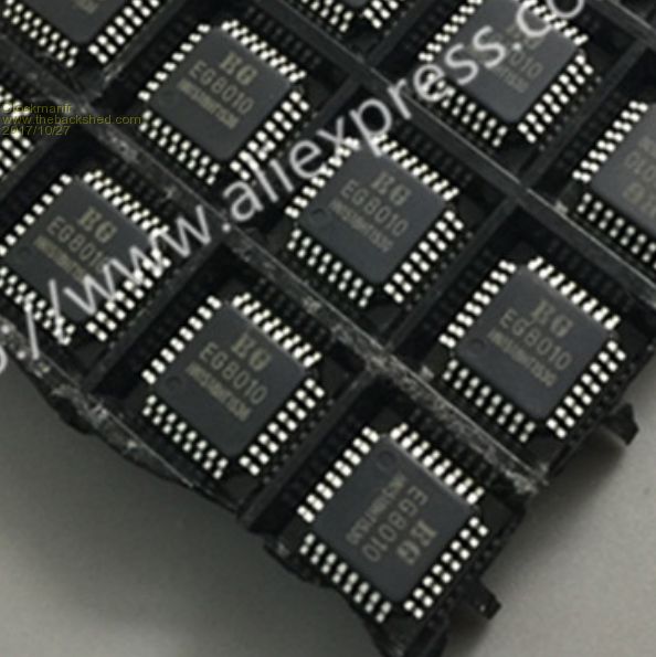

The EG8010 LQFP-32 sinewave inverter chip, that we know that works, ... should have the code ........... HN1518HT1536 on it.
Its those last 3 numbers that can be different.
I ploughed through Aliexpress until I could actually see those correct numbers on the chip. Like oztules I bought plenty, 80 or so, from different suppliers in the end I got 50 good ones.
This supplier was good. ..... but sadly no longer stocking?
Trust this helps?Edited by Clockmanfr 2017-10-28

Thanks oztules & clockman, your info is spot on. It appears I have the wrong type of EG8010 chips.
I must have forgotten about the different chips, I'm blaming senior moments...
Anyway, did some more tests with the chips I have today.
They are: HN1702HT1718
I eventually worked out a misunderstanding about how the 8010 works, should have read the application notes more thoroughly .

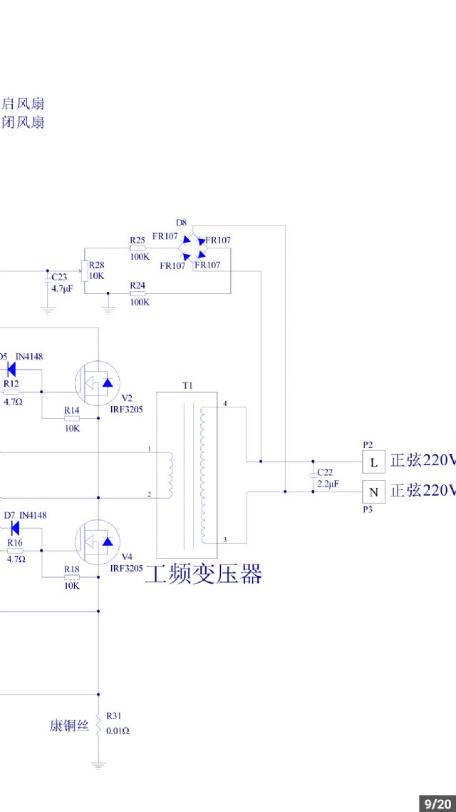

One of the reasons I started looking into that VFB signal is that oztules had rectified the 12V output of the little sampling transformer on his control board.
Why??
On the application notes of the EG002 and the EG8010 circuits the VFB sampling signal is AC. None rectify the VFB signal in any way.
I tried 3V peak AC and its full bridge rectified version and both appear to work, there are just twice the number of positive sine wave halves on the rectified AC.

noneyabussiness
Joined: 31/07/2017
Posts: 527
Posted: 09:06am 01 Nov 2017
Actually as u can see they do rectify the feedback signal when using the " low power frequency transformer " which we are effectively using... also in a earlier post of oz's there was an issue about grounding, hence the small transformer for isolation. .

Tinker, I do not like the idea of 3V AC applied to Vfb.
EG8010 datasheet on page 11 tells us the maximum rating for any I/O pin is
-0.3V to 5.5V with respect to ground.
3VAC is going to be -3V to ground and it's low impedance too.
It would be unwise to expect the IC to survive this for any length of time.
