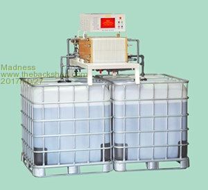

Just saw these Vanadium Redox Flow Batteries on Alibaba, 30KWH $15,500 USD landed in Brisbane. I wonder how hard would it be to build one

Excuse my stupidity. .. how does it work??
I think it works !!
Posted: 12:06am 27 Oct 2017
If you look here it will give you an overview. The electrolyte is charged and pumped through the plates, the more electrolyte you have the more capacity.
This video gives a good simple explanation of how it works and to build one.Edited by Madness 2017-10-28

It sounds like the vanadium redox system basically works ok but the
necessary auxiliary systems like charge and electrolyte management need
a fair bit of development. But that is a chicken-and-egg situation,
it will take a number of installations at that scale to do that I guess.
Posted: 10:52am 30 Oct 2017
All these demonstration images show only one cell and two tanks.
What is not made clear is the voltage generated per cell.
If multiple cells in series are required to generate a usable final voltage, does that require multiple isolated tanks and pumps ? If it does, as seems likely, that introduces a whole new level of complexity.
The diagrams all show sulphuric acid in direct ionic contact with the output electrodes, so I am assuming the electrolyte runs at the same potential as the electrodes because its highly conductive and in direct contact.
Having a multi cell battery is not such a big problem, although if every cell requires its own pump and dual tanks that certainly adds to complexity and possible points of failure.
