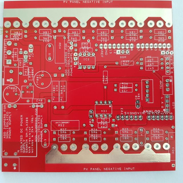

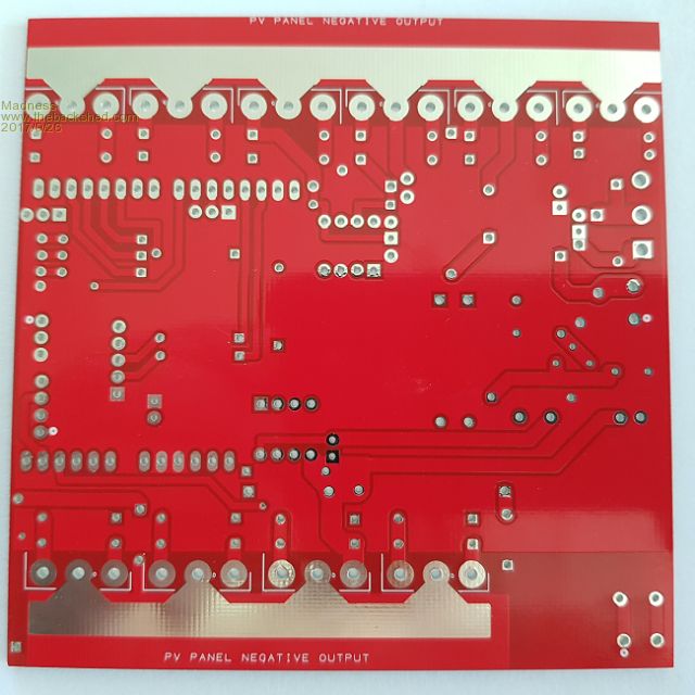

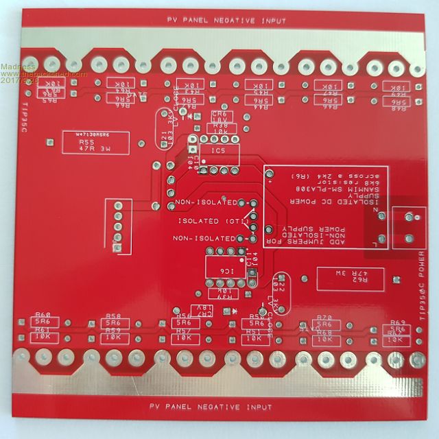

Just received the new PCB's today for the GTI/PV charge controllers.
Master PCB
Slave PCB
These will allow any combination of up to 4 GTI's or PWM PV panels to the battery, allowing control of around 20KW of panels with both master and slave PCB. It is suitable for 24V or 48V but not 12V as the driver chips require 18V. The best PV panels to use the ones with a maximum power voltage (VMP) of 30.4 or close to that. Having 2 of these panels in each string give maximum power at 60.8V which is just above the 59.2V Absorb voltage required for many batteries. Yes a $1,000 plus MPPT charge controller will in theory give slightly more power from the same panels. However, if you build your own controller for less than $100 you can buy a lot more panels with that extra $900, I recently bought 5KW of secondhand panels for $700. So for the same amount of dollars you will have significantly more power from your PV panels.
This is based on Oztules design in this thread, my version has the MOSFETs, isolated power supply and multiple banks of MOSFETs on the PCB. Over the next couple days, I will get a PCB assembled and running. These will also run on Oztules code with the addition of control of the extra digital output pins. I am working new code that will include temperature compensation and the ability to control two separate dump loads (ie hot water system) to take advantage of excess power, I plan to use to control air condition in the container where I have my batteries and inverter.
For those new to this, some Inverters inculding the Ozinverter will allow the connection of a Grid Tie Inverter (GTI) to the AC output of an Off Grid Inverter (OGI) this is called "AC Coupling". The excess power generated by the GTI passes back through the OGI to the battery bank. Some advantages of this are the use of less wiring from the PV panels as it running at a much higher voltage, it takes advantage of the GTIs maximum power point tracking, during daylight the GTI adds to the capacity of you OGI allowing greatly loads and GTI's are readily available second hand for minimal cost. One big disadvantage is that a GTI is designed to make as much power as possible for exporting to the grid, this a problem with an off grid power system as once the batteries are full you need to stop charging them or it will cause harm to the batteries, some types are more susceptible to this than others. However there is now a solution thanks to Oztules and upgrades I have added.
With this control board, we can control the charging of the batteries using MOSFETs and a PWM signal that rapidly turns on and off the connection to the PV panels, therefore, reducing the power going to the batteries as they get towards full charge. This is controlled by a Microcontroller called an Arduino and gives us total control of the charging at a fraction of the cost of commercial charge controllers.
I will post photos and details of the asembly as I go.

Posted: 08:29pm 25 Sep 2017
Nicely explained Madness.
Love the painting by numbers boards, excellent.
Had a few electronic guys mumble about my boards being "painting by numbers", but at least normal folk can readily understand what's going where, with fewer mistakes, and easy to repair in the future. Also helps my memory and stops me hunting/ getting paper work out.
Getting the battery voltage to your circuit at the GTI, when its on the PV installation building some distance away from the Battery shed/building.
I have ordered a few of these......

Posted: 08:45pm 25 Sep 2017
Why would someone have a bitch about having the values of the components on the board? I would have thought Ivory towers would be in short supply these days.
I just did a quick google and the consensus is around 200 - 300 M is the range of a power line network, but they are connected to the open grid as well so in a closed grid that may be different, selecting a slower speed on the adaptor would worth a shot also.
There are two options that come to mind to control it remotely, one is to send the voltage as you mentioned or send the PWM value of the master. I think the second is less likely to have controllers in conflict. If one has gone into float and the other is still trying to get to absorb the first will back off and not be contributing any power as the other will be trying it's hardest to reach absorb voltage. On bright day this may not be an issue as the second may well produce enough power to get the volts up to absorb and then go to float. However, on a grey day it may never quite get there. If one is the master sending a PWM level signal the second will just play follow the leader.
I have had to use long pins for the Arduino socket so there is sufficient clearance for the connectors below it.

This is a game changer board Mad, I can't find anything out there even remotely comparable.
Handles huge current and cheap as you can get, while still having everything you could need to control lots of charging... of any source really.
Don't know why this has not been done before up to this power level... but then none of the home brew inverters are any where near what you have got now either.
Nice work.

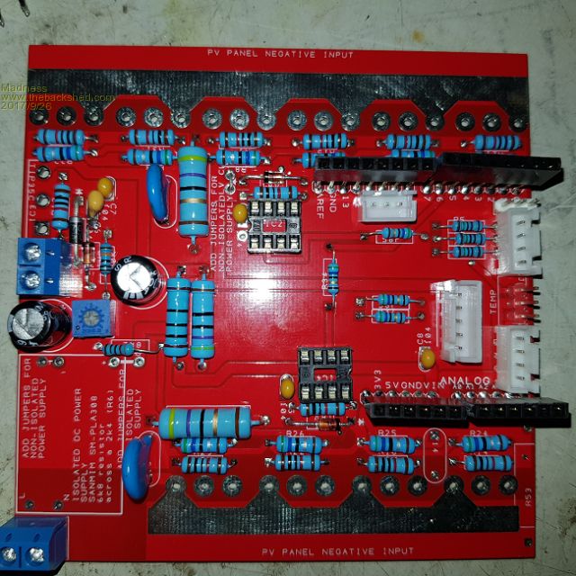

I have almost completed assembling the first one of these. Once I have confirmed that is okay I will order the next batch. The new design will allow adding a network card and SD card so it can log data and make it available over the net. Also, this will let you connect controllers located some distance apart and have them work in unison. For example, if you have panels on GTI that is 200 metres away from your batteries and other panels the one at the batteries could tell the slave at the GTI what percentage the PWM should be.
