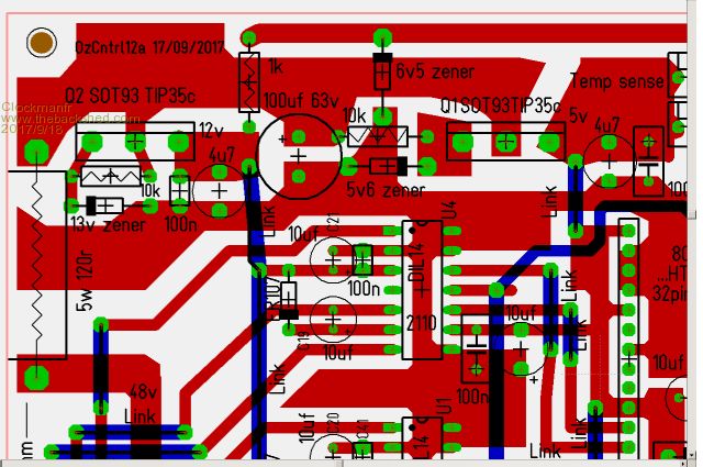

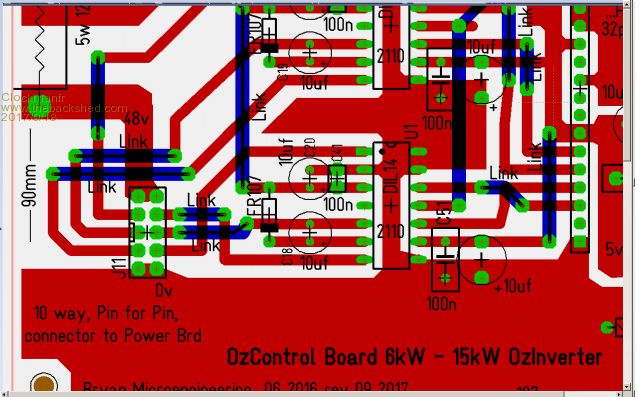

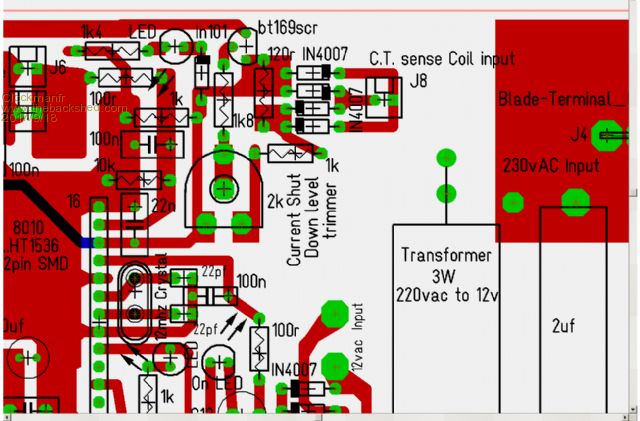

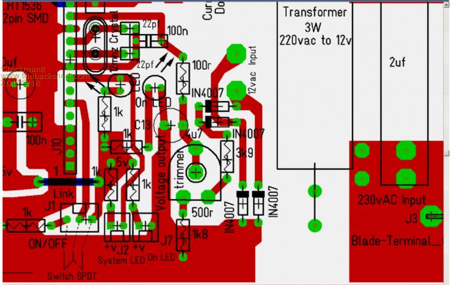

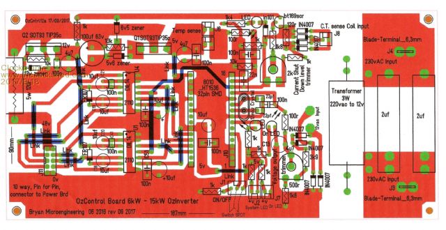

Hi 'Oztules' and guys.
September 2017 and the New PCB has all the latest up-to-date modifications. Thanks to Madness for asking 'Oztules' some clarification questions.
Here are some screen Photos of my latest OzControl Number 12 PCB board, with all 'Oztules' and gangs amendments.
My boards are slightly different than Oz's original's as in the very beginning I wondered away on a different path. But its pretty well Oz's design.
Its 5mm higher/width and 18mm longer, so now 90mm by 187mm. Longer for getting that big extra 2uf capacitor on neatly, with flexibility on deferring sizes with the AC voltage sence transformer.
'Oztules' a couple of questions.....
I see with your latest board, 12v supply and 5v supply, you have changed 4.7uf to a 10uf any reason?. .......
Up near the Thyristor there is a diode to the LED, fr101, is this critical?
If you can check my circuit over for howlers it would be appreciated. If okay I will have some made up and put one on test. Then I will post the Gerbers Zip File on here.
Nice design Oztules and thanks.

Posted: 11:28pm 18 Sep 2017
A quick look seems to show it is ok. The 3k9 may need changing depending on the tranny.
Diode may be anything you have , it is only blocking from memory. 4u7 10uf ... whatever you wish, bigger is better perhaps ... I had a lot of 4u7 left over from something else.

Posted: 01:20am 19 Sep 2017
Hi Oz,
Yeah I had issues with the code too sorted it yesterday, I will post on that thread.
Tomorrow I have some time to try out the new control boards, the transformers I have are 9V so will start out with a 2K resistor and see how that behaves.
My experiments found that the EG1810 is looking for a voltage between 2.5 - 3.0V at the VFB input.
Anything outside that and it blinks a fault.
So, any small transformer from 4.5VAC to 12VAC secondary voltage will do. Just select the first dropping resistor so the pot input sees a max of 4 Volts. You certainly would not want to accidentally feed more than 5VDC into VFB.
Looking at the board Clockman posted above I see there is a 1K8 resistor from the low end of the pot to ground. This complicates the dropping resistor calculation.
If it was me I would short this 1K8 resistor so the low end of the pot is at ground level.
For example, I use a 15K dropping resistor from the rectifier (12VAC in) to the 5K/15turn trim pot input and a 100R series resistor at the wiper to VFB track.
A multiturn pot gives a much finer control here. You'd have to put nail polish on the single turn pot adjust screw to make sure it stays locked to the chosen setting.Edited by Tinker 2017-09-20

"So, any small transformer from 4.5VAC to 12VAC secondary voltage will do. Just select the first dropping resistor so the pot input sees a max of 4 Volts. You certainly would not want to accidentally feed more than 5VDC into VFB."
No, it is not possible to inject 5v into the 8010. This is a negative feedback circuit, and the transformer can be any voltage at all, even 300v... makes no difference to the 8010. It will regulate the output voltage so that it never exceeds it's set point.
Before I added the isolation tranny, it had 320v or so on the input divider, but with the divider the 8010 made sure to keep the voltage on it's VFB input was what was intended. The divider is only there to get the output voltage up over 3.5v or more, not to protect the VFB input... it won't let it rise.
The consequence of this is that the output voltage is driven by this relationship, not the other way around.
By fixing the fixed resistors in a decent combination, we make the voltage range of the trimmer quite small, and so a multiturn ( which I hate) is not necessary,nor is the nail polish. That combination would be a result of poor resistor selection, and excessive range being required to be set by the trimmer.
I can't say the same for the current limiter, there I should have spent more time on the divider values..... but it is what it is, as the range there goes from a few kw to up to 16kw. Over 270 degree range, it is a bit more in the territory of multi turn. May give this some thought one day... and maybe not.

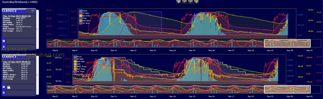

Probably better to work with actual state of charge also, my charge controllers I am using at the moment do that, very easy to implement with just a shunt.
I am sure you will come up with a good functional version I still want to build a more complex version with data logging and web server.
Like what have currently, the white line is state of charge.
