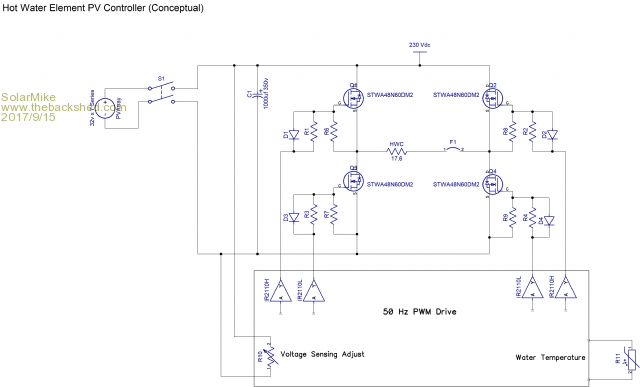

Been thinking about this for a while, I have a future requirement to install solar hot water systems at two locations, one an off grid house and the other a garden centre that wants hot water way out in a shed a hundred meters or so away from the main buildings. Having built my own solar hot water panels over 10 years ago that supply 95% of our household hot water, its a lot of work, welding copper pipe and soldering to sheet copper foil, building the alloy cases, then the control systems, pumps, etc. Commercial panels costs 1000's here in NZ, so not really an option.
So ten years on, with the cost of PV having dropped dramatically, my thoughts now are to use a PV array of 7 x 32volt 9 amp series panels to produce approx 2KW of DC power at 230 volts DC. If the hot water cylinder has a 3kw element fitted approx 17.6 ohms then this will draw 13 amps, not a good match to the PV array, but if a low esr high ripple rated capacitor is charged up from the PV supply voltage then discharged into the heater element, this will allow matching and good power transfer.
PV power makes everything simpler, no anti-frost system required, no pumps to wear out or leak, less expensive; only downside I can see is the array takes up more area, not an issue here, they will be ground mounted on wooden poles.
My proposal is a simple H-Bridge with variable pulse width modulation to adjust the load on the PV array and allow alternating the polarity of the dc voltage across the element to prevent electrolysis. The 50 HZ square wave pulse width is adjusted by the controller monitoring the voltage across the capacitor, as the element resistance load is fixed, short duration pulses will discharge the capacitor a lesser amount in lower light conditions, longer duration for full sun. The standard thermostat can be used as it's seeing square wave AC, NZ reqs require a direct thermostat switch in series with the element for temperature regulation, relays or electronic switches are not allowed.
The drawing shows the concept, the 7 panel PV array has a voltage that varies between 224 - 273, with 224 being the mppt value; H-Bridge configuration is standard but using 600v 40amp mosfets, 0.065R on resistance, so power loss is minimal. The controller will use IR2110 drivers with bootstrap cap for HH bias volts, small 14 pin PIC CPU, thermistor or DS18B20 for primary temperature control, the standard thermostat acts as backup. Isolated controller supply voltage will use one of those postage stamp sized 12 volt supplies.
I really don't think I need a full mppt switch mode voltage down converter here that senses current and voltage to calculate a mppt point, the mppt voltage of the panels is known and doesnt change that much; an extra series panel could be added easily for extra power at minimal cost.
Please all comments welcome, I would rather not go down the wrong track before I start...

Someone I know is using 6 250W panels and a 48V 1500W element that can be bought on Aliexpress. It is controlled by using the original thermostat connected to a DC SSR.
Obviously, this does meet your regulations or the over come electrolysis. but may be of interest to DIY people.
Posted: 06:42am 15 Sep 2017
Some pretty lateral thinking there Mike.
I really like it !
I think I would fit a small non saturating RF choke in series with the heating element to soften the turn on. That will reduce switching loss and reduce possible EMI problems.
It all looks splendid, and I can see no real way of adding to your very well thought through plans.
Well done Mike.

  Solar Mike said   The standard thermostat can be used as it's seeing square wave AC, NZ reqs require a direct thermostat switch in series with the element for temperature regulation, relays or electronic switches are not allowed.
That is interesting, I would have assumed that the only legal requirement was to retain the high limit Energy Cut off (ECO) in series with the element. Perhaps it is because they are built in to a lot of thermostats.

  yahoo2 said   That is interesting, I would have assumed that the only legal requirement was to retain the high limit Energy Cut off (ECO) in series with the element. Perhaps it is because they are built in to a lot of thermostats.
It has to be a mechanical thermo-cutoff switch in series with the power to the element; one cannot use an external relay connected to an electronic sensor as the primary cutoff. Guess they dont want the risk of electronic or solid state switches failing and never turning off. see Exploding HWC

The thermo cutoff switch is the bit with the reset button with the fixed temperature trigger, its not the thermostat, you can still regulate the temperature below that point how you see fit, at least you can in Oz. It is possible to buy them as an individual item, I have retrofitted some to old HWS.
The biggest problem I have with hot water is judging how much the client needs and when they need it. Water used first thing in the morning after a cold night is the hardest to cater for. On some systems we have fitted a preheat tank to stop cold water mixing in the evening on others we have installed instant gas and used bottled LPG because their use pattern is not regular.
I think the idea has merit for the remote building but for the offgrid house I wonder if something that adds to the AC capacity might give you some extra flexibility.

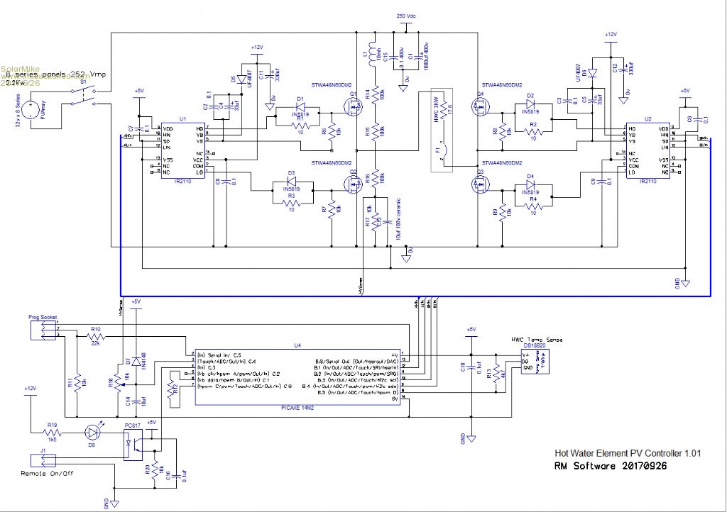

Finally fleshed out some more detail of the circuit design. Just have to write some software on a breadboard test chip and to make sure the CPU hardware will do what I want. Have had to rethink and make some changes around the original H-Bridge HPWM switching, now am not using the inbuilt HPWM controller as it doesn't allow independent timing and pulse width of both HH and HL outputs, instead will run the chip at 32Mhz and use a timed PWM 1000Hz interrupt to allow independent timing of the upper and lower switching.
Upper AHin/BHin will switch at 50 Hz or 10ms per side (less work for the bootstrap caps), the lower ALin/BLin will be switched at a independent variable rate determined by the time to charge then discharge the main 400V low esr cap, the values given will discharge in approx 1.5ms, charge 2ms so in each 10ms half cycle there will be several lower cycles. These will vary according to the amount of sun hitting the PV array; the cpu can measure the capacitor voltage to determined the limits to switch at.
Using the 1-wire DS18B20 also stuffs up the internal clock frequency by switching back to 4 Mhz, so the HWC temperatue will be measured say once a minute with the Bridge turned off for 1 second.

... yes there is an error in the cct around UI/Q1, sorry no beer for those that spot it.
Mike
Posted: 12:17am 26 Sep 2017
  Solar Mike said   ... yes there is an error in the cct around UI/Q1, sorry no beer for those that spot it.
Mike
'VS' not connected to source?
Solar Mike
Joined: 08/02/2015
Posts: 1255
Posted: 12:21am 26 Sep 2017
  Tinker said  'VS' not connected to source?
Yep, only noticed it after posting.

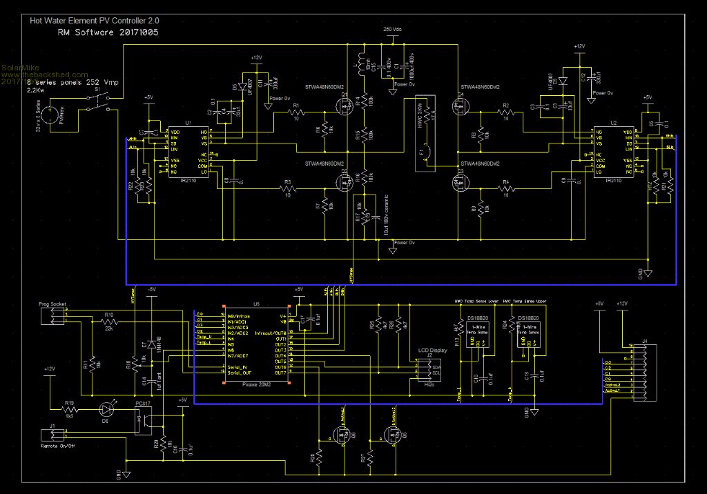

Have played around with various software and can confirm the Picaxe running at 32Mhz will do what I want; the upper bridge switches at 50hz whilst the bottom legs switch at an independent faster frequency determined by the time to charge and discharge the capacitor around the panel mppt voltage.
Have decided to use the 20 pin variant so an LDC display, alarm outputs and some touch sensors can be added for setting up the voltage switch points.
Next step is design a pcb.

Looks impressive mike, I've been following this with interest. Looks more complex than I would have initially expected, but worth if for the polarity reversal to prevent the electrolysis you'd mentioned earlier.
Ralph

  Ralph2k6 said   Looks impressive mike, I've been following this with interest. Looks more complex than I would have initially expected, but worth if for the polarity reversal to prevent the electrolysis you'd mentioned earlier.
Attempting to keep the design as simple as possible whilst maintaining the wanted functionality isn't always easy. In fact I think really two capacitors would give better power transfer, when one was discharging the other would be charging up, but that will make things more complicated. Any suggestions for improvement are welcome...

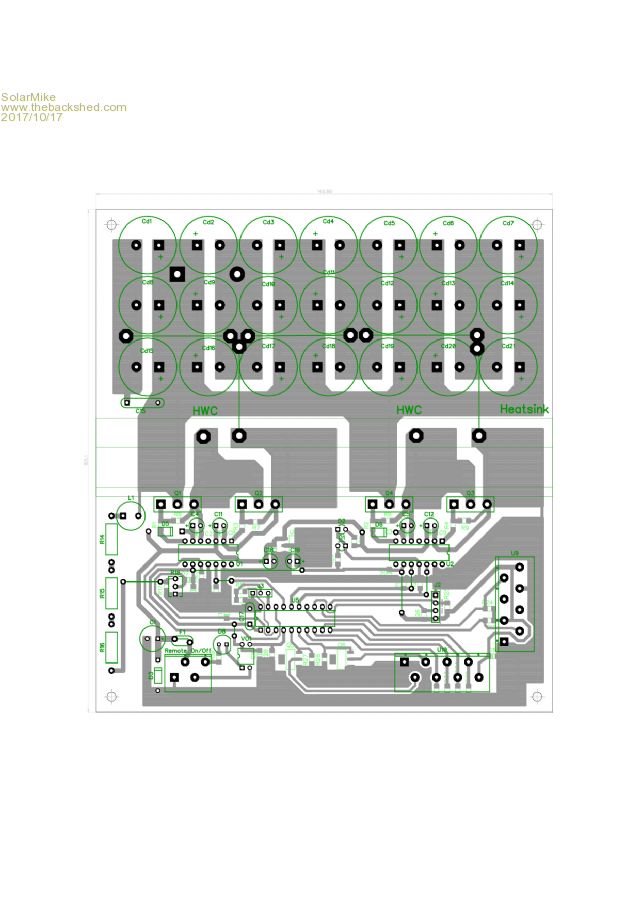

Posted: 02:19am 17 Oct 2017
PCB designed (165mm x 150mm), have allowed for 21 x 100uf or 150uf 450 volt caps in parallel to get the required total discharge current rating. Done as a single layer PCB for testing purposes, with several heavy duty jumber wires linking the caps and a few jumpers elsewhere.
Altered the bridge switching, so bottom halves now switch at 50Hz to keep the bootstrap caps charged up, top halves are modulated to switch at a rate as determind by the mppt panel voltage window on the capacitors, this varies with panel output under differing sunlight and temperature, if the panel output is weak the top half switching may be very slow, if full sunlight will be at several hundred Hz.
Have to build it up and do some tests on an old elctric jug and a big power supply; will be interesting to see if the AC squarewave transitions allow the normal thermostat to work without undue arcing and contact destruction.
