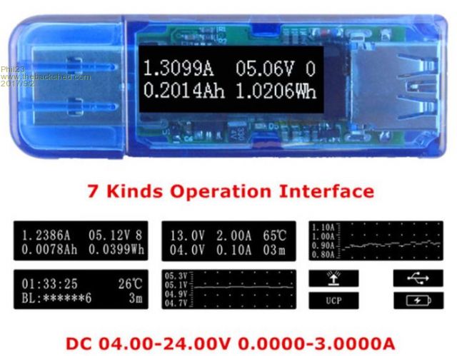

I've got a few of the inline USB Testers that measure Voltage/Current etc...
Just stumbled across these ones though; a bit more advanced.
Review here.
And a couple of listings, here and here.
Cheeers.

Phil,
Interesting - looks useful. I especially like the albeit limited graphing of the voltage and current.
Some time ago I purchased a simple similar device which just displays voltage and current. It does this quite well and accurately. What caught me out was that the signal lines are not connected through which makes it useless for seeing the current variation as the connected device is operated. I have been meaning to open it up and see if the connection can easily be made. Can't understand why they didn't do it.
