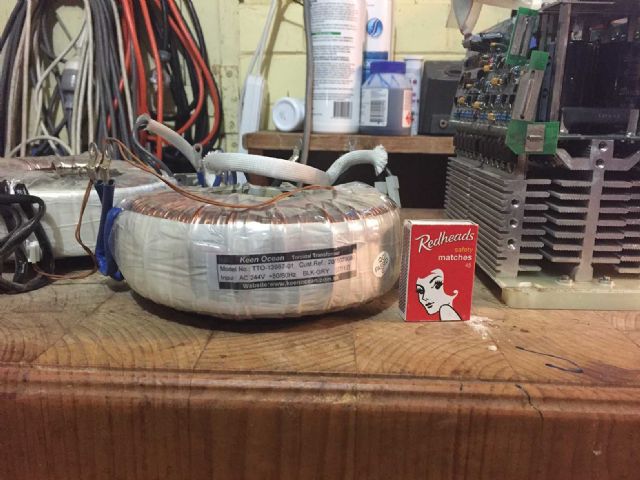

the transformers are tiny. Think 2 transformers, smaller than 1000VA Aerosharp units.

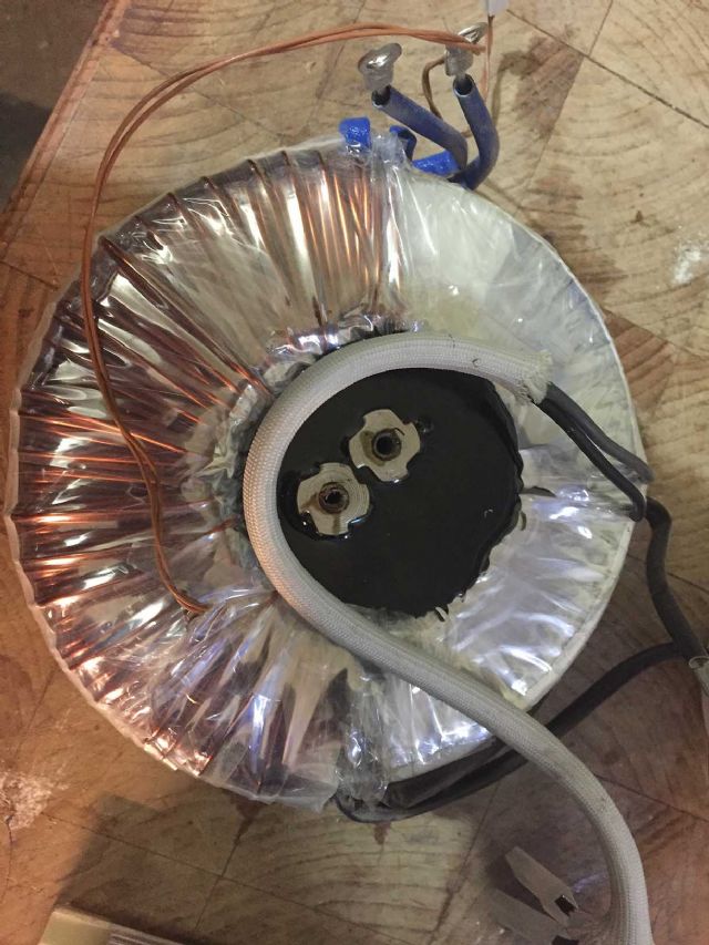

The transformers inside the Victron are very much like
these (Gumtree)
I think someone else has a failed Victron Multiplus

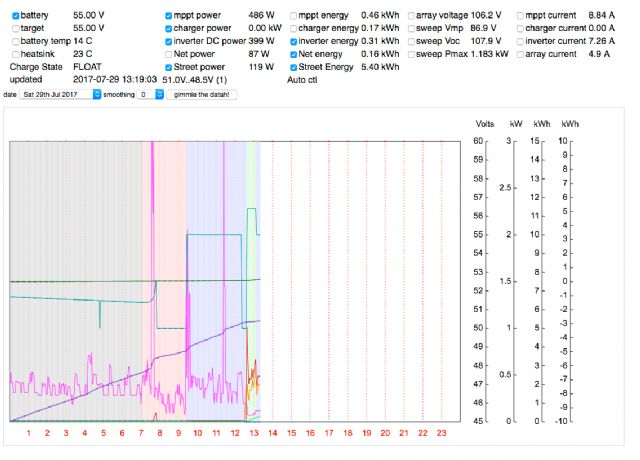

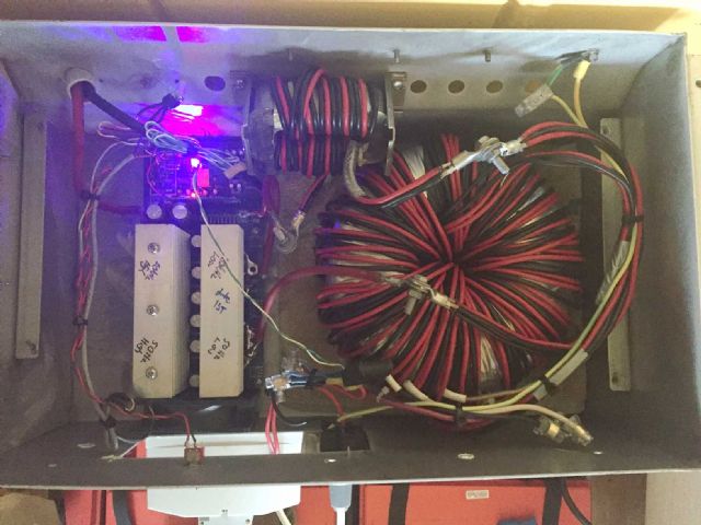

I have finally got the time and enthusiasm to complete the inverter.
It does the job.
The 10A 3 core output has 3 fridges, a fish tank, modem and router, imac and UPS, 2 laser printers, 2 macbooks, 3 monitors and more hanging off it.
As at the time of writing the inverter DC input current is 7.3A @ 55V so that's 400W
The heat sinks are still at ambient temp, the inductor winding the same as is the toriod's primary. The primary is 4 x 6mm2 copper. The inductor is 3 x 6mm2.
I2R losses at 400W would be small enough to accept.

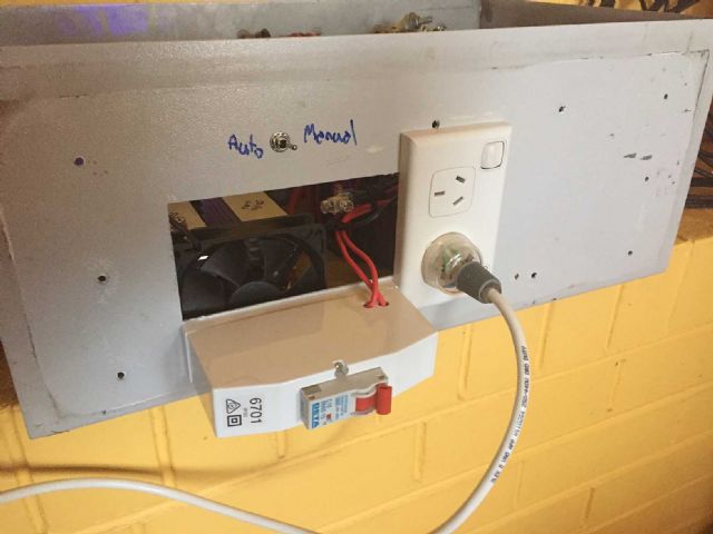

I use a Latronics Automatic Transfer Switch (ATS 40Amp) to automatically switch over the above detailed loads from inverter to street power when the battery voltage drops to a set point. And once the battery gets enough charge, the inverter is switched on again and the ATS senses this and changes over the AC source from street to inverter.
Possible failure scenario:
Should the street AC phase be inverted compared to the Victron AC output , the switch over even may be putting large current or voltage pulses into the Victron inverter.
This might have damaged the mosfets or their gate drives. The Victron did not have any street AC phase sense connected, and I think it has no facility for this anyway.
I will find out soon enough when I re-install the ATS and either see magic smoke or not from the inverter board. At least the inverter board is repairable.

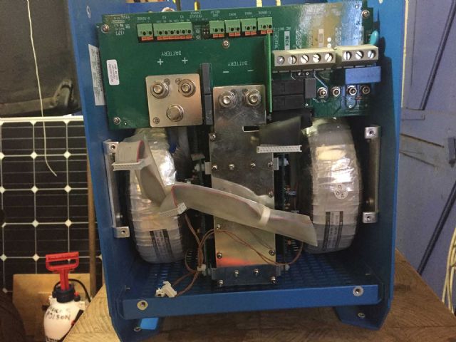

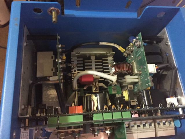

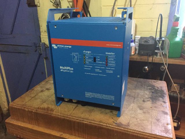

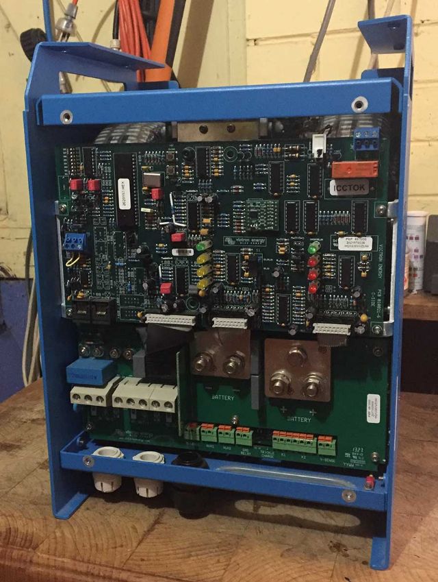

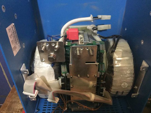

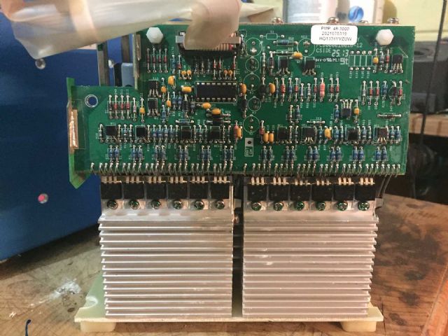

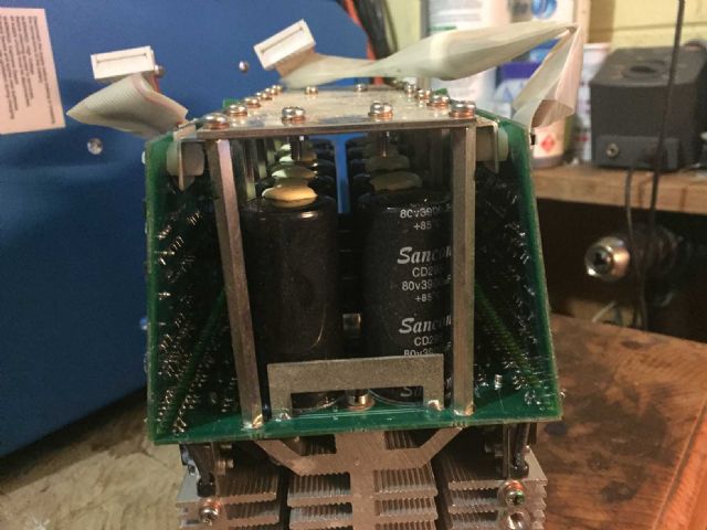

I pulled apart the Victron Multiplus 3000 inverter/charger.
Let's see how many photos I can post...
The useless Blue box.
main control board. All through-hole.

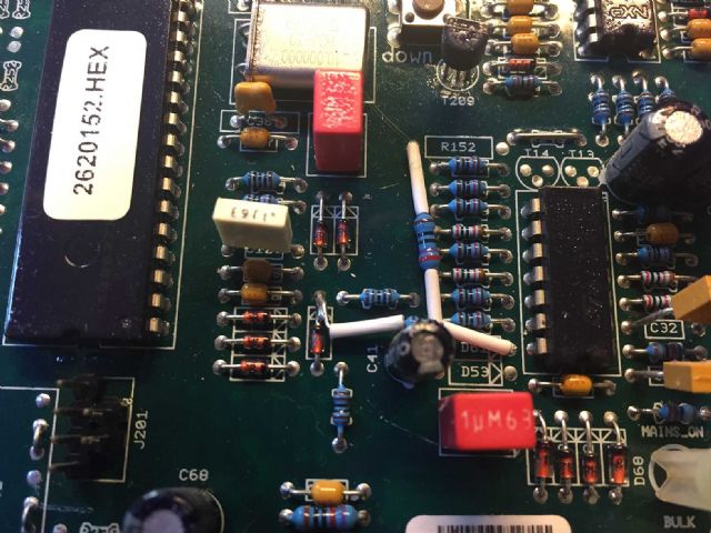

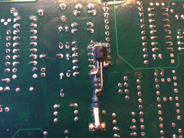

some bodge jobs, front and back of board.

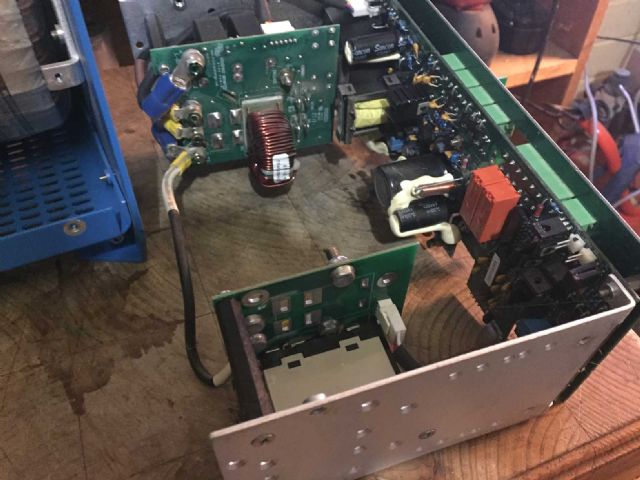

after control board removal, unit upside down.
view from top, yet more discrete stuff.
The view of the back side of it. This is the AC switching and charger switching control
At last we get to the mosfet full bridge and transformers
I don't recall subletting the inverter to this guy..
one half of the full bridge gate drive. Oh my God.
(we now achieve great gate drive via $7 chips and a few components.)

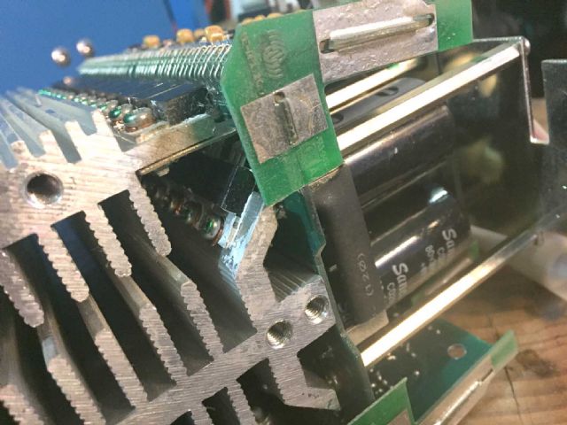

10 big DC bus caps all in a row.
4 rows of 12 mosfets. Fairchild (OnSemi) F75646p mosfets datasheet
The star of the show, at last. The transformer(s)
only wound 1/2 of circumference, I wonder why. Probably a lesson there.
size comparison to a box of Hansons. In the real world these toroids are 1/2 as high and a bit smaller in diameter than the 1000VA Aerosharp.
The inverter used one only transformer for low loads and switched in the second one
for higher loads.
There is no way I will spend any time looking at why it failed.
Also, I don't have the skills to understand let alone repair
this complex lump of rubbish. To my eyes it looks 15 years old obsolete.
The transformers might be worth keeping.
Time to get back to working on the important things in life.Edited by poida 2017-07-30

I was wondering about the 1/2 circumference wound primary on the two transformers.
the reason is here
http://ieeexplore.ieee.org/document/6473895/
"Toroidal transformers are commonly used in power electronics applications when the volume or weight of a component is at a premium. There are many applications that require toroidal transformers with a specific leakage inductance value. A transformer with a large (or tuned) leakage inductance can be used to eliminate a (series) filter inductor. In this paper, a procedure to control the leakage inductance of toroidal transformers by leaving unwound sectors in the winding is presented."
you can read it here
And that 'splains why I did not see any primary inductor. It's not needed.
My LCR meter shows about 204uH at 100Hz into the primary with the secondary shorted.
I hooked it up to the prototype inverter board and it runs fine (and very quiet) without a primary choke. At 48V DC it needs 0.2A at idle and 230VAC output. 9.6W not bad. With a 166W load, I find 93% efficiency but given the small primary wire area I think things will go downhill fast with +1000W loads.
There are 2 x 2.3mm diameter single copper wires for the primary.
This is 8.3mm2. When both transformers are running it's 16.6mm2
Not a lot where we come from.
Edited by poida 2017-07-31
