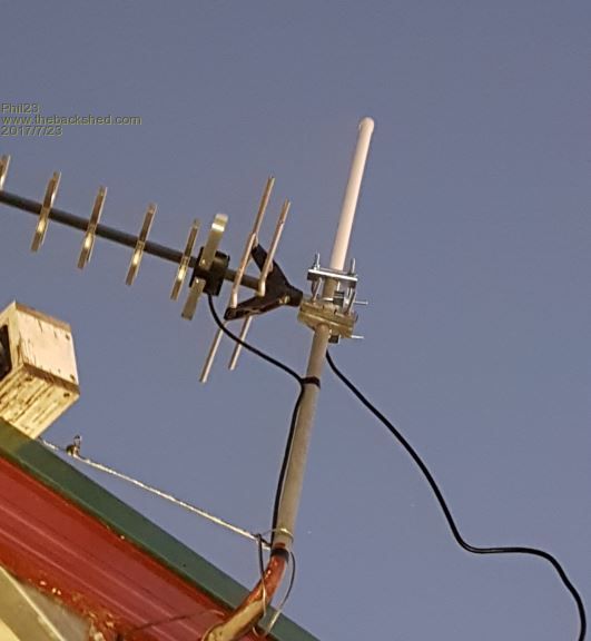

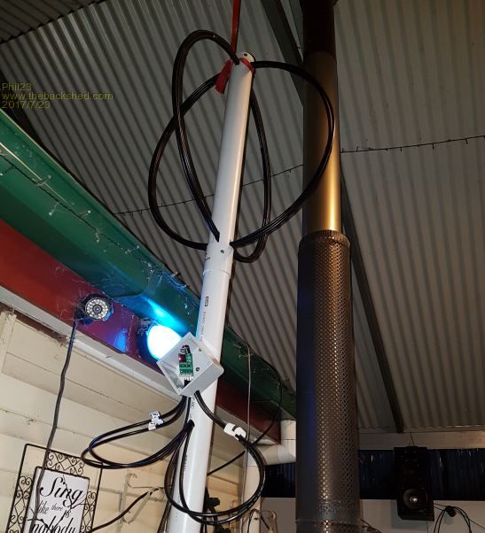

Two Antennas, consisting of 4 Turns of RG6 Quad Core, in a 600mm diameter Moebius Loop.
Feeding a Blitzortung Lightning Detector.
Also has a 150mm Vertical Probe (2nd Pic).
It's currently picking up strikes in the Tasman Sea between Bass Straight & New Zealand, so the design must be working.

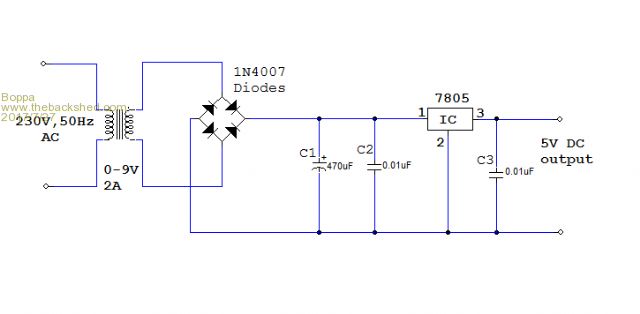

Using the circuit below, you can make your own 'old fashioned transformer driven' 5vDC supply either using a transformer if you are confident of your ability to solder and handle mains voltages, or if you are squeamish about touching anything to do with the mains, use a 9VAC 2A plugpack (wallwart) and put the rest in a box on the end of its lead
eg of a 9VAC 2A transformer suitable for 5vdc supply (Note needs to be mounted in a box with suitable fixings and quality workmanship)
9VAC 2A transformer
or toroid 9-0-9VAC 2.22A transformer (same goes, must be in box, proper mains construction techniques required)
9-0-9VAC 2.22A
for those not happy with playing with mains, use something like this- note this one only has a 1A supply, so will result in reduced output, any 9VAC plugpack with 2A or higher output will give full output from circuit below
9VAC 1A plugpack
Of course those in 110VAC countries would have to use 110VAC 9VAC transformer or 'wallwarts' rather than our 230VAC 9VAC transformer or plugpacks lol
Circuit to build to give 5VDC, no switchmode noise and very little supply noise at all- can be built on perf board, tag strip or even point to point wiring and mounted in a small plastic box
(note +5v is at the right top rail, 0v is at the right bottom rail)
Personally I would use a small bridge rectifier rather than the 4x in4007 diodes as its easier to mount. This circuit with suitable transformer (2A) and a small flag style heatsink on the 7805 will give a 1.5A fully smoothed 5vDC supply, overload and overheat resistant (the 7805 will auto shutdown in either case)

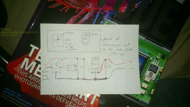

edit to add quick sketch of how to wire up
note plugpack leads are on the left- doesnt matter which way around they go...
output is on the right, suggest using short length of red and black fig8 cable
if you do use point to point or birdsnest wiring, I suggest so they cant move around or short out using hot melt glue or 2 part epoxy to glue each component down, another suggestion is use small heatshrink to cover all exposed metal leads and solder joints

Thanks for that.
Was a bit rusty on the correct values for the circuit etc.
