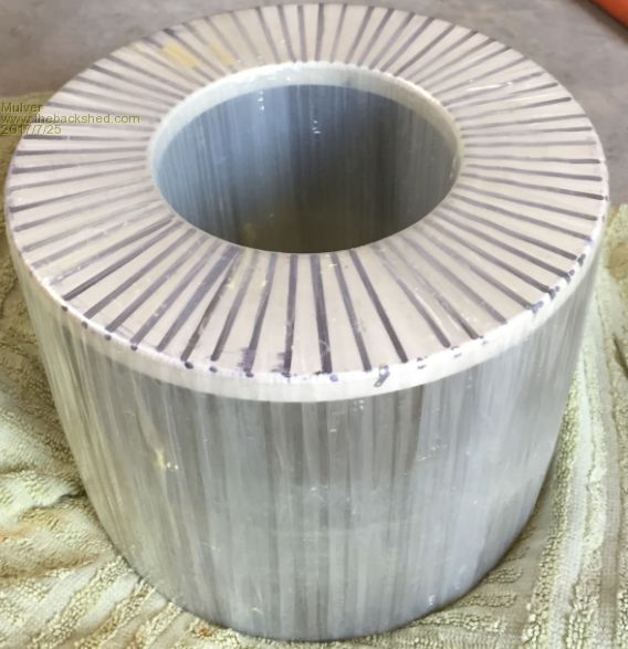

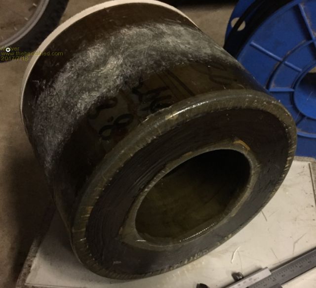

I have 2 x OD 190mm x ID 100mm x 70mm high toroids from 3kw Aerosharps they have been glassed together (another first for me too) and are almost ready for a mylar wrap and then the first winding.

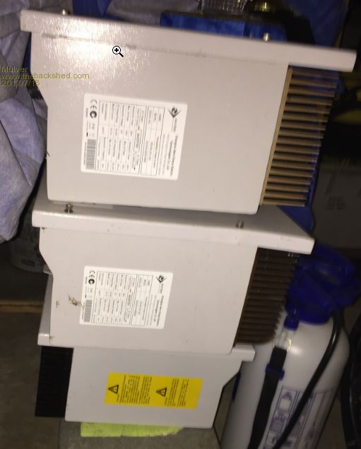

The beast!
2x 3kw not yet tested, and a 1.5kw that faults out, its done a few hours so will probably be gutted.

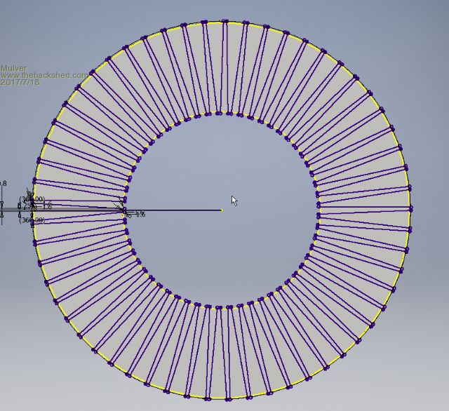

My winding guide.

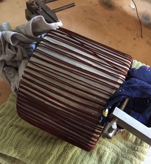

2 layers of Mylar, Heat gun works a treat for removing crinkles in second hand mylar after winding it on.

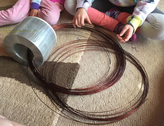

My winding helpers, yes that's how i wound it on, a little tricky! You must back bend to get the wire laying on the toroid. It did wear my hands out after completing 130turns
Finished first layer of 130 turns, starting to epoxy the winding.

It looks good so far.... and I am in awe at your training ability... two little helpers that actually help.... thats abnormally good.
