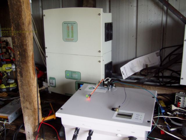

Well Mad, this is going just too well.
I left it connected up last night, and it woke itself up as it should, and just went to work.

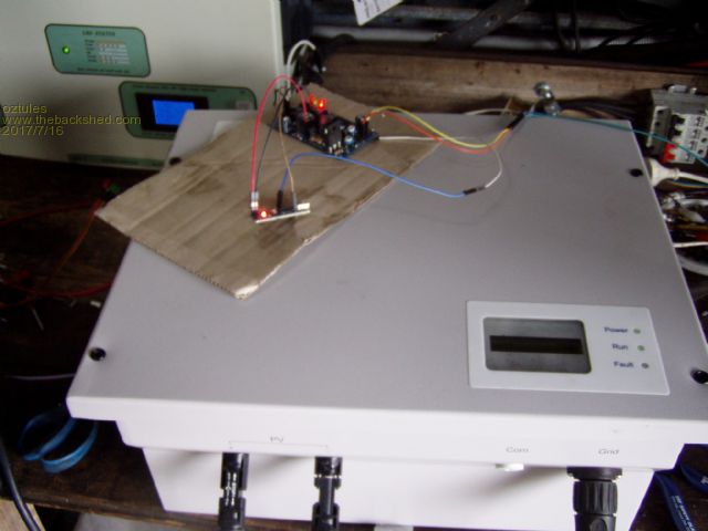

Here are some pics of the setup.
This is the current inverter under test for yet another site... there are quite a number out there now with thousands of hours collectively.... pretty well tested now.... under real house conditions in all kinds of environments.

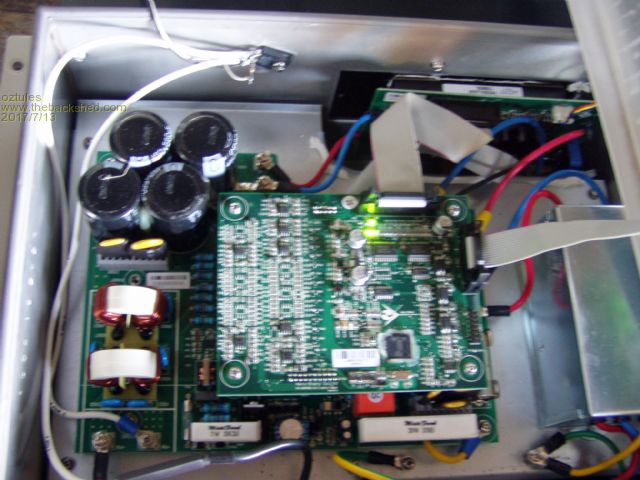

The GTI is a stock aerosharp 1.5kw unit... only mod is a fet stuck to the back wall, interrupting the neg terminal from the solar neg to the board itself. The input caps are doing any filtering required.
Somehow ( and i don't quite know yet) it keeps the GTI circuits alive while i was fiddling with the control pot, which would have shut all DC power off i would have thought.... but it must leak some hF dc through, as it stays alive, and the caps stay at 150v... threshold before trying to grid connect..... don't know how yet.

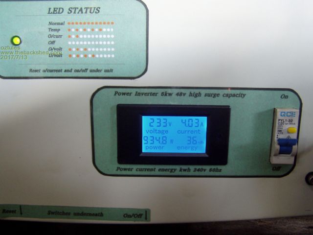

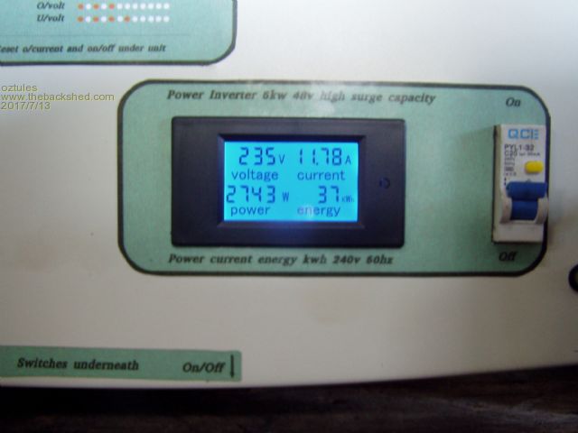

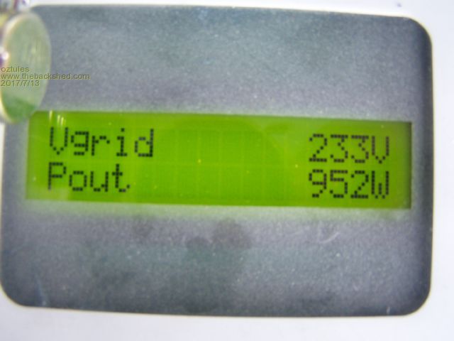

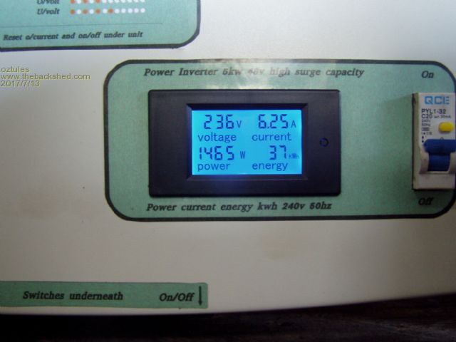

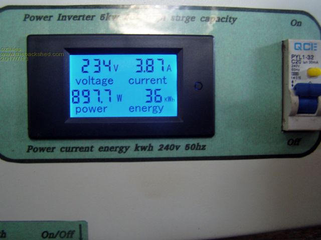

Anyhow, here is the voltage gauge on the main inverter, all AC output is turned off, so anything coming in goes to the batteries...... and the main DC solar controller is set to only 54v, so is not helping in any way to charge the batts.... they are standing at around 56.6v under thi9s test. I have set the off at 57v, so it should taper in about an hour or so.
and another go.....

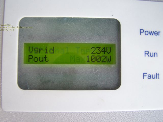

Here is the output screen from the aerosharp... the pics are taken close together, but not close enough for definitive power relationships to be accurately computed... but roughly speaking, there seems to be about a 40- 50 watt difference at the 850 watt range, so 5-6% losses in the system at that level... probably get better as the power goes up from there.... will have to check later in the evening to see how it runs at very low inputs.

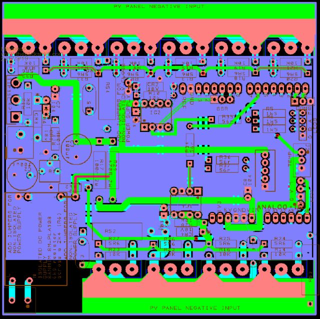

Here is a pic of my 48v control card that is used in the normal solar controller. It can easily run 10 IRF4110 or similar.... here it is only driving a single fet, so it is a doddle.
So for the aerosharps at least , they seem to not mind the control of the panel power. There is no difference to operation apart from less power if I turn the pot down to say 55v, and it pwm's the controller... the GTI just follows perfectly..... hope this continues in this vein.

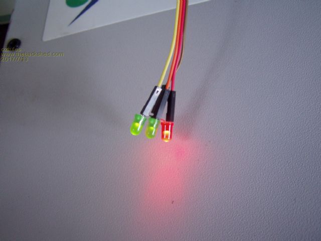

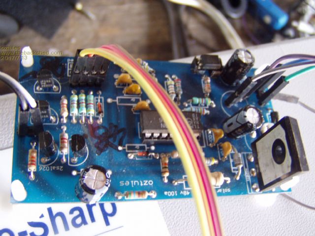

Here we have the led lights attatched to the gti controller, three lights means that we have float conditions... ie on, charge and float all together, means it is rattling around between all three very fast.

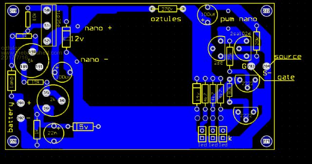

It measures the input signal ( from an AC tranny or battery voltage in this case) and puts that against a zener voltage in a comparator. This comparator sends the output to another comparator that has a triangular wave form on one input, and the result of the voltage switch ( previous comparator). The level of this voltage , against the triangle forms the pwm wave. This goes to a high power totem pole and out to the remotely mounted fet....A third comparator in the chip makes the triangle wave train.
This fet can be seen in this picture, it has a gate zenner to protect it from me, a 10k gate pull down resistor and a 56r gate resistor if your wondering what is on the pins.... fuzzy I know....
The 1.5kw array managed to get up to well over a kilowatt at one point, so the on off was pretty savage when i was messing about with it.
Seems a pretty efficient way of charging the batts.

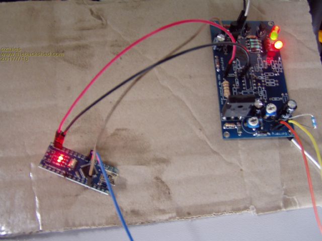

Mad, did a little program last night to drive that fet from the arduino... will have to build the nano board and totem pole driver for the output. It combines the bulk, absorb and float and is probably a poor analog of the commercial ones .... although i cant see how much different they could do it realisticlly.

Ok Mad,
This will show you how bad I am at programming the arduino...
Same as i don't do schematics, and just cobble together a circuit on the pcb program my programming is worse... no flow diagrams... just start typing.... and it shows too.
Real programmers may suffer hysterics... read at your own peril
I stole the pwm example function from the arduino site... and then worked out the if statement i think.... will be interested how or what it really does when unleashed on the GTI.
I do this so rarely, that I have to start from scratch each time... bummer really.
So this is what I think will work in some manner yet to be seen.
It compiles at least... first hurdle over.

After a ninetieth birthday do yesterday and well into the night, i have not had a chance to try it out will do in the next hour or so as the head clears from the celebrations....
I have just finished marrying the nano to one of the normal boards shown in the pics above. By just removing the analog bits, leaves the power supply, divider, output totems all ready to hook into the nano with 4 wires... so did that.
loaded into the chip, and ran it on the CRO.... just needed to catch the over flow properly on the 0-255 pwm.... i put the catch all in the wrong part of the routines....
Apart from that, it looks very nice. the waveform smoothly tries to adjust and all looks good... thats the main loop, will look at the absorb and float after seeing the main loop on the real thing.
Should know a lot more in a few hours i guess.

and this from a distance
Thanks for trying Mad, this should be easier to deal with I hope.... my programming style is erratic and strange.
......oztulesEdited by oztules 2017-07-17

Yes, I have just modified the normal 48v analog controller board as I have a 15 of them... will send you some if you want.
The nano will just be glued to the empty space in the center, and has 4 leads going to the board...and two to the fet
plus12v....
gate drive to the fet
Source lead to fet ( neg )
negative/gnd
pwm to the totems
bat plus from the divider.
Thats it.
Here is the pic of the board.... the print to pdf is not set up in this linux at the moment.... just another install..... so a pic will have to do .
edit: the 12v zener... I actually use 18v coz I have a bundle of them... the nano is happy up to 20v. So if you choose the 12, you will have to adjust the 270r resistor to keep at least 11-12v for the totem driver to keep the fet turned on or off properly.
..... oztulesEdited by oztules 2017-07-17
