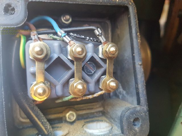

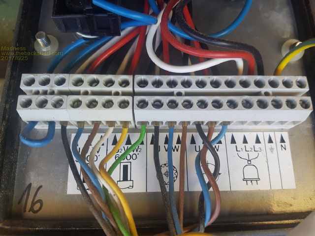

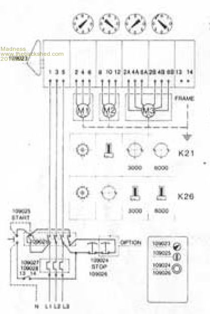

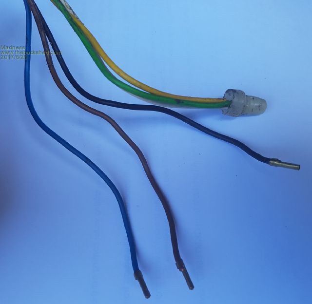

Posted: 03:24pm 24 Jun 2017
Still waiting for the VFD to arrive via Fastway was sent Wednesday tracking says still between Melbourne and Sunshine Coast. From past experience, Slowway might be a better name for them.
All 3 motors are setup differently, first motor on the planer was dead simple to change to Delta.
Next the saw motor took slightly longer to figure out, it simply has 6 wires coming out with 3 joined together, I separated them and just need to rewire them correctly for delta.
Brown - Yellow = 1 winding
Black - Green = 2nd winding
Blue - White = 3rd winding.

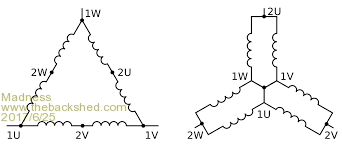

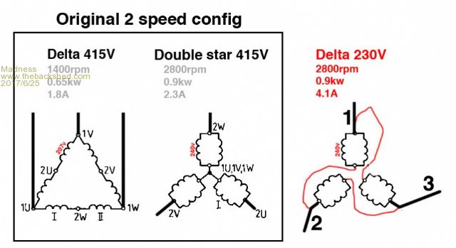

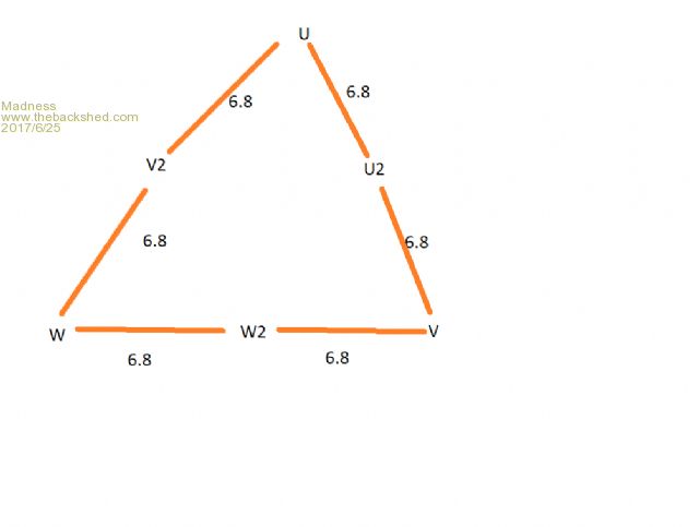

The 2 speed motor for the spindle moulder is a bit more involved, from what I can figure out it is a Dahlander configuration like this.
There is no simple external way to change it to 240V Delta from what I have found. It needs to have each of the Delta windings legs changed from series to parallel, as per this diagram.
These are the connections of my motor 6.8 ohms on each winding, it seems odd that the W2 and U2 seem to be swapped around.
This is the resistances I get between terminals
U - U2 6.8
U - V2 6.8
U - W2 12.2
V - V2 12.2
V - W2 6.8
V - U2 6.8
W - W2 6.8
W - U2 12.2
W - V2 6.8
Next step is to get the motor out and disassembled to see if I can perform the required surgery on it. Changing it to 240 Delta will eliminate it's 2 speed capability which is no problem as the VFD will provide variable speed.

I'm guessing 6 wires on the left of the first picture are the ones in question.... it looks simple to just connect the wires coming from the motor at this junction, the wires coming from the dual switch are confusing the issue. so just using the wires coming from the bottom of the pic, and throwing away the ones coming from the top.
ie if you connect at the white multi terminal block say 1W to 2V and 1V to 2U and 1U to 2W... then the 3ph from the vfd to 2W,2U and2V, you should have what you want right there.
Warp, I suspect his is 240v 1phase in 240v 3 ph out.

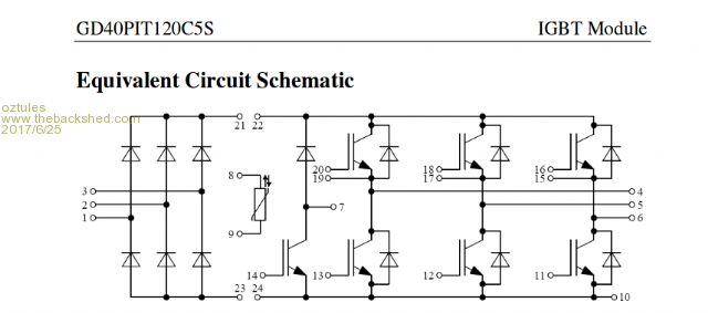

No, the ones I have worked on are not like that.
I spent $700 on a bigger unit, and proceeded to blow it up in the first 5 mins.
It used a big intergrated H bridge ( 1200v 40 amps ) and incorporated the bridge as well in the same package.... learnt a lot from that
I could only make 1.414X the input AC rms voltage... it's package was this thing
So it is only the 340vdc not + and - rail.... thus only 240v 3 phase was possible.
My 240v 3 phase is 240v phase to phase. There is no neutral available unless you use a transformer..... sorry for any mix up, but I thought thats how we would use the terminology.
........oztules
Posted: 06:41pm 24 Jun 2017
I understood this was going to be run off 240v single phase from an off grid system ?
Now you are talking about a high power VFD driven from a three phase supply.
Anything more than about 2Hp will require a three phase input.
If all you have is a single phase supply coming from an inverter, the way I suggested is the ONLY way it can possibly work.
My own VFDs I use at home all run from 415v three phase without a neutral exactly as you suggest. I used to work for a company as a field engineer repairing VFDs, so I do know something of how they work.

I am going to be running from a single phase 240V supply, all the information I have seen on this type of VFD say you must change the motors to 220/240V delta configuration. To run at the 380/415 requires 3 phase supply of the same voltage or a step up transformer.
All 3 motors in this machine are rated at 2.2KW, the VFD I have coming is 3.7KW. The seller has assured me it will handle it's full rated power continuously.
Oz I have been trawling through the net and see a lot of talk of lathes with the same type of 2 speed motor, I have read that you can run it without rewiring but with 29 hz as the base speed. However, this results in reduced HP. But you can believe everything you read on the Internet, so I welcome any input.
Posted: 08:03pm 24 Jun 2017
Ah, yes now I see what you are doing. That will certainly work.
Its a bit unusual because it requires non standard voltage motors.
I have seen very small drives run the way I suggested to use standard motors but only up to about 2HP because the single phase current becomes too high for a normal power outlet above that.
