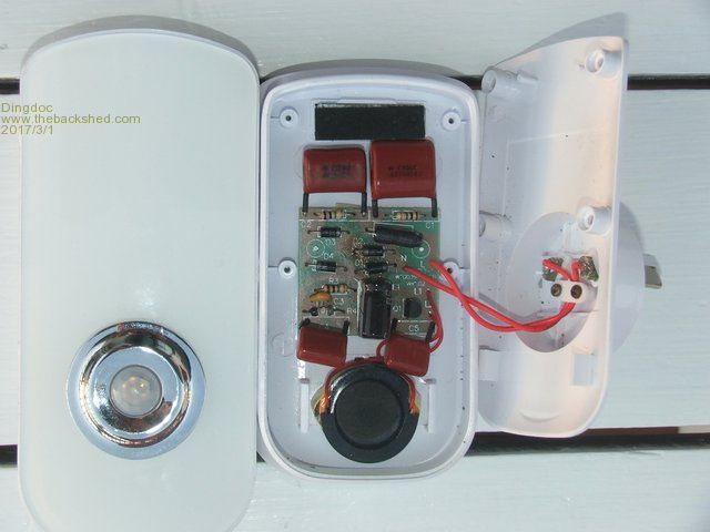

Recently I was asked to see if I could fix a 'Click' nightlight/torch unit which had stopped working. It has an inductive mains charger cradle which holds the light unit and keeps its lithium battery charged until needed.

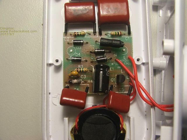

It seems that the electro filter capacitor in the charger dropped its bundle causing the emitter resistor in the oscillator for the coil to overheat and burn out.

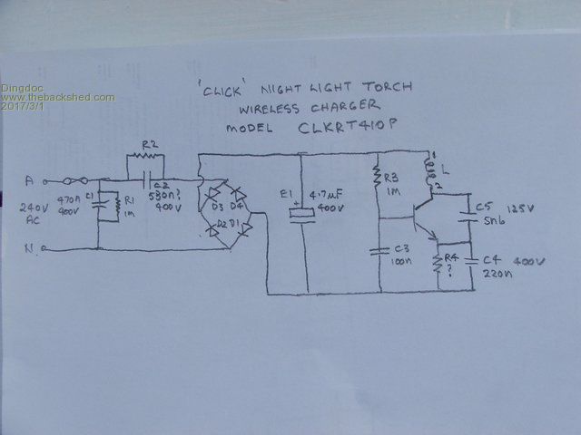

My problem is that the resistor is now black and grey with no colour bands so I have no idea of its value. I am reluctant to try various values as the charger circuit is at potentially mains voltage and the value is probably quite critical due to significant load changes when the torch unit is removed and replaced.
I have traced out and attached the charger transmit circuit and included a couple of photos in the hope that someone will either have one of these and can have a look inside or otherwise be able to deduce the value required for the cooked R4.

Forgot to give the transistor specs in the last post -
It's an MJE13001 400V (CEO) 750mW 200mA.
It looks like the whole circuit runs at a quite high voltage!
The inductor has a ferrite ring 'side-on' in the coil former to improve magnetic coupling with a similar 'secondary' coil in the torch.
Note that the cover is held on by 4 screws under plugs and hooks either side of the coil.

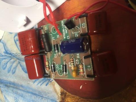

Friends in the city happened to have 2 of these , one of which had 'died' just like the one I already had, and they sent me a good clear photo of the internals as well as the dead unit!
So, the cooked resistor would appear to be 2k4!
This was easily replaced but a check of the electro and transistor revealed they were not too healthy so I ordered some replacements online.
When the parts arrived and were fitted it was dis-appointing to find the charger would still not work, but a check of the transistor with the component tester revealed that its pins were BEC instead of ECB like the original!
Once it was reversed everything worked as it should and I quickly had the second one working too.

I traced the circuit and used a circuit simulator to try different resistor values but the results were inconclusive, partly because I was just guessing the effective inductance of the coil (particularly when the torch is in place).
