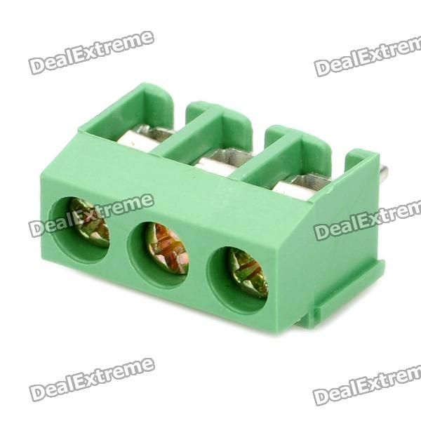

Anyhow these are the terminal blocks, and you can get them in either side entry for mounting your mosfets horizontally onto a flat heatsink.
Or the top entry blocks will allow the vertical mounting of your mosfets.
It saves a HUGE amount of work if you have a blow up, and you can remove test and replace mosfets many times without the circuit board killing unsoldering and resoldering process.

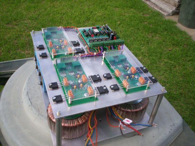

Here is an old picture of a project using flat mounted mosfets.
If I had to, I could replace all twelve of those devices in just a very few minutes.

My circuit board has tracks both sides with plated through holes. The terminal blocks just solder into the holes in the normal way, and connect to the tracks on both sides.
The power connections to each board are through the four 4mm nuts and bolts that you see, with bolted lugs underneath, connecting to +dc, -dc, ground, and output.
The large aluminium plate is completely cut away underneath the circuit boards,(except near the corners) so all the high power connections to the boards are made from underneath.
This is not the usual high frequency PWM type of sinewave inverter, but three individual low frequency square wave inverters with the outputs combined through transformers to produce a multi stepped output waveform. The output has 27 steps and looks like this compared to a true sinewave:
It looks totally different because it is totally different.
The large capacitors for the positive and negative high voltage supply are just peeking out from underneath the top aluminium plate at the back. This was all in the final stages of completion when I took the picture about a year ago. Its running right now and supplying all my power during the day, and has been for a long time with total reliability.

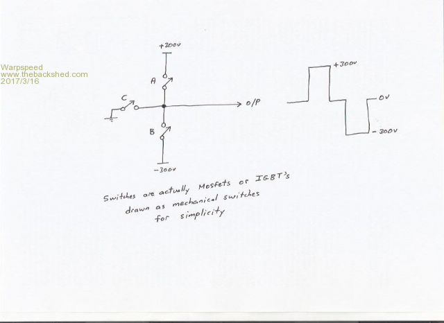

Three switches A, B, and C, three voltage levels.
We definitely need the third switch (C) because we cannot just open circuit the output with inductive loads. The lagging out of phase current must have a continuous path through the inverter with the output voltage at zero volts. Even with zero volts, there can be many amps still flowing through an inductive load.
So this is a simple functional diagram of our first #1 "Big" inverter :

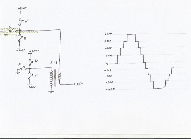

Now we build a second inverter, but this time with a voltage of only one third by using a 3:1 transformer to give us +100v, zero, or -100v.
Functional diagram with #2 "medium" inverter added. This now gives us three different but lower voltages with three more switches.
Combined we get nine (3x3) possible output voltages :

Yes, exactly.
Two inverter big/small waveform with 100v steps is still pretty rough, but its easy to explain.
small big
0v = 0v + 0v
+100v = +100v + 0v
+200v = -100v +300v
+300v = +0v +300v
+400v = +100v +300v
So there is a sequence that repeats up and then down for each half cycle.

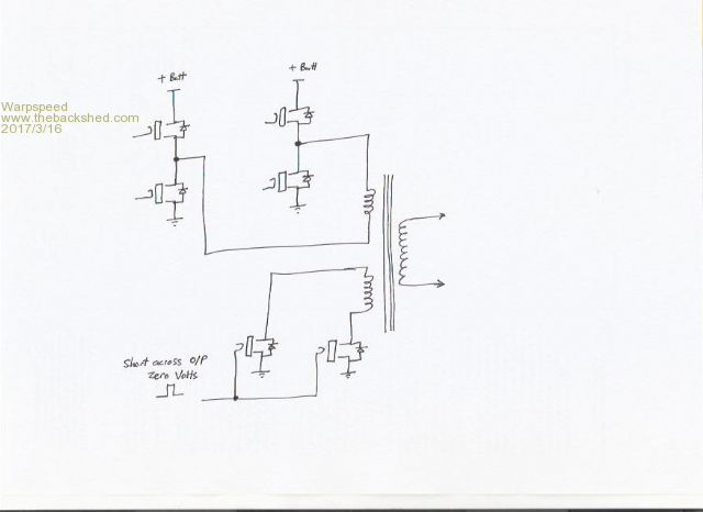

But you also need to short out each transformer when it is in the zero volts condition with a voltage clamp.
If you plan to use bridges for primary switching, a third winding on each transformer is probably the easiest way to do that. If you make it a fairly high voltage winding, the current will be lower, smaller mosfets will work, and it will provide a more efficient short across the secondary during the zero volt output condition.

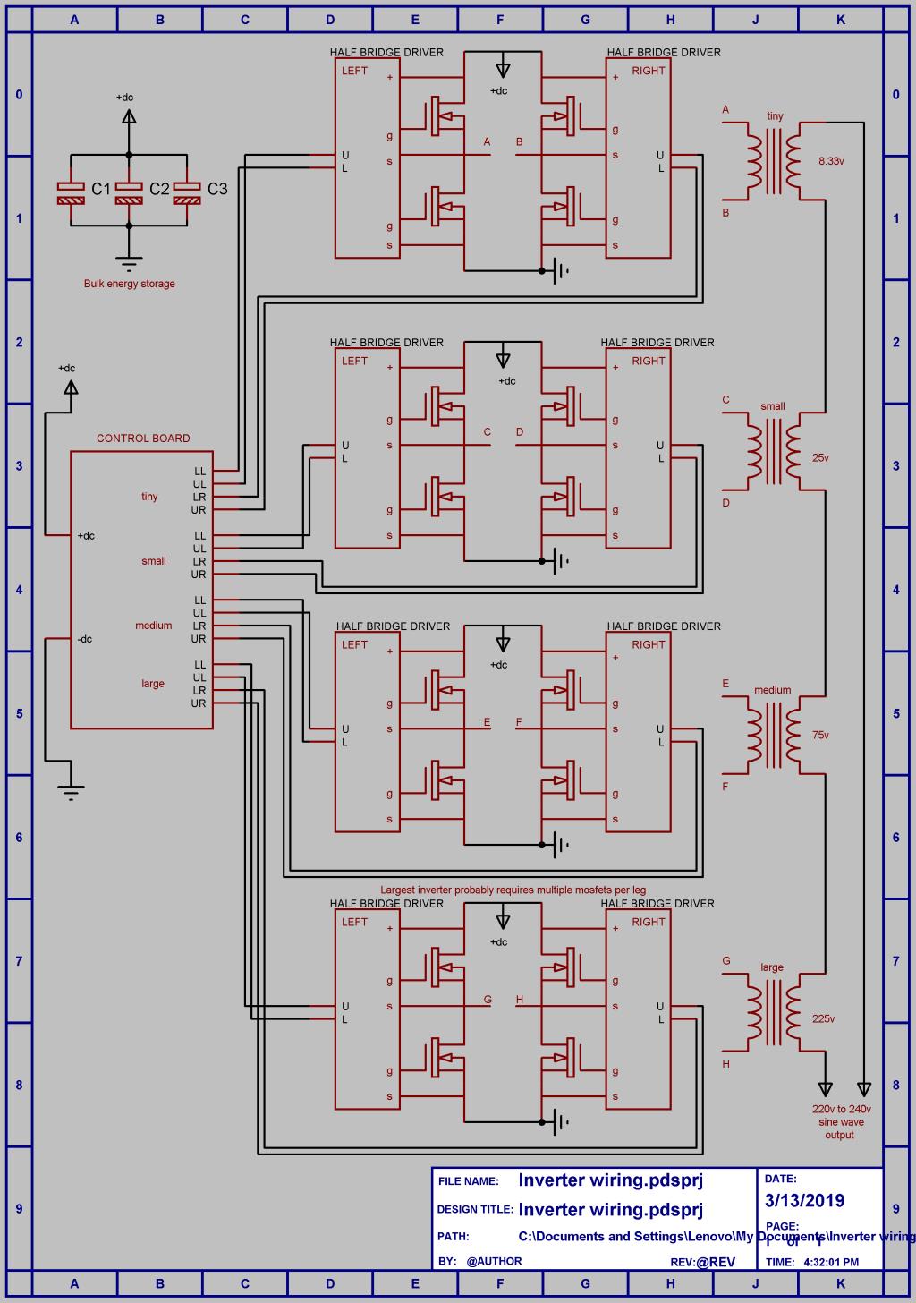

mackoffgrid
Joined: 13/03/2017
Posts: 460
Posted: 12:12am 16 Mar 2017
I'm a year or two away from house building again. At which time I'll be going nom. 48v system and much larger inverters - I want to be able start a car hoist, or compressor etc. (tempted to go higher in battery voltage but feel a bit insecure as in not being able to get off the shelf inverters , chargers in case i fail)
Currently have a nom 24v system, 3kw Latronic (working well) for the house and 8kw (haha) PowerJack that works for a while. I use it for pumping and HWS.
Do you see any evidence of the distortion in TV sets, stereo or other appliances with your current setup?
I've attached an updated schematic if you don't mind checking the scheme of it.
(I've shown back to back Nfets to short the windings - done this before but maybe not at this current)
How efficient are these compared to PWM models?
I don't expect much difference but I don't fully understand the affects of short those windings.
I'm guessing this would cost 20% to 25% more to build ~
But at the end of the day, still cheap compared to brand name inverters.

Posted: 12:29pm 16 Mar 2017
The clamping mosfets should have the sources tied together, and the open drain connections to do the clamping. There are several options with the clamping.
If you use a separate floating winding the sources of the clamping mosfets can both be grounded, which makes driving both gates through a two input NOR gate extremely simple. When both sides of the bridge are off, the clamp comes on.
You only need two data bits out of the EPROM, the clamp is driven via a NOR gate from those two data outputs. All with sufficient dead time provided of course.
This clamp could also be placed right between both sides of the bridge, or even directly across the secondary winding. Current will be much higher there though. But then the gate drive to the clamp needs to be fully isolated and independently powered.
It all works, but how best to do it is up to you. If you are winding your own transformers, its no big deal to add a third winding with plenty of turns to keep the current in the clamp low.
Providing isolated gate drive to a fully floating clamp not difficult, its only a few extra parts on the circuit board and no big deal.

Posted: 04:01pm 16 Mar 2017
O/k, the problem with high frequency PWM is mainly the very high switching frequency required, and all the problems with that including stray inductances, grounding, layout, and getting multiple mosfets to not only current share, but switch simultaneously in a controlled way.
It looks easy getting ten mosfets to switch 200 amps. But what if just one mosfet turns on slightly ahead the other nine, or is the very last one to turn off carrying all of the current before it can do so ?
When you drive a high voltage transformer with a large step up ratio, there will be a lot of stray capacitance associated with the high voltage secondary. This capacitance has to charge and discharge every PWM cycle at high frequency. There is nothing much to limit peak currents during actual switching. Also, its not uncommon with an inductive load to have a high current flowing through the mosfets that are off, in the reverse direction through the internal source drain diodes.
These inverse diodes are sometimes have fairly slow recovery times.
When the opposite pair of mosfets turn on, there can be a very high reverse recovery current spike which can cause us some real problems.
Its not as easy as it looks.
All the same problems exist switching at 50Hz that occur at 20Khz, but the less frequent occurrence means the effects are less dramatic and potentially a lot less destructive.
Now about transformers............
I am using +/- 235 volt dc rails coming strait out of my MPPT solar controller during the day, and at night from a grid powered transformer rectifier.
No battery as yet.
This does not require a transformer for the #1 large inverter.

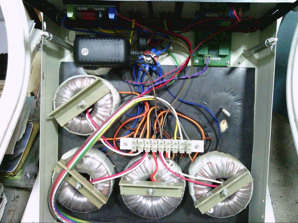

Taking the #3 small inverter first, ideally it requires a 9:1 ratio, and the secondary current should be the same as the inverter output current rating.
I am using a transformer from Altronics part number M5525.
It has a 230 volt primary and a 25 volt secondary rated at 12 amps (300Va)
The ratio works out to 230/25 = 9.2 That is at full load. At less load, the output voltage will be very slightly more, and the ratio very slightly less.
In any case, it the best transformer I could find to get as close to the optimum 9:1 ratio.
Now the #2 medium transformer needs to be exactly three times the voltage and three times the power at the same rated secondary current.
Haha, dead easy just use three more of the M5525 transformers.
All three primaries in parallel, the three secondaries in series giving 75 volts at 12 amps. Its also a lot easier to package three 300Va toroids than one 900Va toroid even if I could get one with 75v 12amp secondary.
The #4 transformer needs to be 27:1 still at 12 Amps.
I used a M5309 which is rated 9v at 17.8 amps. It should really be 8.5 volts, but by wrapping one turn back around the core the wrong way I lowered the voltage slightly.
Anyhow with four 300Va transformers and one 160Va transformer I get a 12 Amp inverter 2,880 watts continuous rating, and a lot more than that for short bursts.
Altronics also have 500 Va transformers that have the same voltages.
M5725 is 25v at 20A which would be ideal for a 4.8Kw inverter.
If you are going to make something to run off a low voltage battery you will probably need to wind something yourself. But the voltages are all low, both primary and secondary, except for the #1 big transformer.
With luck you can probably recycle a large toroid from a grid tie inverter that already has a 230 volt winding on it.
The transformer issue requires a bit of thought, but its not a difficult problem to overcome.
I was very fortunate that I could use unmodified off the shelf transformers, more luck than anything else.
Edited by Warpspeed 2017-03-18
Posted: 04:44pm 16 Mar 2017
Hi Warp,
Is there any reason preventing you from putting all the windings on one large Toroid and have multiple primaries?
Posted: 05:08pm 16 Mar 2017
It could work, and has been done but only for a very limited number of steps.
You would have to switch directly between voltage tappings on the primary.
The problem with that is you need a set of mosfets to drive every individual tap.
Not too bad if you only want a very few steps.
With tappings, every tap has to carry full rated power.
For 27 steps you would need 13 taps and thirteen mosfet bridges.
But by using three inverters with three bridges we triple the number of available steps for each additional inverter. Not only that, each successively smaller inverter shrinks to one third the size and power rating.
My prototype used three inverters and I only used six data bits in my Eprom.
I though what the hell, build a fourth inverter, its only about 100 watts and use all eight data bits and get 81 steps instead of 27.
To do that with tappings would require 40 taps !
