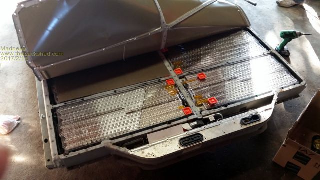

Tinker that is exactly what is in the Tesla cars and Power Wall, sound strange but it is true.
When I said you need a few thousand I was not over stating it.
Edited by Madness 2017-02-17

Thanks Madness, for that picture - I did not know they use tiny cells. Perhaps these make it easier to mold the battery into odd shapes.
But the connecting side looks like a nightmare. Perhaps a robotic assembly?

the tesla battery pack is basically flat, it forms the underfloor and part of the chassis. refereed to as a skateboard configuration.
2 rows of 7 modules and an extra pair stacked in front for the bigger 90 and 100kw pack to give a total of 16 modules.
unfortunately I am addicted to Bjorn Nyland's LOOOONG Vlogs about road tripping Tesla's, I have spent hours watching him charge those damn things.
I think the 100D charges to 402 volts and has 8,256 cells so that would be 86 cells parallel by 6 cells series per module. I was hoping it would be 7 cells in series because that would be a perfect 14 cell/ 56 volts with a pair of modules for our 48 volt systems.
