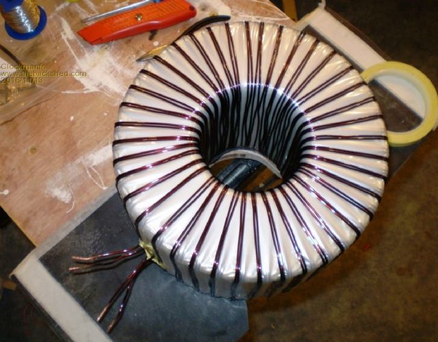

So I have a 38kg core, at 230mm OD, 100mm centre hole and 140mm thick/high.
80 turns of 6 off, 1.8mm diameter secondary and 10 turns of 1 off, 75mm/2 for the primary.
The 38kg core is heavy and awkward to lift and turn without damaging the enamelling on the windings. The first photo shows an amended winding table with sufficient space to safely get my fingers under the core and cleanly lift. There are 6 rubber mats cut out, each at 1.1mm thick taped to the table. This works well as the rubber gives and spreads the weight without collapsing or being to stiff.

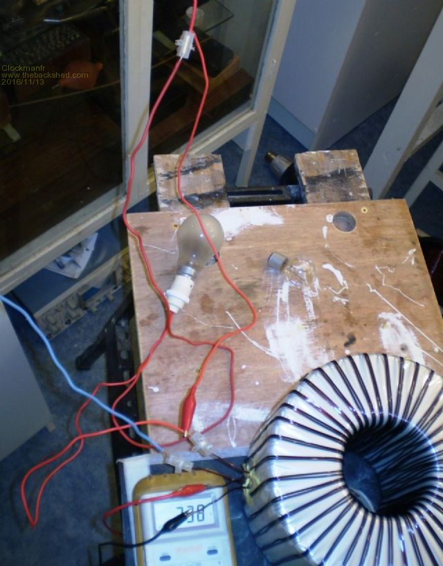

Differences with Testing the Secondary windings.
My normal 25w 230vac test bulb that I use on the 6kW OzInverters was just too small a wattage for the torroid to step up to full 230vac on each winding, and my workshop 20 amp MCB would trip out.
However, replacing the 25w with a 100w 230vac test bulb works fine, as the interim step for the each secondary taking a full 230vac. But be warned the 100w bulb will not illuminate, the toroid seems to want everything.
These first 2 secondary windings are fine and each gives the same Induced voltage readings.
The Photo shows the 100w bulb that is now bypassed with that insulated croc clip, so the toroid first secondary winding is taking the full 238vac Mains, and inducing 238vac in the second secondary winding. And Yes, I will tidy up the windings before I resin coat them, but I always test first.
WARNING. Yes I should no better!
230vac is serious and will probably KILL you, so be very very careful. Check and double check.

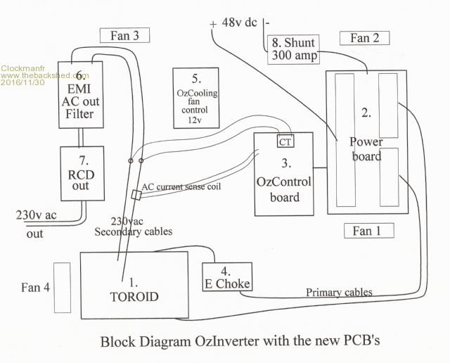

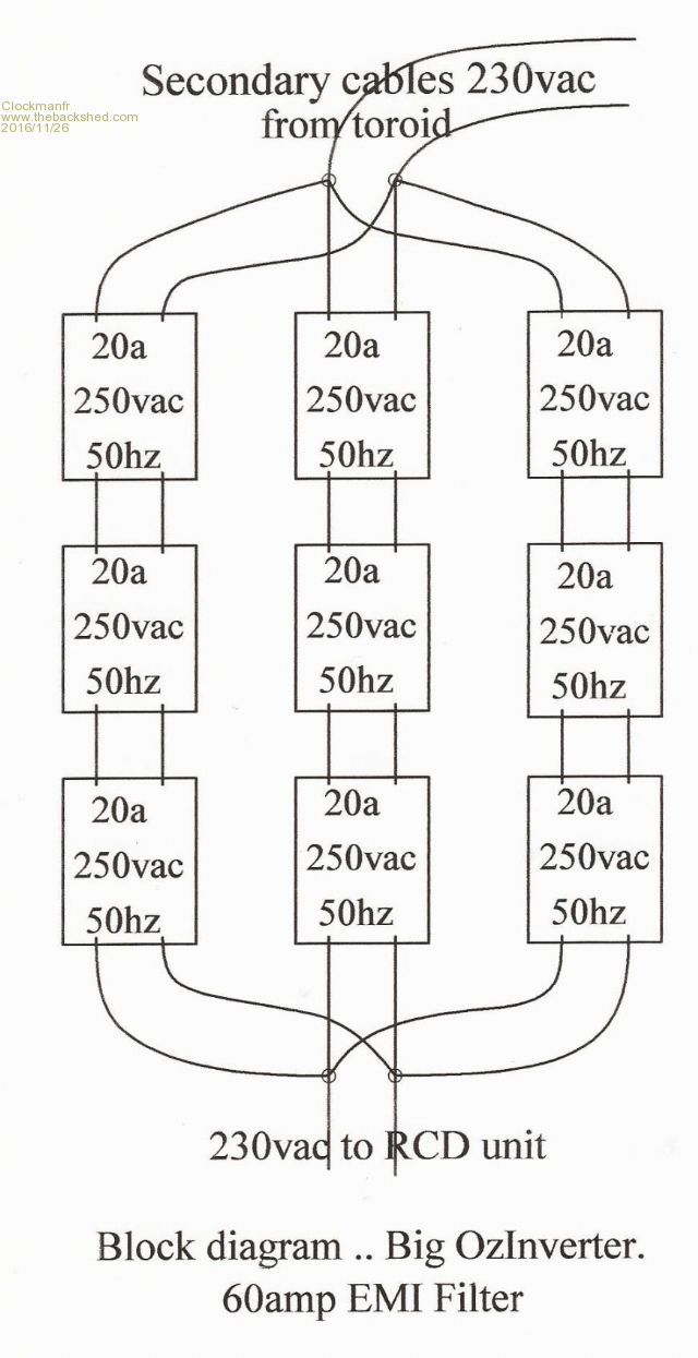

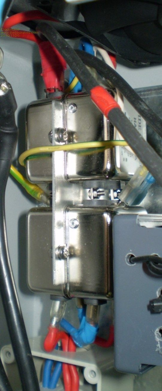

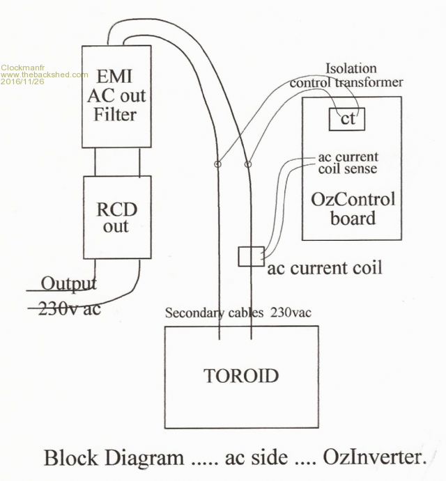

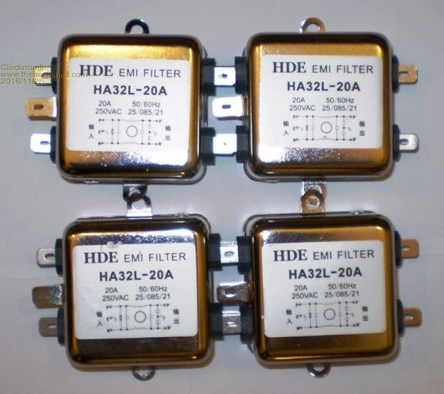

Just some clarification required, regards my new 60 amp EMI Filter on the 230vac output from my BigOzInverter.
I have been happy with the 4 unit arrangement and this works well on the 6kW OzInverter.
Here is my Block diagram regards the design of the triple unit, 9off, and connection system. This okay?
Clockmanfr
Joined: 23/10/2015
Posts: 437

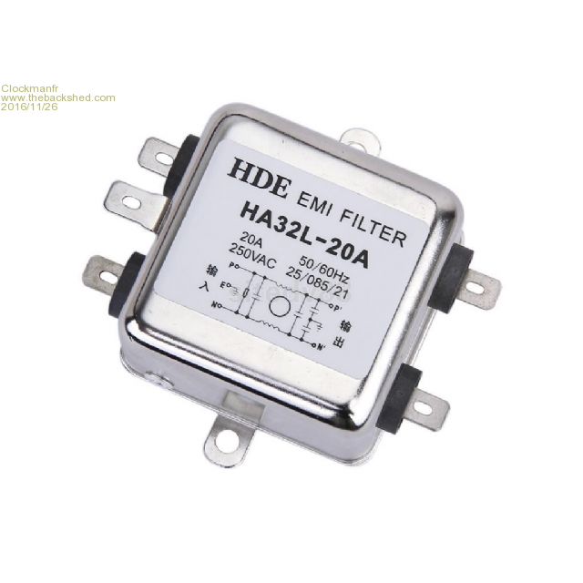

Posted: 08:38am 26 Nov 2016
For clarification, here is my Block diagram for the 230vac side of the OzInverter.
I will amend and add this into the OzInverter Book.
NOTE, those 20a 250vac 50Hz EMI Filter units are about $7 each, 9off for my big filter unit would be about $63, which is not to bad.
Edited by Clockmanfr 2016-11-27
oztules
Joined: 26/07/2007
Posts: 1686
Posted: 12:55pm 26 Nov 2016
Well that should filter out some noise.
Front loader washing machines with older series wound motors need a filter on the output so as to run their spin cycles properly.... and yep, that would do it.
......oztules

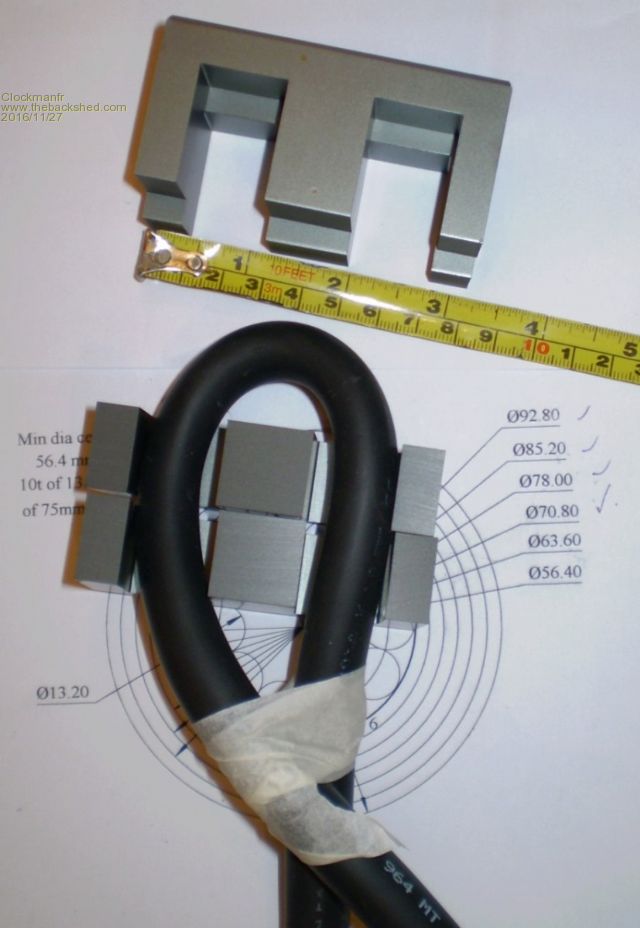

The Ferrite core.
On one of the two Primary cables from the Toroid.
Brings the idle power loss right down, for a 6kW about 35watts.
My Primary cable for this BigOzInverter is 70mm/2 and here I am using very flexible welding cable at 18mm/ 3/4inch diameter, wrapped around the 20mm x 40mm x 56mm long centre section of the ferrite core. 3 complete turns is ideal, 4 is a little better but not worth the extra hassle involved.
Here I am using 2off these cores stuck together with super glue or resin…… .. http://www.ebay.co.uk/itm/370683164776?_trksid=p2057872.m2749.l2649&ssPageName=STRK%3AMEBIDX%3AIT

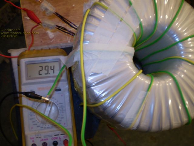

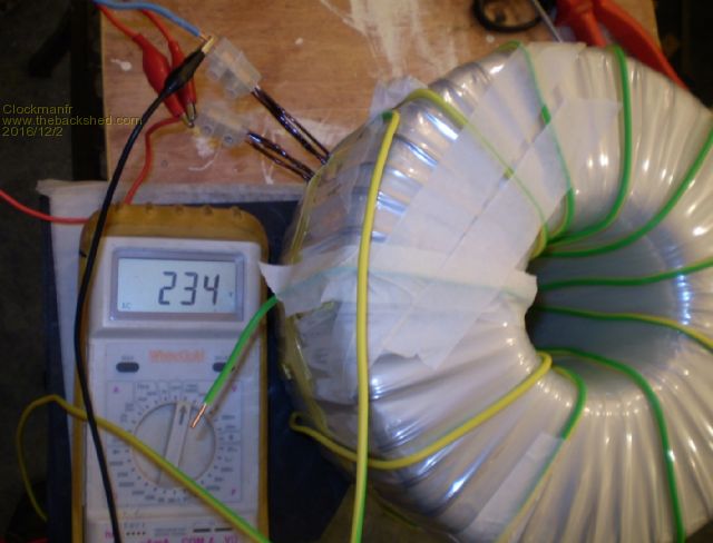

Here you are Mason,
'Oztules' calculations work in the real World......
This is for the 8010 OzControl Board where we want 28v to 30v.
Test.....234vac going in to the secondary windings 80 turns, and 29.4vac coming out of the 10 turn Primary.
