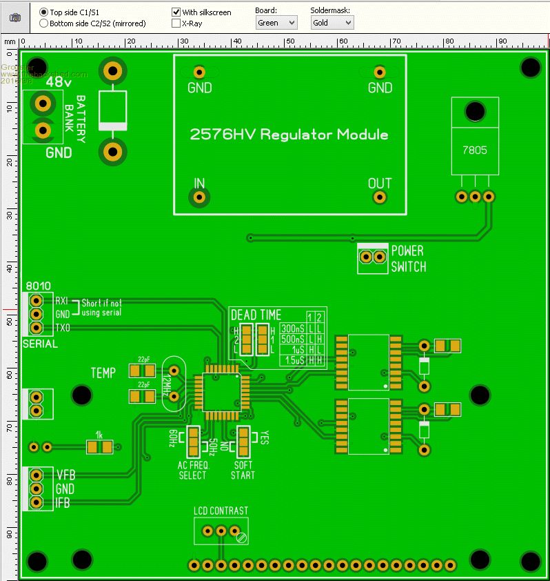

This is still a work in progress and is not finished, but it is on a 100x100 PCB, which are cheap as chips to have made. The current and voltage feedback are on another board:
This controller board design has the ST7920 LCD module mounted on the front-facing side, so the board will display the vitals of the inverter without needing additional external voltage and current sense boards or modules:
I am using the IFB input as-is now, but if this is a potential source of problems, it would be nice to be able to design this transistor buffer into the PCB layout if it works.
I can design the layout to accomodate it, and have some solder-blob pads to bypass it I suppose, but it would be nice to incorporate an improvement in the design if you guys have come up with one.

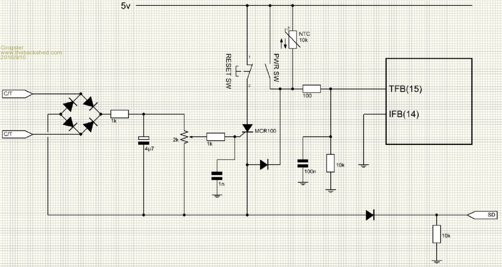

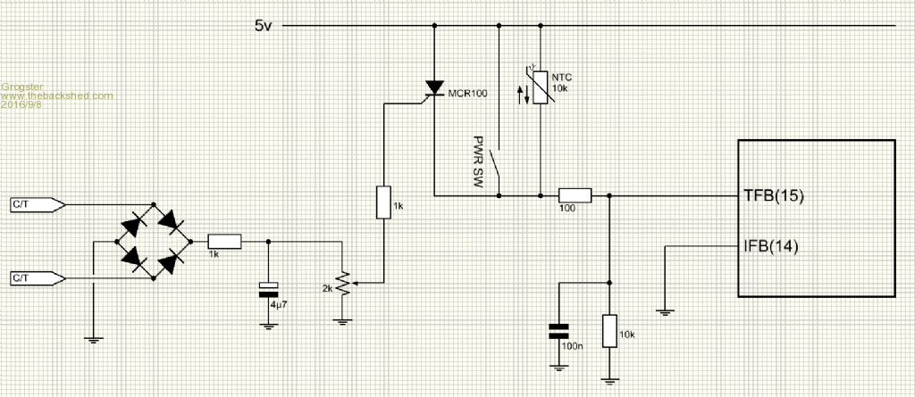

This is how I see Oz's SCR idea:
As per the 8010 manual page 13, if we ground IFB pin-14, then that disables that aspect of the 8010 controller chip, and then you would just use the SCR across the power switch and NTC temperature sensor.
In an overload situation, the SCR gate voltage would rise above 0.62v or so(the gate trip threshold for an MCR100), which would fire the SCR, and pull TFB pin-15 high, which would immediately force the 8010 controller to think there was something seriously hot, and it would shut-down the inverter.
From what I can see, this is EXACTLY how you guys are actually turning your inverter design off and on anyway - the power switch just shorts out the NTC, and thus "Open is on" kind of thing.
IE: If the power switch is open, the inverter is on. If the power switch is closed, the inverter is off. I expect the LED is also blinking it's temperature alert sequence with the inverter off. I will probably have a master 48v supply line power switch to completely isolate the 48v from the circuit for my on/off.

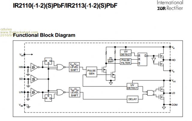

As I stated on another thread, it is to be seen if the temp pin is fast enough... ie how often is it polled... or is it an interrupt etc.
If too slow, then the inhibit of the driver 2110 can be driven via isolation diodes from the scr to the 8010 and 2110 simultaneously....

Posts: 10084
Posted: 11:56pm 09 Sep 2016
How about something like this:(copying from jdevine82's idea)
C/T floating supply triggers the gate of the SCR when it's gate voltage goes above about 0.62v(for the MCP100 SCR), which causes the SCR to turn on, which pulls both SD pins of the 2110 driver IC's high via a gating diode, which inhibits the drivers.
At the same time that happens, the TFB pin on the 8010 is pulled high via another gating diode, which stops it flat in it's tracks with what it thinks is an over-temp issue. The diode idea is Oz's, and I think I have that right in what he was thinking?
With the SCR now turned on, there will be a constant potential on BOTH leads of the C/T(via the bridge with the SCR on), but with no path to circuit ground, that won't matter I don't think(because no current can flow).
With the SCR in the off state, the 10k on the SD line pulls the SD lines of the 2110 driver IC's low to enable them in normal use. Do we need the 1n on the SCR gate?
To reset, you just press the reset button, which interrupts the 5v to the SCR, and it will "Reset", the voltage will vanish from the cathode of the SCR, and the NTC will allow the 8010 to restart, and the 10k pulldown on the 2110's SD lines will re-enable them.
Thoughts?

Posts: 10084
Posted: 12:48am 10 Sep 2016
Cool. I will run with this then, but waiting for Oz to chime in with his thoughts....
The datasheet for the 2110 driver IC's says that the SD pins will effect an inhibit of the drivers within 140ns maximum, which is just a tad faster then relay contacts take to open or close, it has to be said.
I cannot find any details on how long it takes for the SCR to conduct via the A-K path once the gate threshold voltage is reached, but if I find that out, I will post it.
The MCR100 datasheet does not specify the propagation time, only the gate threshold voltage. I might look for another datasheet for that device, but I expect they are probably all the same.

Yep, an scr, two diodes and a pull down resistor will do it ... looks like a plan.....now, who's jamming the screw driver in there to test this
But, if that does not shut it down fast enough and deliberately enough, I'm not sure what will.
The 2110 has a pull down internally I think, so maybe even no R required... ie SD does not require a connection if not used ( from looking at the internal schematic)... not sure of the value though... will have to find the sheet again.
...........oztules

I have the 2110 datasheet, so am looking at the same block diagram you posted above, but nowhere in the datasheet does it specify what those pulldown resistor values are.
I guess it would be easy enough to find out by measuring the resistance of that pin to ground of an uninstalled chip. I expect it would probably be in the area of 100k or so. Although, that is not a rock-solid test either, as any other current paths via the chips' internals to ground could affect that reading. It would have been nice if they had stated what that value was, but I could not find it anywhere in the datsheet.
