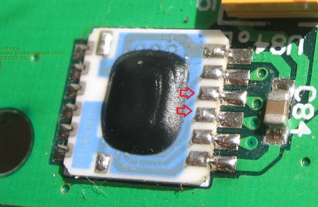

The barometric pressure sensor on my davis vantage pro2 has been playing up for years. it was always slow to come up to the correct reading after it had been powered down (like an hour) and then couple of years ago it stopped working when the indoor temperature rose above a certain point, then this year it stopped altogether.
I was looking at the graphs from last year thinking about it this morning and realised that when the temperature fell the sensor jumped straight back to the correct pressure. My reasoning from that was it was not loosing power so it must be the data line that was dry jointed.
I pulled it apart and found the chip traced the circuit and looked at all the solder joints on the data lines, searched for a datasheet (MS5534-CM) read 21 pages of stuff and decided it was safe to remelt TX pin3 and RX pin 4 with my dinky-ist soldering iron. It also has test point pads on the board for TX,RX and power but I have no scope
The sensor can be mounted facing up or down, this one has a hole in the wireless receiver board and it faces down, it has solder pads on both sides.
Apparently facing it down gives it a very low profile for fitting into scuba divers watches.
0.8mm is not the smallest pads on the board but I still couldn't see the solder on the pads without a camera on macro.
Anyway, I give them a jab with a clean tip (no solder or flux) and whadda ya know! it works!
instant pressure readout on the display.
