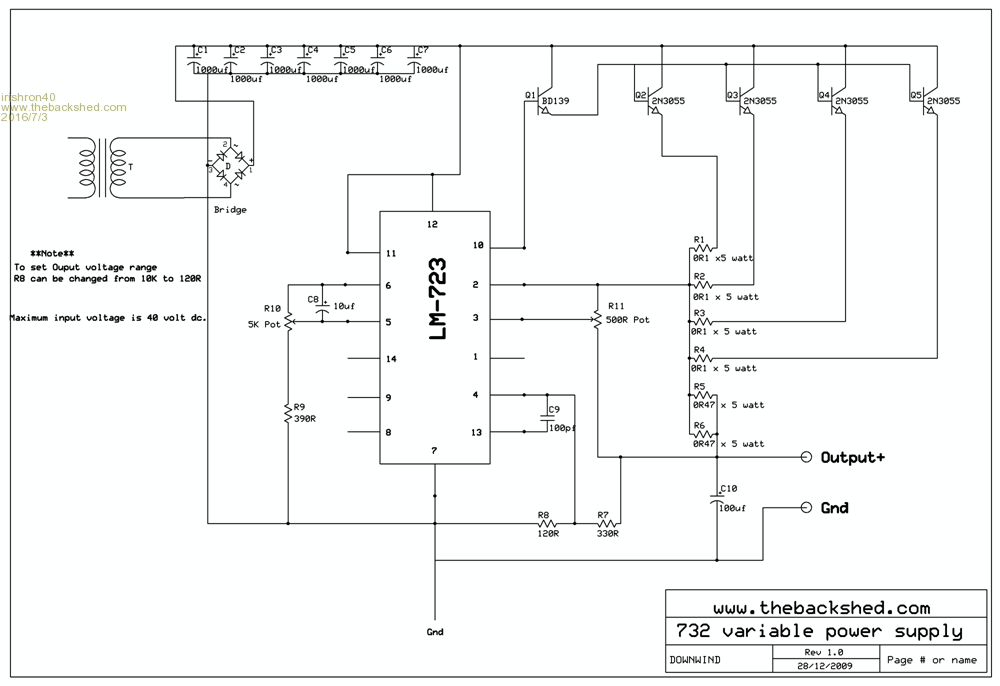

i just connected this yesterday. but the 330 ohm R7 restistor keeps burning out. I had no load connected and cant see an obvious fault . anyone any suggestions why that resistor could blow

Did it smoke straight away, or did it happen as you wound the voltage up? Possible cause is you have the junction end of the resistor connected to the wrong side of the R7/R8 junction. That would negate the voltage feedback to the regulator chip. As with any new build, check the important connections twice. Then check them again after a coffee. I've let lots of smoke out of things by not doing that

  Quote   the junction end of the resistor connected to the wrong side of the R7/R8 junction
Pete ,i dont get what you mean. it starts smoking the moment i turn on the power , without a load connected.
I double checked , or trebled checked. I seem to have it as the diagram.
thx ron
oztules
Joined: 26/07/2007
Posts: 1686
Posted: 11:12pm 03 Jul 2016
Hmmm. It is just a voltage divider....on max volts would draw 40/450=88ma.
I^2R means .088x.088x330=2.5watts dissipation in the worst circumstance... would toast a 1/4 watter.... the 120r would burn up some .9watts so would not cook as fast as the 330r
The pin 4 is high impedance , so the divider has only one voltage drain... Gnd...
To test this use a 1k2 and a 3k3 resistor for R7, R8.... and this will give you time to find out what else is going on and work exactly the same without the burn ups...current will drop at worst scenario ( 40v) to 8ma or .02 watts... 100 times less because of the square function in the watt equation of I^2 and R for 10 times bigger R
ie now you can measure your Voc, and if high.......do you have a shorted transistor or a mounting problem with the rotten 3055 packages somewhere, poor insulation on the transistors to body of heat sink etc etc.
Voltage of the r7,r8 junction with respect to ground, and see if it works as expected.... if you have no control, then you have a problem somewhere else, making your output unregulated for some reason... is pin 4 short to internally?
...........oztulesEdited by oztules 2016-07-05

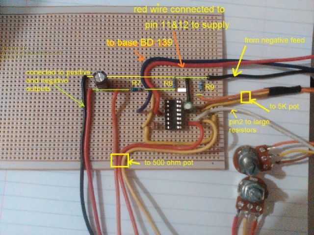

Posted: 04:45am 05 Jul 2016
Losing my patience here lol
I am after rebuilding it and have no shorts from veroboard.
when i connected it and put voltmeter on outputs it gave me from 2.5 to 24.8 volt
the moment i put on a load transistor no4 started smoking.
i then disconected that one and then No 3 started smoking.
Ic got also warm and resistor R7 burned out again.
I have no variable voltage ,just max voltage at 37volt
but when i disconect power to main transistors i do have 2,5 to 24.8
Edited by irishron40 2016-07-06

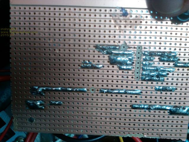

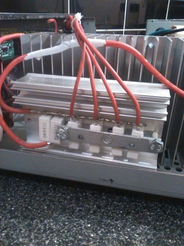

Posted: 02:28am 07 Jul 2016
I can not see what the problem is, i am unable to make any solution from your picture as it tells me nothing, maybe a matching photo of the bottom side of the strip board may help.
My gut feeling is you have a short to ground somewhere.
Do you realise that the heat sink is live to V+ supply voltage unless the transistors are isolated from it.
It would seem you have a short somewhere between the emitter pin of 1 or several of the 3055 transistors and ground, there is no way they should blow if the current is going through the ceramic resistors.
Are you 2000% sure you have the transistors wired the correct way around, Base Emitter, collector?
You should be able to do a test as i do with connecting the output leads together as a dead short and then wind the voltage up and it should current limit to the setting of the output current.
Your circuit is not doing that so you MUST have a construction error, Gismo and many others built the circuit and it worked, so it can only be a error in your circuit.
Pete.

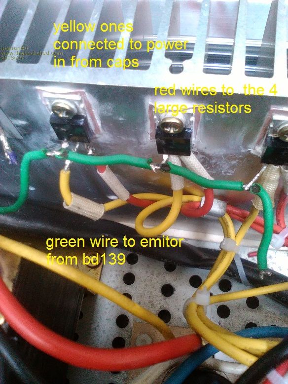

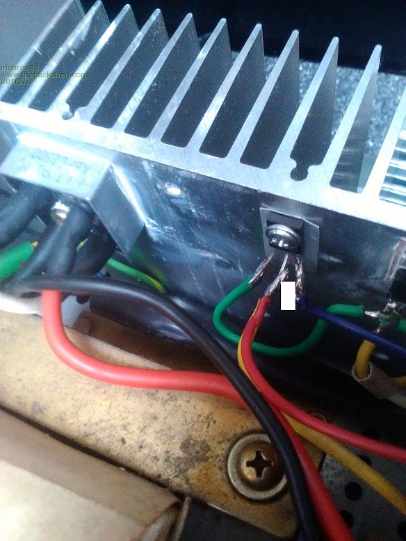

irishron40
Joined: 22/09/2014
Location: Ireland
Posts: 254
Posted: 05:39am 07 Jul 2016
thank you for your reply.
i have the bd139 connected 1 emiter 2 collecter 3 base
the transistors are isolated from heatsink and double checked it with tester
transistors i used are tip41c
pin 1 is base
pin 2 is collector
pin 3 is Emiter
emiter from bd139 i have connected to base from the tip transistors
collector from bd139 is connected to supply at the large capacitor
base from bd139 is conneted to pin 10
tip pin 1 to emiter bd 139
tip pin 2 to supply from capacitor
tip pin 3 emiters are all 4 connected separete to each of the 4 large resistors
I looking at it for 2 days and realy want it to work. I also tested all the circuits on the board, and there is no short shown
Thank you Pete
Edited by irishron40 2016-07-08
