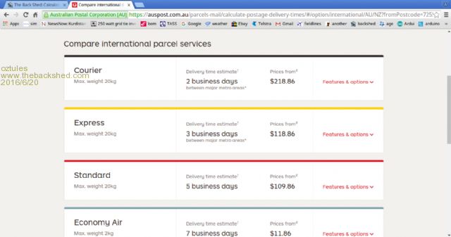

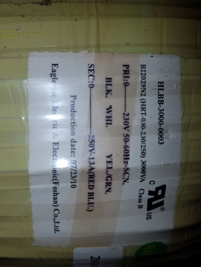

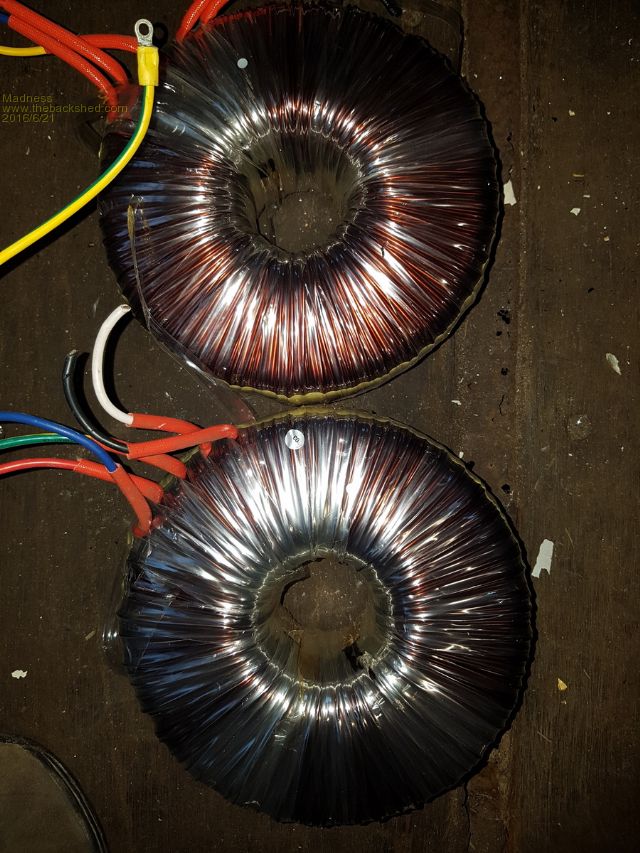

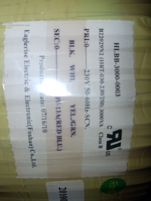

Grogster I should be able to get another Aero Sharp Inverter in the next few weeks. They are $65 AUD each plus $120 for post and a bit for packing. So for about $200 AUD you get a tranny. Maybe Oz has a better solution but this is way cheaper than getting one wound, might cost you a couple beers if I ever visit NZ too.
Jeez OZ you where up late.Edited by Madness 2016-06-21

.. no he gets a much better tranny than he was proposing.... for about 1/3 the cost.
I was hoping you would chime in Mad.
Grog, a standard one will just need the outer( primary 260v) winding removed to have the same thing as you were getting for $600.... then add your own primary of around 22-23 turns.
For the duty you talk about, 25mmsq will probably do fine, so fits very easily, and will still so 2-3kw cont, and 10kw excursions to start things up, or cover for electric jug or toaster etc for small duty cycles of less then 10 mins at a time on top of the house usage.

I know Toll do an international parcel and courier service to NZ (parcels up to 300kg) they do an express and economy version.
if they do a competitive price it could be better to send the inverters complete. I think the weight is calculated from the dimensions of the parcels for their pricing.
most of my freight is delivered by Toll or Toll IPEC.
