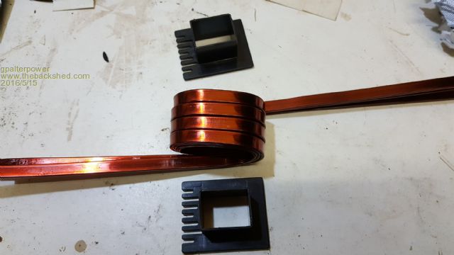

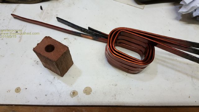

I procured some 8 x 2 mm enameled copper strip and made a former from timber. 3 layers of this will give me 48mm/sq . Needless to say it turned out a bit of a dud as the corners were too tight and didnt quite fit the former!
Change of stragedy and a new former with rounder ends was far better. The first attempt being with the larger (left) end which turned out to be far too loose, so unraveling the copper and having another go on the smaller end worked out much better and a neater fit.

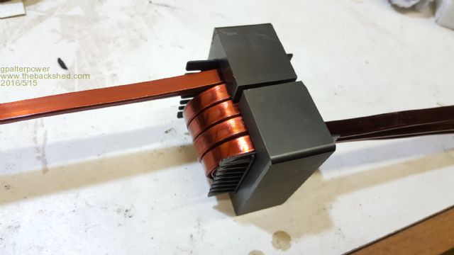

I had to cut the former so I could fit the wound copper. I found I could fit 4 1/2 turns on the former. ONE more turn than I expected. Is 3 1/2 turns an empirical design or is and extra turn a good thing?
It fits neatly into the E core .

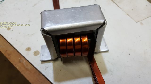

And made an ally case to hold things in place

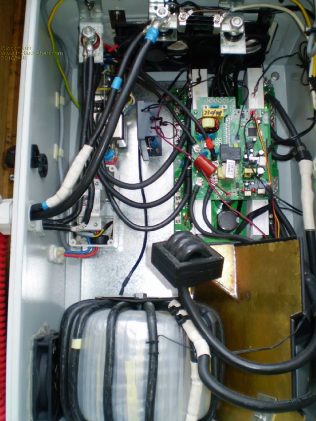

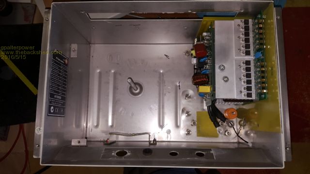

Next was the case where I placed the main and control board on their side and toward the top. I am planning on placing the fan on the outside above the main board thus drawing air up and thru the heat sinks as a wind tunnel effect. Im hoping this will cool things efficiently.

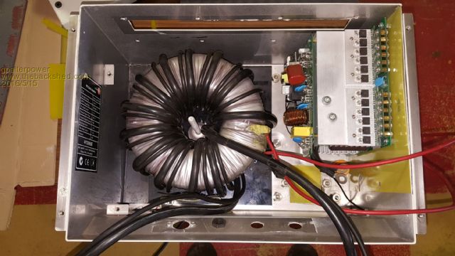

I placed a mat on the back of the case and allowed the toroid to sit flat on to that.
Things sure are getting crowded in there! Not 100% sure on battery connections where pos and neg battery attach, but Im gravitating towards the 2 black leads are NEG and larger heat sink is POS. Primary connections to the toroid via circuit breaker and choke are the 2 smaller heat sinks. Does that sound right?

Nice to see that someone at last had the courage to copy what I wrote in "tinkers inverter project" with regard to winding these ferrite chokes.
Now you are possibly kicking yourself when you read my latest on ferrite chokes in "building an inverter from scratch".

Would not that juicy 8x2 enamelled copper strip not make for an excellent primary for the toroid too, over using thick sheathed cable? Exposed copper strip like that would be able to dissipate heat better for when the inverter is pushed hard.
Again, I may well be missing something....
Posted: 12:26am 15 May 2016
  Grogster said   Would not that juicy 8x2 enamelled copper strip not make for an excellent primary for the toroid too, over using thick sheathed cable? Exposed copper strip like that would be able to dissipate heat better for when the inverter is pushed hard.
Of course it does. But more for the reason one can fit a much larger copper cross section for the same # of turns through a given size toroid hole. Perhaps you have not yet read "tinkers inverter project" which I posted here late last year.

Posted: 10:35am 15 May 2016

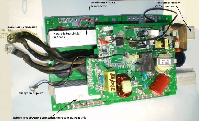

Yes..... The 3 pairs of cables from the Power Board base are Negative battery connections.
The two split heatsinks are the Toroid Prinary connections.
The big heat sink is the Positive battery connection.
Like.......
The toroid secondary connections go to the PJ control board.
On our new boards we have got rid of the secondary cables, we use a sense coil for current and a 230vac light cable feed for the ac voltage regulation. Edited by Clockmanfr 2016-05-16

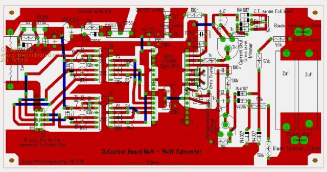

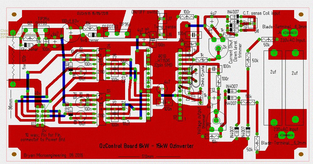

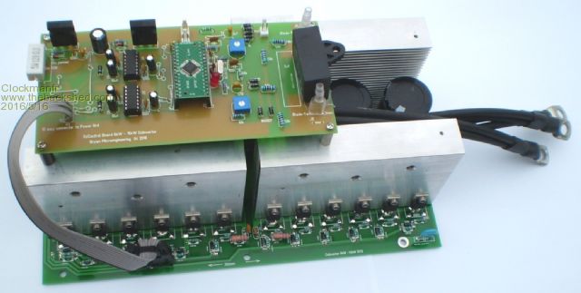

The New Boards.
I supply all the real size Etching masks with the book, so the PCB's can be made at home.
The OzControl board is single sided, but I now have a double sided on its way, which is shorter in length.
The whole unit I suppose could replace a PJ as a swap in.
This New 6-15kW Power Board has many improvements.
'Why re-invent the wheel'..... I like the Boards overall unit, as its a strong structure when all assembled, easy to maintain and get at things, and yet easily kept cool when mounted Vertically.
I use the OzCooling circuit, is just right

Hopefully very soon 'oztules' will be testing the new boards, sent some to him, once I am happy things are okay, then I will set up a link for the book, and contact all these Forum Moderators.
Here is my latest MK6 OzControl Board, its simple, for folk like me, and its double sided, but the Blue tracks can be replaced with jumpers/0r/links, then its single sided for DIY at home etch

Hmm, Image is not very clear.
Edited by Clockmanfr 2016-05-20
Posted: 09:46pm 18 May 2016
GIF is best for this sort of thing.
