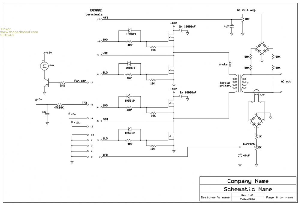

Oztules and others have done all the pioneering work about how to build a really good pure sine wave inverter using the EGS002 inverter driver board.
I decided to build one too and have ordered that EGS002 board.
But I do not want to copy oztules PCB (I don't have that program anyway), I rather do my own layout. And I can see a few not so good features with the PJ style power board so I do not want to copy that either.
But circuits for a complete inverter with the above driver board seem to be non existent in a simple form. I found lots of relevant info on that Otherpower site and from that I have drawn up this circuit:
Now, I'm sure there is something I have overlooked so I like to ask if those who know more about inverters than I do would check this circuit for me. I am aware that I only drew one mosfet per leg, in reality there would be up to six. I did not want to clutter up my drawing like some that I have seen.

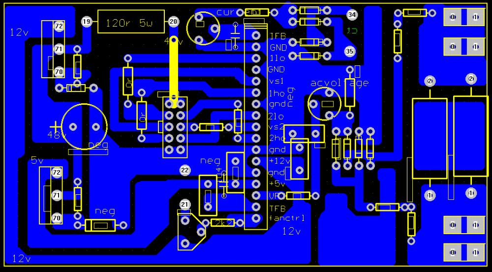

Posted: 12:55pm 09 Apr 2016
Nice to see this turn up here......
I was going to do a full how to, but may not have to now.
Yes that circuit will ( for all it's simplicity ) do a perfectly good job.. every bit as good as the PJ, and anything else running around the world. Provides solid power, usually less than 1 volt drift (0-5kw), and clean sine wave.... but to do that you still need the 2uf across the AC out.
Further filtering for those who like clean airwaves ( Ham radio guys) is necesary, but your inspire innards can contribute that.
I would go one further and just use three chips and the fets, and this works equally as well, and no 002 boards required..... feels more like you own it... mine plug in so if the worst happens, I just unplug 3 chips, and replace, and were away too.
I admit the 002 board is every bit as simple, and has anti cross over protection.
The suffix clockman refers to is for uvlo. It does not exist in the HT1533 chips I bought, but does in the HT1536 ones... I cold not et mine to uvlo... and wondered why.
I think the PJ power board could be better, too, but in reality, it is hard to beat it, so a simple rework is all that may be required... I have thought long and hard at all the different styles I cold use for the H bridge..... but I keep comng back to that general layout, or a planer version... ie flat heat sin style.... but still the elegant way of using the heat sinks for solid connections is hard to pass up.... so I will stick to the PJ style..
My latest one is this one.......well it was to be but the upload does not take .png

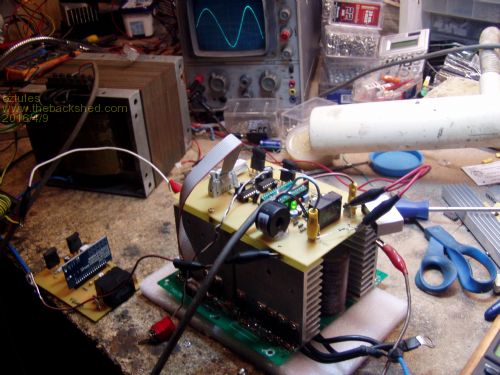

ok I persevered and did the jpg conversion so here it is now
Note the there is only three chips, all plug in.
The 8010 can be replaced by the folks on the mite board.... they are smarter than me, but a i figure a jump table and scaling is really all that is required to make a useful chip.... but at $1.50 and less per 8010... I just could not justify the programming on even a nano... I cant get a burnable chip for that kind of money.
This route is a close to home brew as you can get without programming a chip yourself.

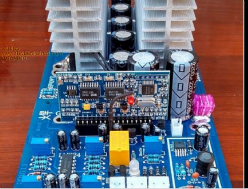

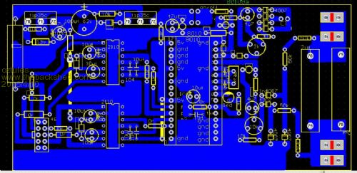

I think this is the last version of the ESG002 pcb for comparison.
what does VS1 and VS2 do? are they sensing the crossover point? there are no components just wondering if it is important that they have similar paths.

VS1 and VS2 are simply the floating "source" points for the 1Ho and 2Ho gate drives ... ie gate voltage reference point/s.
The charge pump pushes the voltage beyond b+ to drive the gates of the high switches, and this is the gate reference at the source of those high side fets... ie when the fet turns on, there is no potential between drain and source, so source will be at b+ when turned on... so we need higher voltage to hold the gate on.
The low sides use ground for this reference.
I believe normal analogue practice is not required here, and ground loops are acceptable... you want 1's and 0's @ 12v.....so noise on the line is of no interest.... within reason.... so earth points everywhere are best.
Yes that is the last version I think... works perfectly well, but I have swapped to 8010 alone now.

the only thing I can see Tinker is your +12v and +5v supply to pin 14 and 12 is not in your circuit. Where are they sourced?
It is no good me looking at the component values, I am hopeless without a reference to prompt me.
Posted: 12:55am 10 Apr 2016
  yahoo2 said   the only thing I can see Tinker is your +12v and +5v supply to pin 14 and 12 is not in your circuit. Where are they sourced?
Yes, the sources are not shown deliberately for drawing clarity reasons. I will use one of these e-bay buck converters from 48V nom. battery voltage to 12V to drive the fan(s). And then a 7805 or similar to get 5V from the 12V, like oztules did.
Yes, no output capacitors or other suppression parts are drawn either for the above reason. I plan to insert them where they are most effective later, after all this will be a prototype board.
When I finished drawing it up it looked too simple so I thought better ask here...
Thanks folks, your input is much appreciated.

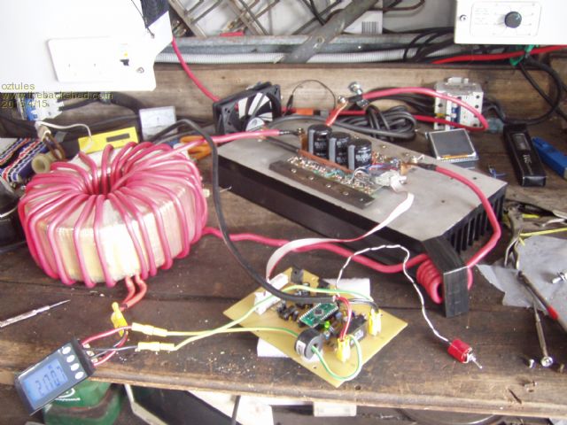

You mean like this one I did yesterday Tinker?
Yes Grogster... add tranny and batts and box.... should make a very useful little unit.
You may still need to render the 393 inoperable for torroid use..... they don't tolerate spurious pulse waves from the current shutdown system they employ.

Nah Oztules, mine looks nothing like your idea above .
Give me a day or two and I'll post pictures of it assembled but without some of the parts I'm still waiting for.
I would imagine there are many ways to do what I mentioned earlier.
I see that you now have 5 turns around that ferrite choke, did you notice a worthwhile improvement from the 3 turn version (with obviously thicker wire)?
Also, where does that ON switch connect to? Just applying +5V to the temp sense input to activate it?

yes, I use the temp sense on that board for shut down, and the temp probe can be paralleled anyway, so you don't loose function either.
The inhibit works fine too, just didn't incorporate it into the board because of the blow ups originally..... gun shy. But later tested it, and it does not cause the torroid to throw up.
The 5 turns was because I had under sized wire, so it fitted.... it does help a little, three works fine, 5 works a little better, but not enough to chase unnecessarily. If I had the ecores in abundance, then I would use three turns around two formers....
Yes the transformer is the difference between a solid performer and a wannabe.....
"ye shall know them by their weight"
