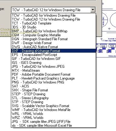

Hi.
I have been doing the OzInverter New 6kW-15kW Power Board.
For my use and individual masks for this large A4 size board, I have CAD software TCW Pro14, it does the boards and the separate layer masks, no probs.
Now it seems that to get these Power Boards made, (seems other folk would like them ready made), at PCB manufactures ShenZhen2u or other PCB folk.
They request RS-274X gerber files.
Here below is what my CAD files can be exported as......
I see that there is reasonable cost software on the market that can do conversions, like GerberView etc, but I am not sure it this software will work.?
My PDF files of the layers/masks comes out real nice, and at real size.
I really do not want to spend monies on PCB software and start again.
Any help or advice would be appreaciated.
Thanks.
