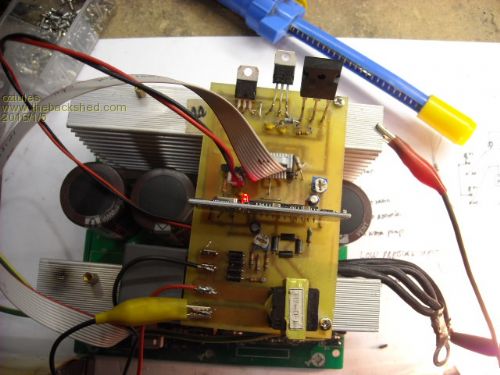

The test board looks like this.. a simple dual voltage output stage to keep the volts to 12v and 5v for the EGS002, with a transistor for the main step down voltage stage.
The card, a CT etc.

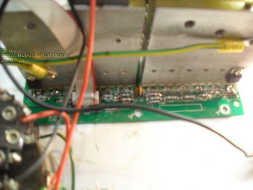

I made a quick h bridge to use for the initial test, but designed the control card to interface with the PJ power board.. it has the caps and heat sinks already.
The down and dirty H bridge is this: ( your allowed to laugh)
Once that found out a few flaws ( voltage regulator went west for no apparent reason ) we then plugged it into the PJ board.

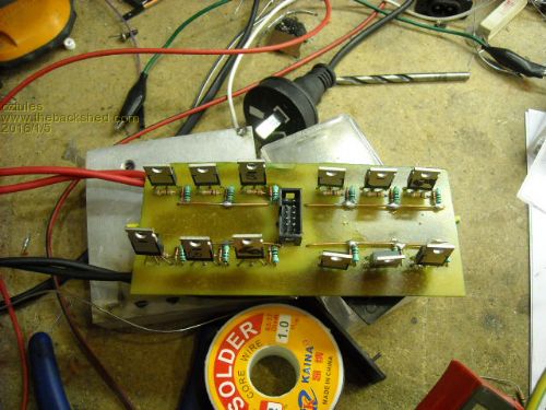

The PJ had only 1 mosfet per leg... now there's confidence ( less to replace ) like so:

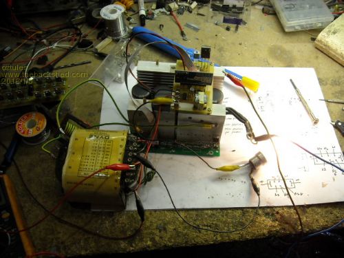

The fired it up, with a 40w load.. it was the only filament thing in the place....so it was pressed into service...
Well it worked..
The voltage control went from 68acv to over 260vac. Transformer was 32:240v.
The temp probe was heated up, and the unit stopped, restarted 8 seconds or so later, the current transformer will have to wait until I have it connected to the battery bank, and a big transformer attached.
Suffice to say I was pleased to see it running at all.. didn't expect it to be so easy I must admit.
Fets stayed cold ( touching the front of them, there was no heat...... so....

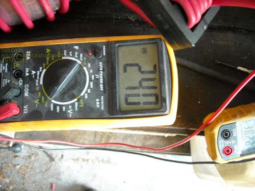

Put 2x 560r 20w ceramic resistors as well as the load.
Unit started smoothly, constant frequency, and soft start voltage... straight to the 240v mark.... nice so far.
Ran for a few minutes, until the load resistors started to smoke....checked the fets, and with 240 watts, the temp was barely warm on the front of the fets... so I guess that 600 or more watts on a single h bridge is well within reach... but my 56v power supply was topped out at 300w... so that will have to wait until I get it all better resourced.

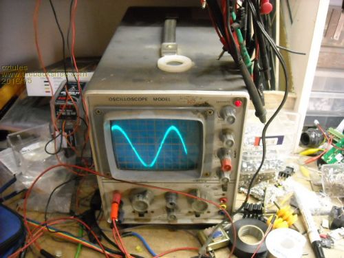

The wave looks like this:
It didn't change even as I dropped the load on off on off etc.... until I got tired of trying to fool it.
I am hoping that this translates into the high power phase as well, we'll see.

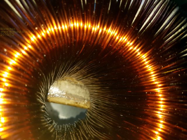

Wound a small 3kw torroid.
put in another fet in the h bridge legs.
we ended up with this little beauty.

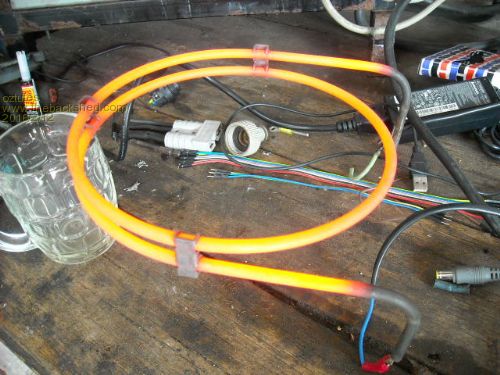

Thats an oven element with about 2100watts.
The heat sinks stayed pretty cool over the 10 min test.
voltage was stable... very stable.

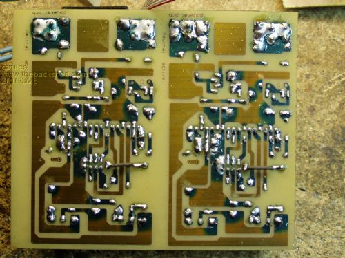

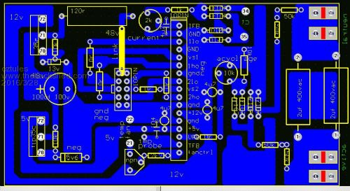

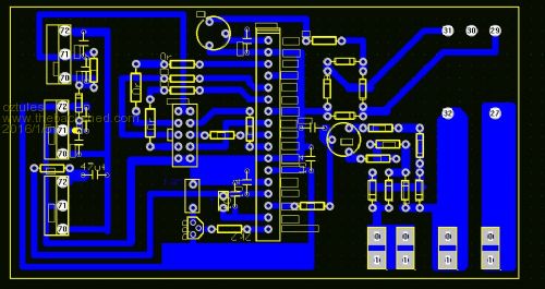

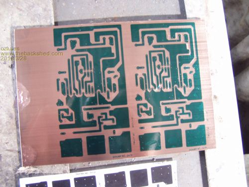

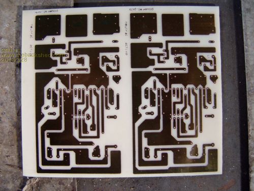

Pic of todays paper print out for the board etch
Then the copper with pattern from the kinston
Then the boards ( twin )
and the back
and the pcb in the program
Worked first up... always good.
Simply amazed at the simplicity of these things, and the sheer power you can call up if you have the fets and transformer to suit.... very solid so far after week or more running the house. Two hrs a day at at lest 2.5kw, surges of over 7kw ( seen 9kw too).
How they can be so simple and work so well I don't know.
Next step is only the 8010 and board to suit.
BOM from the program may help

Hope this helps someone

oztules
Joined: 26/07/2007
Posts: 1686
Posted: 12:03am 28 Mar 2016
And now to try the pdf???.... no did not work.. so try here:
http://www.anotherpower.com/board/index.php/topic,1116.msg11541.html#msg11541

mason
Joined: 07/11/2015
Posts: 86
Posted: 04:16am 28 Mar 2016
No Prob Oztules,

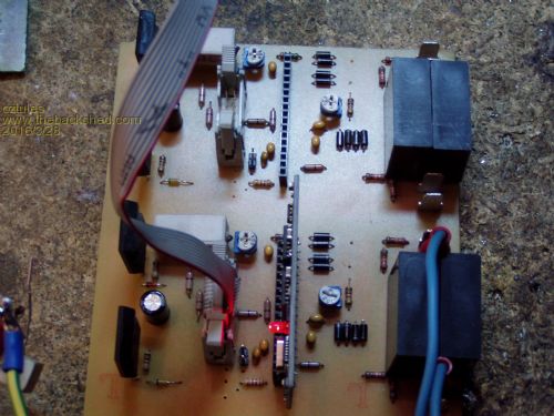

Question for you, the two blue wires are they coming from your toroid transformer?
Mason

Yes, they provide a 240v sample for the cpu to determine the amplitude of the wave form. There are two pins for the current transformer torroid that are not being used in this bench test, as need a kw or two to trigger the lowest setting with this circuit... easily changeable to lower if needed.... seen it at 9kw too.
48v comes from the fet card. Pinout for the 10 pin plug goes directly into a PJ card....but MUST change the gate resistors from 50ohm to 5r6 and use reverse diode , or the fets will heat up wickedly.
With that change, then the fets stay very cool for 0-500w, warm up to 2kw, but really needs my fan circuit, or in this case, a 12v fan running at 5v silent and slow, and then runs at 25c-30c even at 3kw and more continuous ( 2hrs etc).
If your transformer is torroid... the MUST REMOVE the LM393 from the 002, short pins 7 to 8, and then short pins 1 to 4....
Failure to do so will blow the fets to hell and back whenever the current sense is activated. A big EI will survive, but a big torroid will blow it all up if you leave the 393 there.

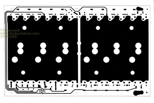

I will see if this works here...?
The New 6kw-15kW Power Board that will match the New 8010 OzControl Board....
