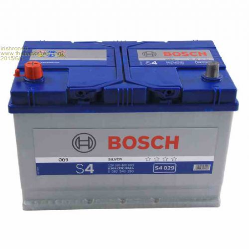

I am running all my led garden lights on a car battery.
load is drawing 1.87 amp
My battery is 3 months old and is a bosh S4 029 95a/h
It gets fully topped of my solar panel every day;(160W 12V Photovoltaic Solar Panel 160Watt 12Volt Monocrystalline Solar Module)
I know a full battery is about 12.6 volts.
but is it normal after about 2 hours that my voltage has dropped to about 11.9 volts while lights remain on? and after 3 hours its down to 12.8volt
when i switch lights off its goes back up to about 12-12.1 volts? considering i only draw 4 a/h?
my understanding is that I should be able to run 4 amps for about 27 hours on a 110 a/h battery
also wonder if that panel is to big to charge this battery
thanks.

Hopefully you have a solar controller between the panel and your battery.
Discharging a 110A/H battery at the c/20 rate (ie about 5A) you should get the full 100A/H out (of a new battery).
  Quote  after 3 hours its down to 12.8volt
Do you mean 11.8Volts?
  Quote  when i switch lights off its goes back up to about 12-12.1 volts?
You need to wait a considerable length of time. I have read like 6 hours resting (no charging or discharging) for the battery to settle to a useful voltage reading.
Also, is your load a constant 1.87Amps or is the waveform more of a pulse of much higher current?

Sorry for caps glenn. but my main question was. is it normal that my 95a/h battery shows 11.9 when lights are on for 3 hours and only draw 1.87 amps
when i then switch of the lights it goes back to 12.1.
but i am suppriced that 1.87 amp for 3 hours make the batter drop that much
i know solar panels can make over 20 volt, but how does controller deal with that. my understaning is that it keeps feeding battery 20 volt untill batter is full. isnt that too much voltage for charging?
should that sound right to you?
thx
ronEdited by irishron40 2015-06-02
Posted: 01:35pm 01 Jun 2015
1.87 amps for 3 hours drop to 11.9, I would think thats OK, but would need to do the maths, someone else may know better.
Next time your solar panel is charging your battery, measure its voltage. You'll find the battery, while its charging, is pulling the solar panel voltage down closer to 13 volts. The battery acts like a load while its charging. Once charged, its voltage will go up, and this is where the charge controller cuts in and disconnects the solar panel.

What type of battery?
Although it is going to waste one of your cycle life of the battery you could calculate the value and wattage of a resistor to draw C/20, fully charge the battery and do a discharge test down to the (resting) voltage quoted by the manufacturer.

Sorry, by type I meant flooded or SLA. I see it is a SLA. Beware that these batteries do not like being over-charged. Your solar controller should take care of this.
  Quote  i check amperage later without solar and charge controller
Don't connect the battery directly to the PV panel.
To see the actual waveform you would need a current shunt and an oscilloscope.
