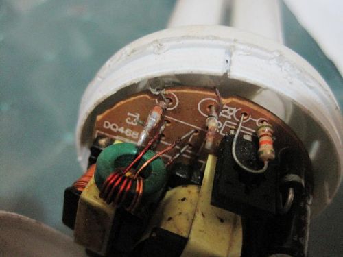

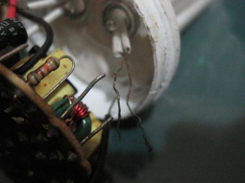

I eased the “did not come on” units apart to find the STEEL wires from the tubes were wire wrapped to the circuit board.
Through the small gap,I put a drop of bakers on them and soldered it up.
All the units came to life, BUT alas over time some returned to not coming on and some blew up.

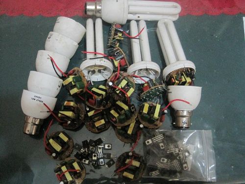

So I got another 20 and 10 X 12 volt ones too.
I immediately soldered them up and same thing, some worked, some blew up.
I bought in new transistors, fitting them, same thing, some work, some immediately blow up. Like I mean the transistors literally explode.
I started testing the transistors and fitting them in pairs. No better luck.

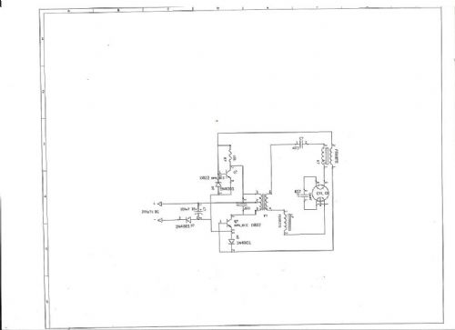

The circuit is so simple.
The diodes all test fine.
The caps all test fine.
The chokes and transformers all test the same uH.
The D822 transistors are rated to 30 volts so I have made dam sure no one turns them on during the day when the solar panels have the battery voltage up. Drastic, but I was removing them from the light fittings every morning.

I did go through 3 12v CFL's from Jaycar a few years ago. They worked for a few months, but eventually gave up. Problem was usually over heating causing dry joints around the transistors, or the fluro tube was just overdriven to the point of failure.

Just a suggestion on your circuit of the light inverter, you could try a bridge rectifier on the inpot and that will make the circuit not polarity sensitive and also give a bit extra voltage drop into the circuit and a series resistor as well to drop the voltage a bit more as it looks to me that it could overvoltage things fairly easily.
