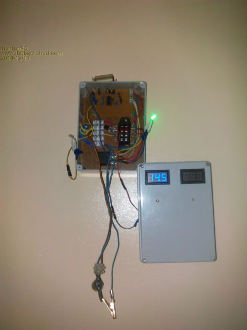

I just finished this charge controller, and would like the voltmeter and amp meter for turbine to match the one I allready have to check battery voltage
regards
