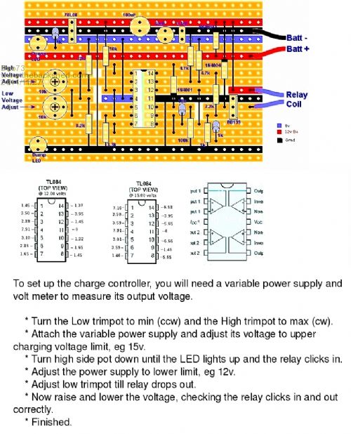

Maybe this pic will help and do a forum search there is a lot of info on it back a ways.

To set up the charge controller, you will need a variable power supply and volt meter to measure its output voltage.
Some photos of the board top and bottom may help also.

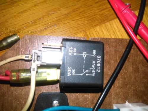

This is my relay.

Could someone confirm which pins should be connected to positive turbine(+) and which onbto battery , dumpload and switch wires from veroboard? Thanks.
Posted: 01:12pm 29 Nov 2014
Pins 85 and 86 go to the relay output of the veroboard, doesn't matter which way round you connect them.
With your variable power supply, you will hear the relay click in and out as you adjust your supply voltage up and down. The you can worry about connecting up the relay contacts.
Pin 87a goes to the battery +
Pin 87 goes to the dump load
Pin 30 goes to the windmill output.

Thats working Glenn.the only thing I figured is that the positive wire from vero board has to be connected to pin 30 also. I only have one confusion.when I connect variable supply to battery, and I set it below 12 volts the relay rattles.so if there is no wind power supply and my battery power goes below low setting it rattles. Why would that be?
