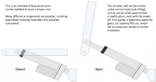

A crusty old linear actuator would do the job. say a 100mm stroke with non adjustable limit switches in the gearbox. they are slow but have plenty of torque.

Thanks for that. My original idea was to use a linear actuator ... until I saw the prices.
Also, I hadn't even considered whether or not a linear actuator could "back-drive" or even hold something in position with the power off :(
