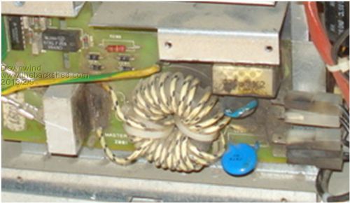

Hi,all members this forum.
In this weekends I bought in the ,,FLEAT MARKET,,one Keamppi 1500 master.EXCLUSIVE ACCESORIES
The seller said ,,IT is faulty but sure can be repaired,,
For repair i need some advice and schematic diagram.
The real pictures it is

Sure the first time i want disassemble piece by piece and clean all item
but not have schematic for assemble again and test control .

It looks like a Chinese puzzle to sort out.
There apears to be some fault on the lower circuit board, but that might be just how the photo looks.

Looks like it got a boot full of over voltage running on a poorly loaded generator.
That burnt stuff all looks like MOVs & filters on the mains AC supply.
Unless its just filth.

Ok ,friends i try next day to clean then I will return with new pictures.
Thx for quick replay
However without scheme I will not deal with the position all PCB-S
BEST REGARDES
