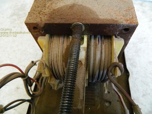

I have one of those Australian made Goodwell 140 amp stick welders, bought it new about forty years ago.
They must have made millions of these, and they are more or less readily available secondhand in full working condition for typically fifty to a hundred dollars from Gray's and E-bay.
http://res0.graysonline.com/handlers/imagehandlerxt=l&id=620 1337&s=n&index=0&ts=634364449592630000
The magnetic core and primary winding will supply 3Kw continuously, that is 240 volts/13 mains amps. It will run hot, but not dangerously so.
The primary has exactly 240 turns.
You can force 5Kw load for intermittent duty such as welding, but it will handle 3Kw all day continuously loaded.
You can use the sliding shunt magnetic gap to limit the current, but that has a bad effect on the output voltage regulation. The shunt gap also buzzes annoyingly, removing it produces a silent transformer.
If you remove the shunt magnetic gap completely, then you will have a very low cost 3Kw transformer primary plus core that will produce 1 volt rms per turn on the secondary with excellent voltage regulation.
That translates to around 28 volts at a genuine 100+ continuous amps, not bad for fifty dollars.

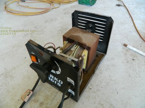

Posted: 10:45pm 01 Nov 2012
Thanks for the offer Bryan but I jumped in already and wound on a few extra coils. The wire in the secondary is 4mm diameter, about 12mm square, aluminium wire. I had some 1.2mm enameled copper wire, thats 1.1mm square. I made a bundle of 8 wires, any more and it would have got to tight in the transformer. 8 wires gives 8.8mm square, which is probably as good as 12mm alu wire, at a guess.
I could fit on 8 extra turns. Applied power and I was reading 52 volts AC. Thats it for tonight, tomorrow I'll test in on the battery bank and see how it goes.

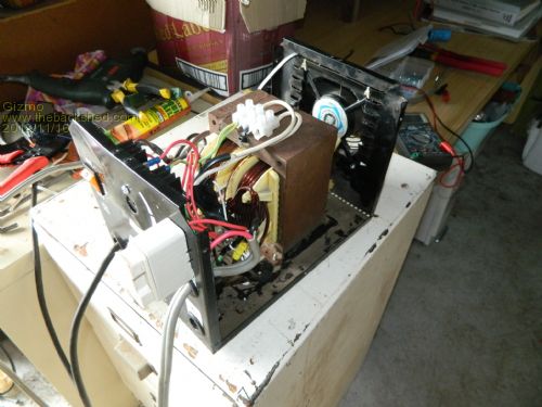

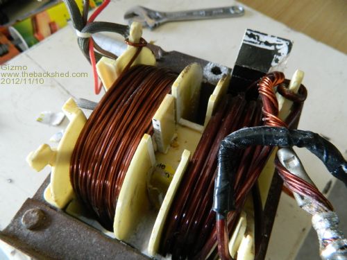

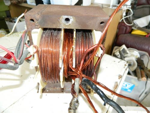

Posted: 06:29pm 09 Nov 2012
OK, tested the transformer with the extra turns and it was only good for about 500 watts at 50 volts. I needed to get more windings onto the secondary.
So I made the decision to dedicate this thing to being a charger only, not a welder. I removed the variable core mechanism and unwound the 8 turns from earlier. This gives me a lot of extra space in the core for winding in additional turns.
I glued in a piece of plastic to make sure the primary and secondary are well isolated from eachother, and some cardboard to the laminations to protect the coils. Then wound on 14 turns.
Put it all together. Added a fan to keep things cool, the bridge rectifiers, and a 30amp fuse.
Tested the output again, and it was supplying 1050 watts into the battery bank, which was already in a good state of charge, sitting at about 53 volts.
I would expect this to rise to 1200 or more watts for a discharged battery.
Now I feel I could get a lot more out of this transformer, I have space for more windings, but this will do for now. It is afterall just a backup to give a tired battery bank a bit of a boost while I'm heating the hot water tank.
