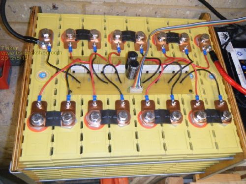

Recently a 200Ah LYP battery was added to my house battery bank. These batteries are unfortunately still about 2.5 times dearer than a bog standard LA deep cycle battery of similar Ah & voltage rating.
But the lithium battery offers a much longer service life provided a decent charge management system is in place.
For that requirement, overcharging is controlled by the MPPT controller that feeds the battery bank from the solar panels.
Over discharge is handled with a low voltage disconnect that cuts off the lithium bank from the rest of the battery bank once it drops to 24V. Unfortunately my inverters have a much lower cutout setting so the extra lithium protection was installed.
That leaves the task of cell balancing to ensure each of the 8 lithium cells (24V bank) are always kept at an equal charge potential.
Usually that is done with a shunt type bypass connected straight across each cell's terminals. While this works it seems to me there should be a smarter way of doing this - the shunt bypass only starts working once the cell has charged to its upper limit and then the shunt dissipates any additional charge as heat.
One ex forum member is developing a more clever way of LiPo cell balancing (see the EV section) but its not yet available for sale and I wanted one .
So I decided to come up with my own version, one that does all what apparently the "Relativities" unit was doing.
Balancing would ideally commence as soon as any charge current flows to the LiPo battery cells, in other words, not being dependent on their state of charge.
This sounds quite a task but I found a way of doing that which is remarkably easy.
So easy in fact that I wonder why apparently nobody else (as seen on a quick Google search) has thought of it.
I'll post a picture of it below, the keen observer amongst you should be able to figure out how it works, its that simple. No prizes for the right guess unfortunately but the nice feeling to know my secret .

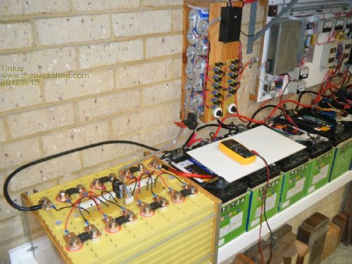

The next picture is the whole set up, the ribbon cable leads to a little black control box that's mounted on my super capacitor bank frame.
That's it. Further descriptions after I get a right guess.

A close up photo of components would help, as all i can see is 2 big electro caps and a nest of wire, what are the white things? caps, resistors, lego blocks, ....??

Yeah, it does look like a comparator (the little black spec in front of the white box) and relay combination (white box).
I'm guessing its similair to a ghurd controller for each battery, with state/control being handled via the relay or perhaps an optocoupler.

Congratulations Warpspeed , I'm glad I'm not the only smart cookie on this forum .
But your guess is lacking the correct detail so I'll explain:
The "little white boxes" are relays. They have 7A rated contacts (*must* be DPNO) and I'm using 24V coils for their much higher coil resistance.
The "comparators" are just NPN transistors to drive the relay coils. Sorry Downwind
The "electrolytics" are actually 100F super capacitors, I'm using 2 in series to get a 5.4V rating.
Sorry, no "mixed sequence" or random number generator in the black box, much simpler electronics used.
It contains, wait for it...
A clock (555) that outputs pulses with an 'on' time much longer than the 'off' time.
A sequencer, configurable in 4 steps (4 cell bank) 8 steps ( my bank) or 16 steps (for 48V systems). The sequencer drives the relays in sequence, only one relay at a time is turned 'ON' and then the sequence repeats.
A 8 step cycle takes about 20 seconds to repeat itself. That's easily changed by altering the clock timing capacitor.
A little reed relay with 2 zeners in series to its coil. This relay is powered by the solar panel output directly. It turns on when the panel voltage is greater than 28V, which is the level at which my MPPT starts putting out charging current.
The relay turns the power to the clock & sequencer on & off. Clock & sequencer off means the circuit goes to sleep for the night and wakes up once the batteries are accepting charge again.
The little black box runs on 12V, taken from the lithium bank.
It's been in use only for a short time and so far so good - no sign of busted relay contacts. The super caps were carefully pre charged to the cell voltage before connecting it all up.
Measuring each cell voltage at sunset today showed a difference of only 5mV between the highest & lowest. I doubt the relay contacts have a hard life if such small differences is what they see in service.
I can easily fit "a small resistance" in series with the relay coils but they may already have one in the form of the fusible wire jumpers I fitted to the board.
BTW, anybody planning to duplicate that contraption, the super caps *must* be the high current type, not the memory backup type. I got all my parts from Altronics.
Now you know what I was up to lately
