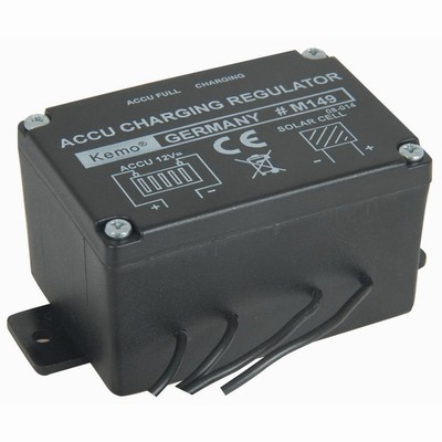

I wanted to make a system that uses wind and solar to charge a battery. I was hoping both could input to the battery at the same time.
Would this be able to have two sources into it?
Specifications:
* Input: 14 to 22V (open circuit voltage), nominal 12V
* Max. input current: 5A
* Inrush voltage: battery voltage < approx. 13.2V
* Interrupting voltage: battery voltage > approx. 13.9V
* Own power consumption: <3.9mA (LEDs on)
* Dimensions: 72 x 50 x 34mm
Would each source going into it need a diode (not sure what sort) that would stop them feeding back into the other source. IE the solar panels sending power to the wind generator?
I wanted to charge a battery or two for a camping fridge (unsure how much it draws) and 1-2 small led lights.

A battery only accepts charge when the external voltage is higher than the battery voltage. Or else the battery supplies current to whatever is "trying to charge it".
Yup, a series diode in each source will allow them to charge the battery when one or both source voltages are higher than the battery voltage.
General purpose silicon diodes rated say 100Volts PIV and 5Amps should be pretty easy to find.

If the controller is attached to the batteries can a pos and neg still come off the terminals and go to a 12v socket to accept the fridge and lights using a 12v twin socket?
Yes
Would this cause any problems if the battery is big enough?
Batteries and the charging system are "matched" for economical reasons. There is a balance between the size of the charging system, battery capacity and amount of power you want to draw from the system. You want enough storage to last you through the cloudy windless days and you want enough charging "power" to cope with those demands.
does that mean it can run off the battery above for more than 20hrs (it can supply 12amps over 20hrs)
No, it can only supply .6A for those 20 hours and your fridge uses .86A/hour, so it would be more like the "10hr rate". Also, remember that charging batteries and discharging them are NOT 100% efficient processes.
Regarding the controller being well over the rate of the batteries, will that open up the possibility over charging the battery or charging too quickly or causing a fire or cell problems in them.
No, the controller should terminate charge when the batteries are full. That charge controller is "over-sized" for the size of your batteries and charging system. But, it will be more useful as you increase your charging resource up to 5amps/hour and your battery capacity.
