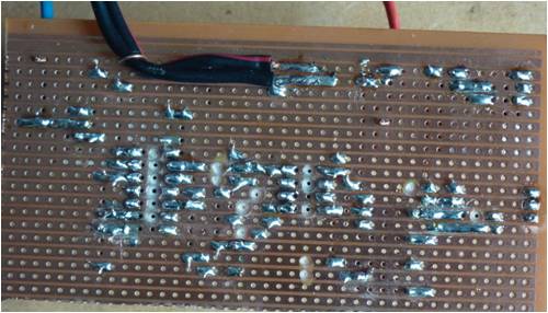

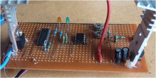

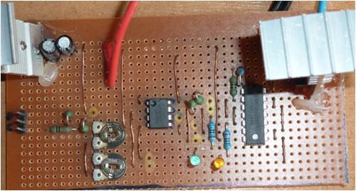

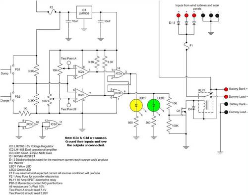

I have built a diy charge controller from the schematic attached and it will not charge the battery. I have it connected to a 12v supply and when I short the header (instead of adding buttons) to force it to charge it only turns the dump led off and not the mosfet and it doesn't turn the charge led on. The blue and red wires go to the relay and the other two go to the battery.

What voltages do you get on pins 4, 5 & 6 of IC3?
Do they change when pressing "buttons"?

pin 4 is at 0v all the time.
pin 5 is at 5.8 when there is no jumper and when the jumper is in charge position, it is at 1.95v when the jumper is in the dump position.
pin 6 is at 1.96v with no jumper 5.88 with the charge jumper and 0v with the dump dumper.

Well if you can get a low on both pin 5 & 6 at once pin 4 should go high.

After discovering I have a p channel irf9540 instead of the n channel irf540 i measured the voltages again and got 4.9v when the jumper was in the dump position, but the led still wont light and the mosfet doesn't turn the relay off/on. Would an irf840 work as I have heaps of them lying around. I know it's overkill but if it saves me spending another 8.50 then I'm happy.

Edit: I have the led going! There was a direct short to ground. The lower variable resistor had a little piece of solder between its top pin and the led track. The mosfet still won't switch which has me scratching my head as it should still switch I thought, just in reverse.Edited by terrapinlogo 2010-08-26

For testing you could manually connect the 10K resistor on the gate of the FET to the regulated supply. This should turn the FET on.
I can't read what voltage the regulator is. Do you know what the guaranteed turn-on voltage for IFR540 is?
5.8 volts should turn most FETs on, but check.

It's an 8v regulator.
As for the FET I have no clue what half the specs in the data sheet are but Vgs is +\- 20v and Vgs(th) is 2-4V. Is one of them the value I am looking for as they are the only two apart form the 500v Vds which is just the maximum voltage is it not?
Connecting the 10k on the irf9540 to the supply would turn it off as it is an p channel FET.

I dont see how you could expect to replace a N channel fet with a P channel fet and everything still work, without doing circuit changes to suit.
Use the right channel fet and things might work as they are ment to.
I see little purpose in asking why it wont work if you subsitute parts without knowing what you are replacing things with, or we dont know what is different than the schematic.
99.9% of the problems folkes have with building controllers and them not working is due to solder bridges, mainly with vero board as you have used.
The other problem has been wrong parts used.
It looks that you are lucky and have both these problems
Give the bottom of the board a scrub up with some metho and an old tooth brush to remove any resin and gunk, then let it dry and check the circuit for solder bridges.

I don't know about the irf540 but the irf510 takes 10 volts to turn on; so study the data sheets when making substitutions carefully.

Yes I know I cant substitute a p channel for an n channel. There is suppost to be an IRF540 on the board but I miss read the markings and put a IRF9540 in which is the p channel equivalent of the IRF540.
I have a big pile of IRF840 n channel mosfets which i want to know if they will work as that will save me buying an IRF540.

I just grabbed and IRF840 and stuck a 12volt 21 watt break lamp in as a load. It seems to saturate at about 6-7 volts.
Don't forget your only driving a relay. If its not that bigger relay why not just put in a small NPN transistor and remove the 100k to ground. An IRF 840 is like using a truck to carry a feather if your relay has a 100mA coil current Edited by Robb 2010-08-27

I have just clipped an IRF840 in with croc clips and it works. Just going to solder it in now and see if it works.

> Vgs(th) is 2-4V.
This is what you want.
> channel FET.
Correct, connecting the 10K to supply would keep it off as well as connecting it to ground. The gate would need to be negative w.r.t. ground to turn a P channel FET on.

It was going for about 5 mins but then I turned it off and on again and it doesnt work properly now. Something to do with the variable resistor connected to pin 5 of the comparator. You turn it to on end and you get 6.2-8v and the other and you get 0-2v depending on which end you start at. Those voltages cover 90% of the range depending on the end you start turning from. Which means I cant get the 5.95v required at pin 5 to set it up properly. It is probably a short somewhere bu I'll be damned if I can find it.
Damian
Edit: Fixed it. I had totally overlooked a track cut. Pin 5 of the comparator was shorted to pin 7 of the comparator and pin 6 of the nor gate. Hopefully this time it stays going.Edited by terrapinlogo 2010-08-28
